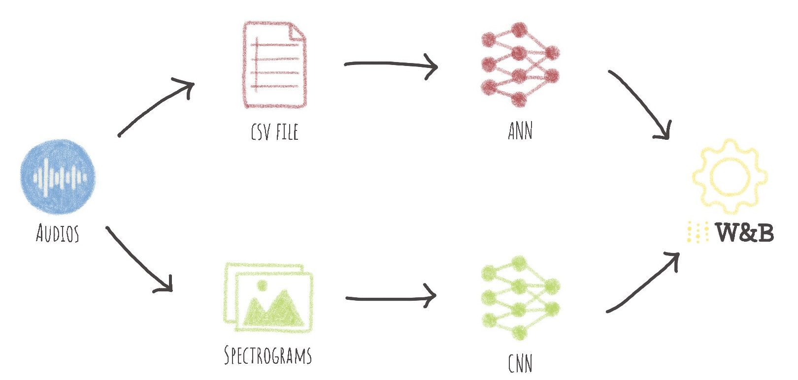

To build these sound classifiers, we will use two methods.
Audio classification based on audio feature
The first method involves creating an Artificial Intelligence (AI) model to classify audio files based on the different features of sounds.
To do this, some data processing is required upstream. Each sound will constitute a line of a csv file thanks to its transformation into 26 parameters calculated by Librosa.
An Artificial Neural Network (ANN) is then built and trained on 100 epochs. It takes the 26 parameters calculated by Librosa as input and returns a probability for each class as output.
Image classification based on spectrograms
The second method is to create an image classification model using the spectrograms of each sound.
The data must be processed beforehand. From each sound, a spectrogram (an image) is generated using the Python module Librosa. A Convolutional Neural Network (CNN) is then built and trained on 100 epochs.
It takes as input the spectrograms whose size is defined and returns as output a probability for each class.

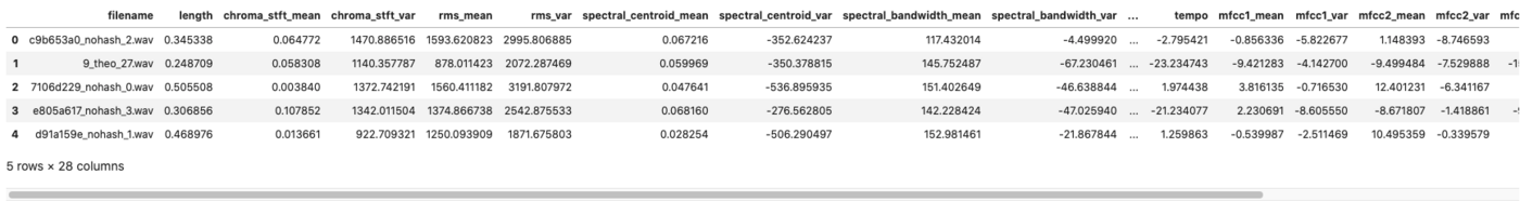

The head of the csv file:

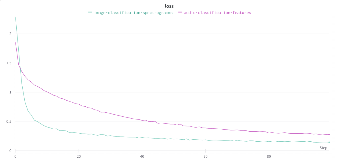

You can now compare your models with Weights & Biases.
Compare with Weights & Biases
You will be able to check your model's training once your jobs are in running status. Run the following command:
Once the jobs are in running status, you can check the logs to obtain the Weight & Biases link. Run the command:

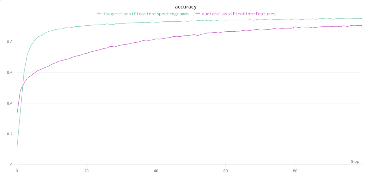

Now, you can access the Weights & Biases panel. You will be able to check the accuracy and the loss values for the training and the validation sets.
- Training data:
Accuracy:
Loss:

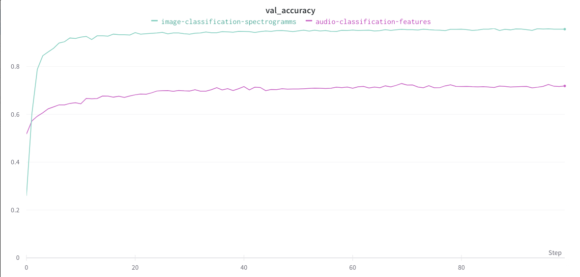

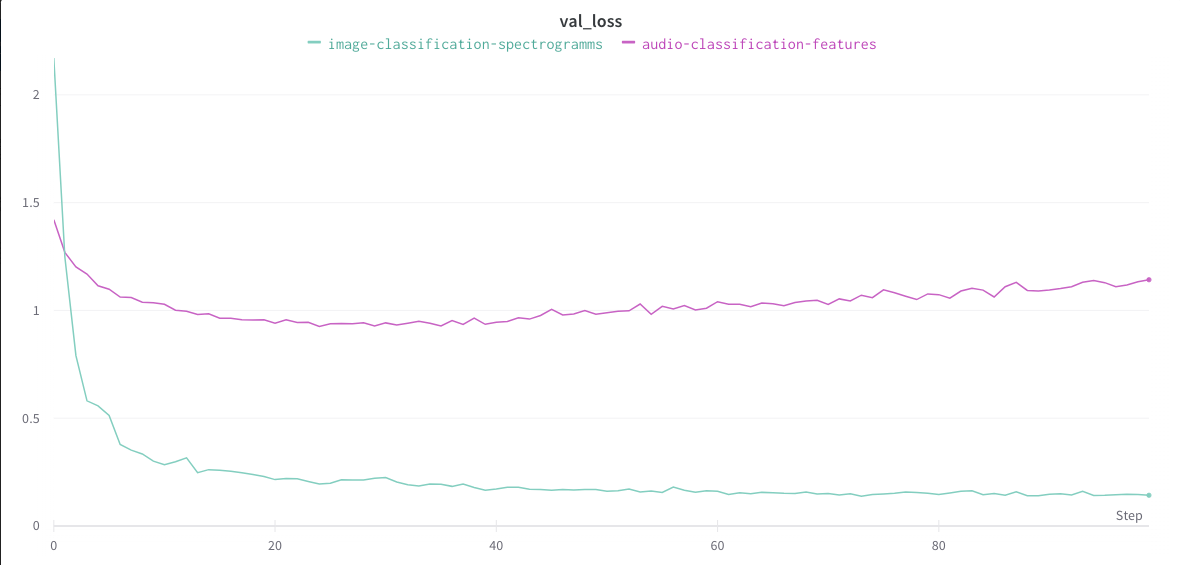

- Validation data:
Accuracy:
Loss:

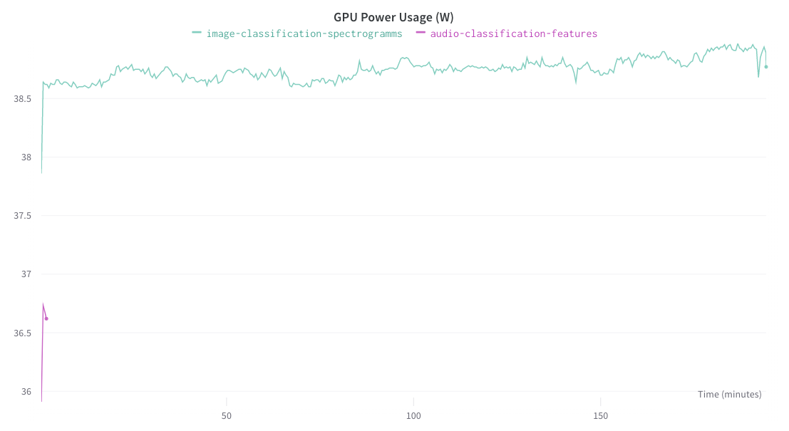

You can then observe which model is better in terms of speed, accuracy, or resource consumption...
In this case, we see that the model classifying the spectrograms is better in terms of accuracy and loss on the validation set.
However, it takes longer to train and consumes more computing resources.
