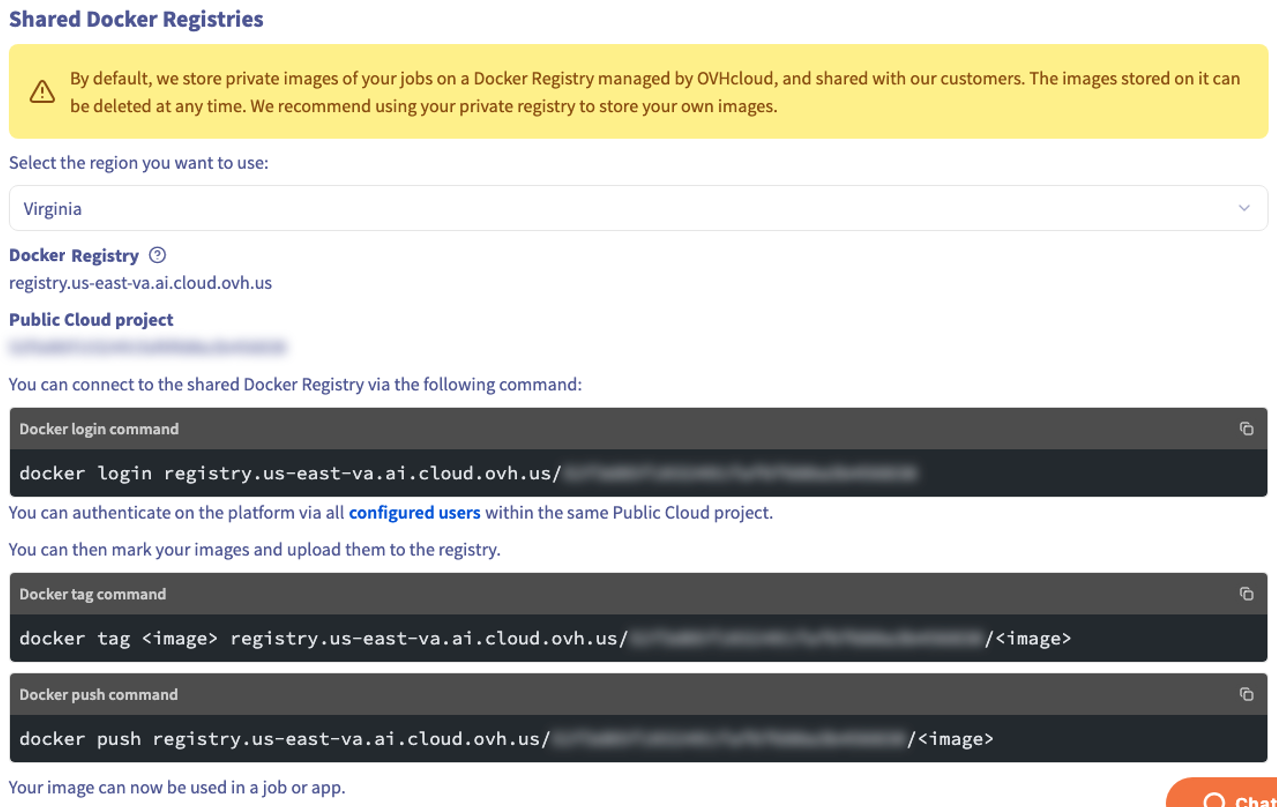

Push the image in the registry of our choice
Pushing our image to a registry is needed for AI Training to pull it.
AI Training provides, for each Public Cloud project, a default registry called shared registry where all users of the same Public Cloud project can push their custom images.
This shared registry can help you perform your tests, but should not be used in production, as we reserve the right to delete its content if deemed necessary. The images pushed to this registry are for AI Tools workloads only, and will not be accessible for external uses. This is why it can be interesting to add other registries. Learn how to do it by following this documentation.
Here are the basic commands to push a Docker image to a registry:
For example, if we want to push the first version of our built image named cnn_image_segmentation_project
inside a registry registry.us-east-va.ai.cloud.ovh.us
, we would use:
If you want to know the exact commands to push on your shared registry, please navigate to the Docker registries
tab of the AI Dashboard
and scroll down.
