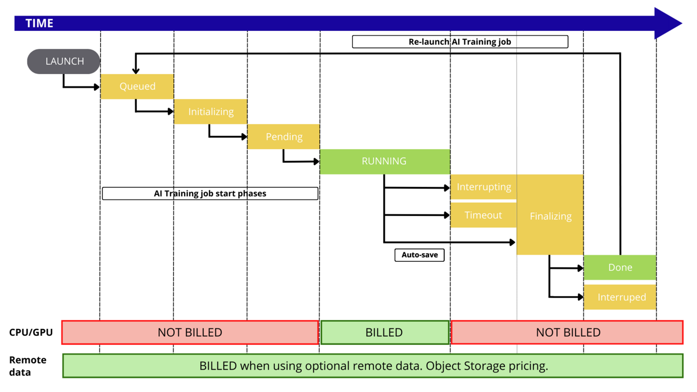

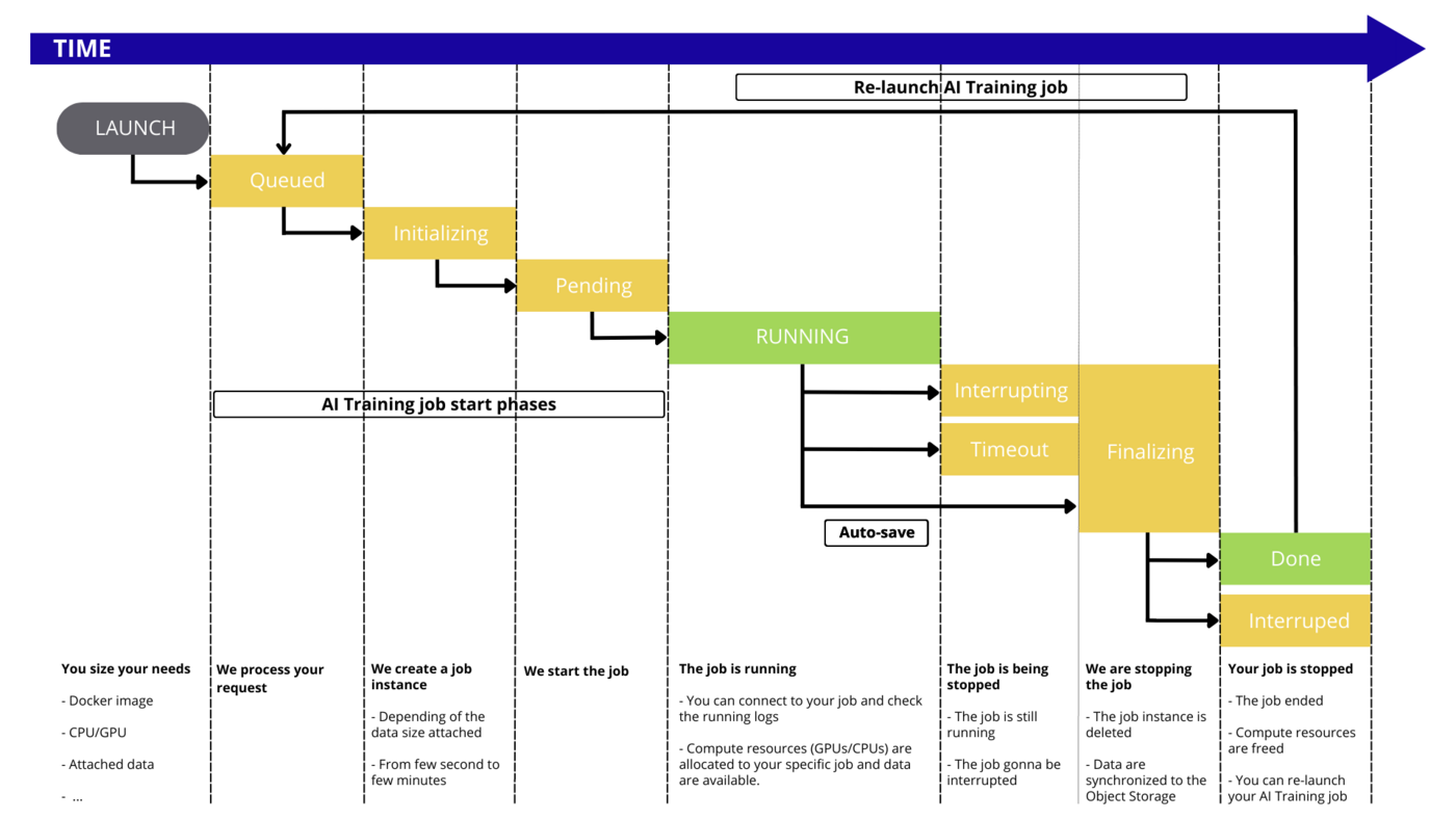

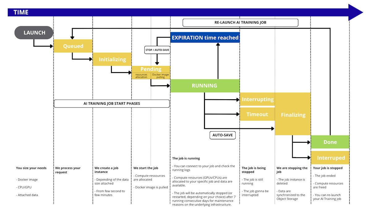

AI Training job lifecycle
During its lifetime, the AI Training job will go through the following statuses:
QUEUED
: The job run request is about to be processed. -
INITIALIZING
: The job instance is created, and the data is synchronized from the Object Storage. To learn more about data synchronization, check out this Data - How it works section. -
PENDING
: The job is being started. -
RUNNING
: The job is running, and you can connect to it. Compute resources (GPUs/CPUs) are allocated to your specific job, and data are available. -
INTERRUPTING
: The job is still running, but an interruption order was received and is about to be processed. -
FINALIZING
: The job instance is deleted, and the data is synchronized back to the Object Storage. To learn more about data synchronization, check out this Data - How it works section. -
DONE
: The job ended normally. -
TIMEOUT
: The job is still running but is about to be interrupted because the timeout was reached. -
INTERRUPTED
: The job ended and was interrupted. -
FAILED
: The job ended with an error, e.g., the process in the job finished with a non-0 exit code, and the Docker image could not be pulled. For more information, refer to this section of our Troubleshooting documentation. -
ERROR
: The job ended due to a backend error. You may contact our support.

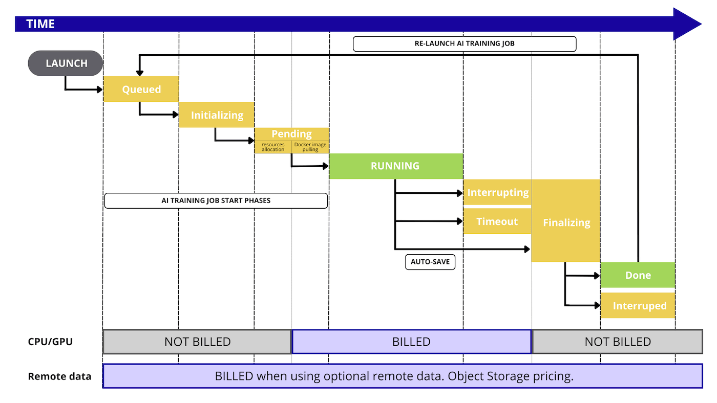

Billing principles
AI Training is a pay-per-use solution. You only pay for the resources consumed during the RUNNING
phase of your jobs.
The billing principle is quite simple: you select the amount of compute resource (CPUs or GPUs) you would like to work with and pay only for this.
Included in AI Training resources:
- AI Training managed service
- Dedicated CPU/GPU compute resources (based on the selected amount)
- Ephemeral local storage (size depends on the selected compute resources)
- Ingress/Egress network traffic
Optional with AI Training:
- Private registries, based on OVHcloud Managed Private registry pricing
- Remote storage space, based on OVHcloud Object Storage pricing
- Egress traffic for remote Object storage

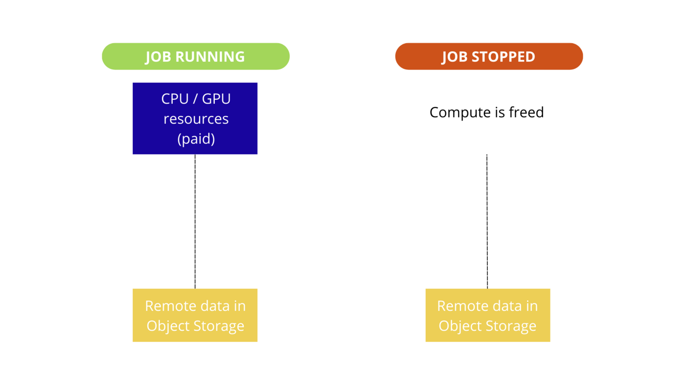

Visual explanations about paid items:
A more detailed view:
Compute resources details
During the AI Training job creation, you can select compute resources, known as CPUs or GPUs. Their official pricing is available in the OVHcloud Control Panel or on the OVHcloud Public Cloud website.
Rates for compute are mentioned per hour to facilitate the reading of the prices, but the billing granularity remains per minute.
Storage details
Each compute resource (CPU or GPU) comes with local storage that we can consider ephemeral since this storage space is not saved when you delete an AI Training job.
The sizing depends on the selected amount of compute resources; check the details on the OVHcloud Public Cloud website.
Remote Object storage
When working with remote data, you pay separately for the storage of this data. The pricing of Object Storage is apart from the AI Training pricing.
