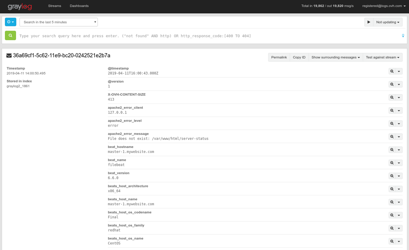

Launch the Filebeat binary or service to test your config file and head to your apache website for an example of how to send some logs. You will see this kind of log in Graylog:
$ ldp@ubuntu:~$ sudo systemctl restart filebeat.service
or
$ ldp@ubuntu:~$ sudo /etc/init.d/filebeat restart
Note the type value (apache or syslog or apache-error) that indicates the source file of the log message. You can easily display only your apache access logs for example by typing in the search bar fileset_module:apache2.
