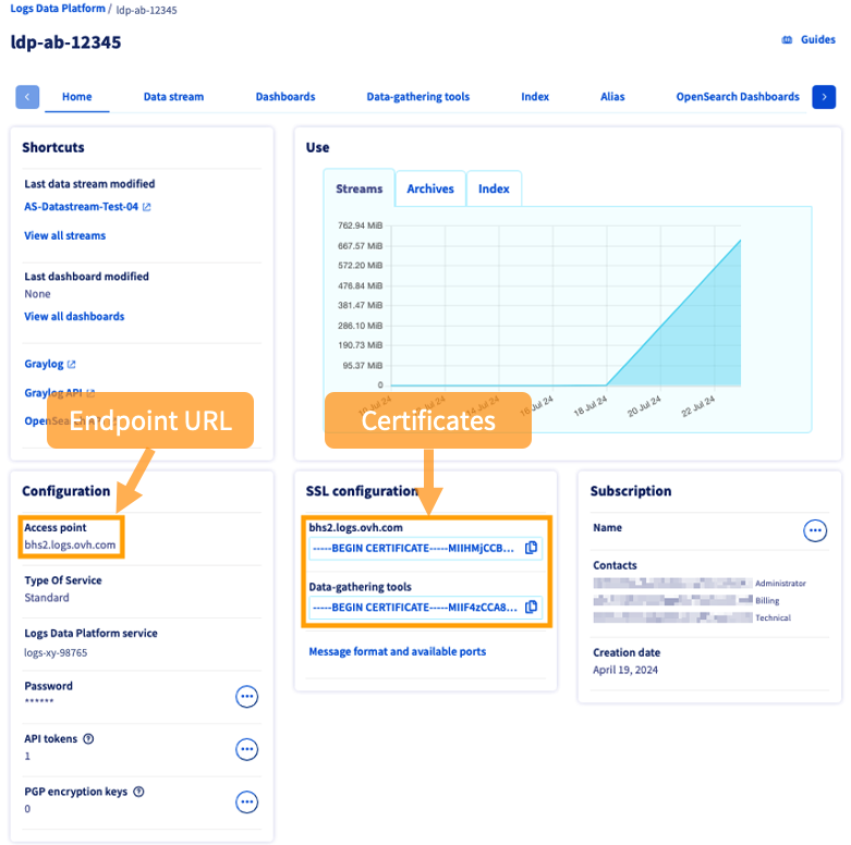

Input endpoint URL: The endpoint URL has the form XXX.logs.ovh.com, XXX corresponding to the cluster you are assigned to. It can be found in your OVHcloud Control Panel on the home page of your Logs Data Platform account.

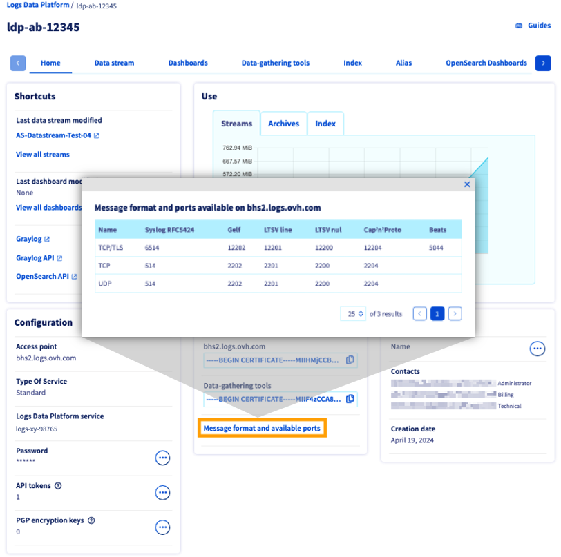

Input endpoint port: The port to which your software must connect depends on the format of your logs, and whether or not you use a secured transport layer. The table below describes the matching between port and log format, but you will also find this information in your OVHcloud Control Panel.
Syslog RFC5424 Gelf LTSV line LTSV nul Cap’n’Proto Beats TCP/TLS 6514 12202 12201 12200 12204 5044 TCP 514 2202 2201 2200 2204 --- UDP 514 2202 2201 2200 2204 ---
Certificate: If you use a secured transport layer, the certificates can also be found in the OVHcloud Control Panel.

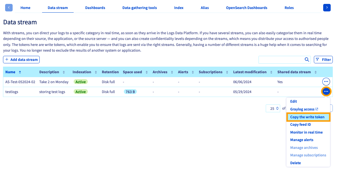

X-OVH-TOKEN: The X-OVH-token is used to dispatch the logs you ingest into Logs Data Platform to the correct log stream. You can find the X-OVH-TOKEN corresponding to your stream in the OVHcloud Control Panel under the Data stream tab.
