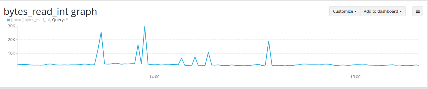

Specifying the correct numeric suffix type is the only way to generate numeric Widgets for your Dashboards. Here is an example of a graph you can generate with a numeric value:
