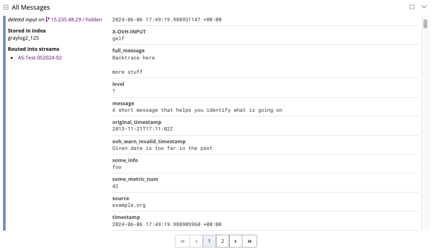

This is one of many configuration examples you can use in your own Logstash to send syslog type logs to the Logs Data Platform. There are a lot of filters and plugins available in Logstash, and the list is growing! For example, by sending these kinds of lines into this Logstash:
You will have the following result in your stream in Graylog:

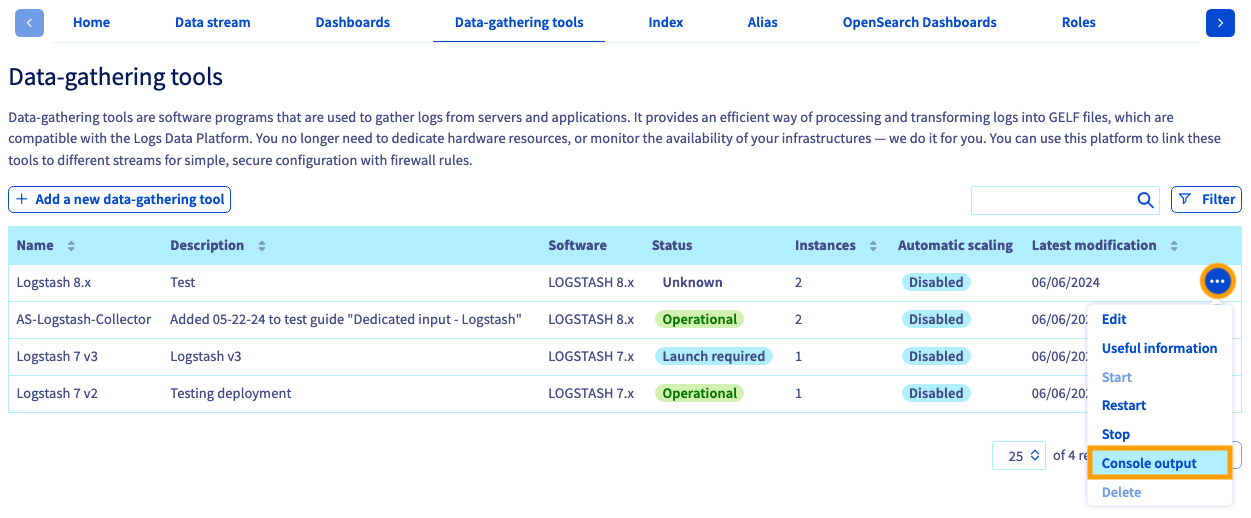

- Check the Data-gathering tools tab and click on the button
Add a new data-gathering tool
. - The Manager will then ask you to provide an elegant name and a wonderful description.

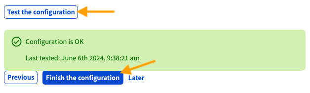

To validate the settings, you will have to click on Test the configuration
button. After some calculations you should see on the screen a green confirmation.
You can then click on Finish the configuration
button to save your configuration!
Starting the input
Starting the input is done by clicking the more options ...
button to the right of your input and selecting Start
. This will deploy your collector on Logs Data Platform.

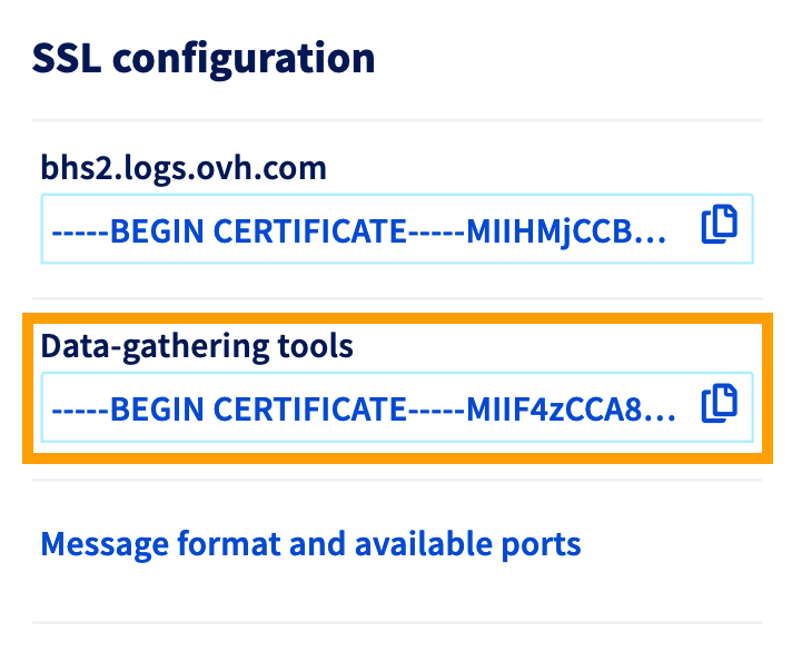

Once your collector is started, you can copy several pieces of information to your clipboard.
- The hostname
- The public IP
- The SSL Certificate

SSL CA certificate
The CA certificate you can use to verify the authority presented by our hosted collectors can be copied from the homepage of the Logs Data Platform manager.
Console output
Last but not least, if you have concerns about the way your logstash is handling your logs, you may be interested to follow the messages coming from your collector. To do this, please go to the dedicated page by clicking on the Console output
button.
