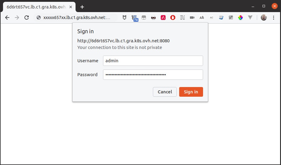

Connect to the Gateway
Get the public IP of your gateway service using:
NOTE: At this moment, your EXTERNAL-IP could be still PENDING.
The provisioning of the load balancer can take several minutes. Check again until the EXTERNAL-IP is filled with a public IP address.
Once the public IP address is available, you may access the OpenFaaS UI at http://PUBLIC_IP:8080.
