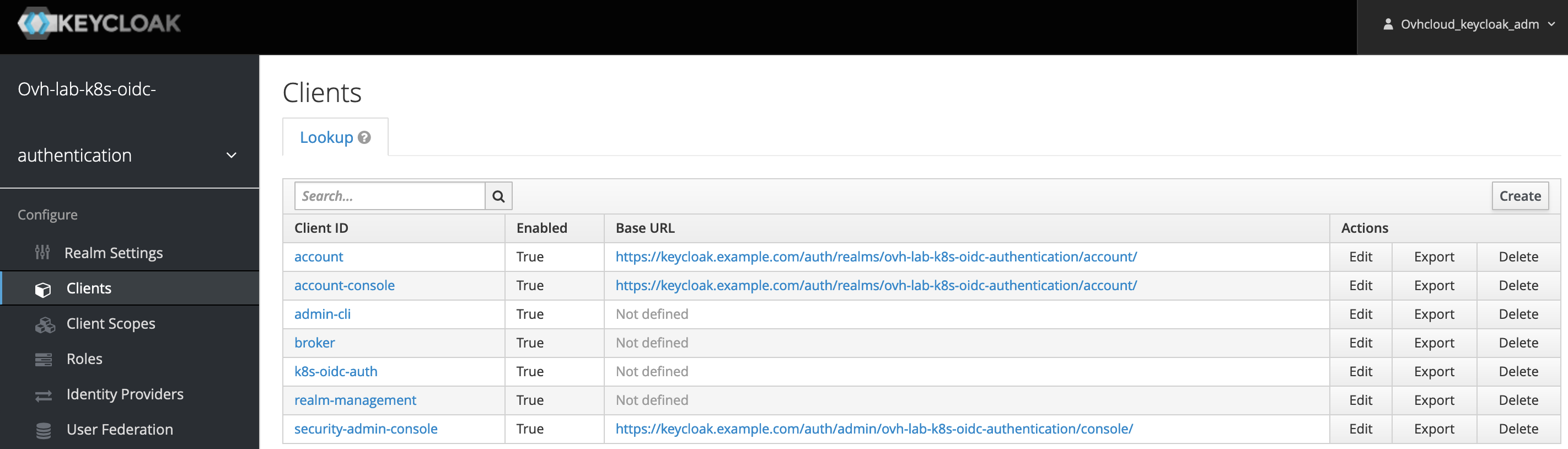

Create a CLIENT
A client in Keycloak is an entity that can request a Keycloak server to authenticate a user.
From the previously created realm, click on the left-hand
Clientsmenu under theConfigurecategory:
- Click
Createin the top-right corner of the table. -
Fill in the form with the following parameters:
Client ID: k8s-oidc-auth Client Protocol: openid-connect Root URL: https: https://keycloak.your-domain-name.tld/In our example, the new client information is:
- Click the
Savebutton. -
In the newly-created client, find the
Access Typefield and set its value toconfidentialto require a secret to initiate the login protocol. Then click the blueSavebutton to save the change.
- Then click on the
Credentialstab. Find theValid Redirect URIsfield and set the following value:* -
Find the
Admin URLand theWeb Originsfields and set their values to your defined domain name if it is not already done.In our example:https://keycloak.example.com/.
__\/!\ Be careful to use the HTTPS schema only /!\__ - Save your changes.
