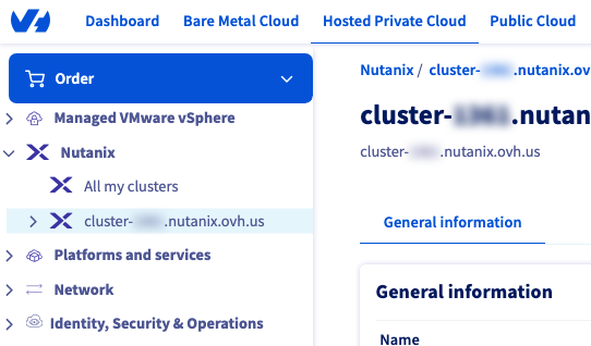

From the OVHcloud Control Panel, navigate to your Nutanix cluster via the Hosted Private Cloud and Nutanix menus.

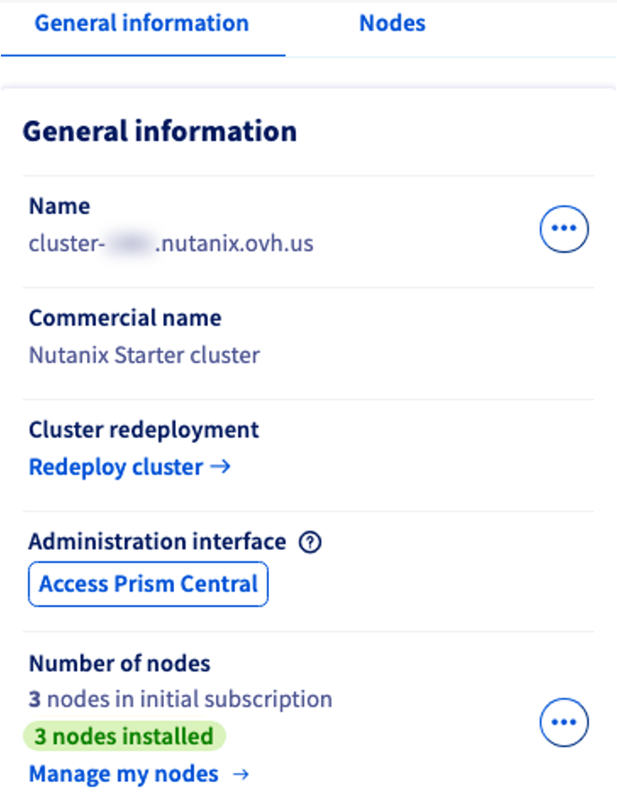

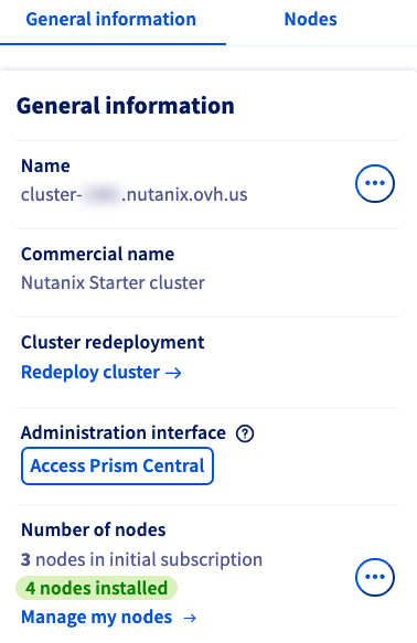

In the General information tab, you can see the Number of nodes. Click Manage my nodes →.

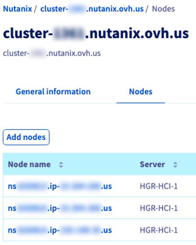

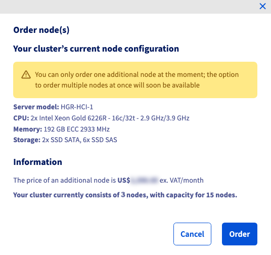

In the Nodes tab, select Add nodes.
In the pop-up window, review the configuration information and pricing. Click Order to add the node(s).

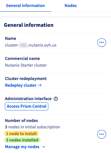

Once the node is delivered, you can see the status in the General information tab.
The Number of nodes area will show a new node to install.

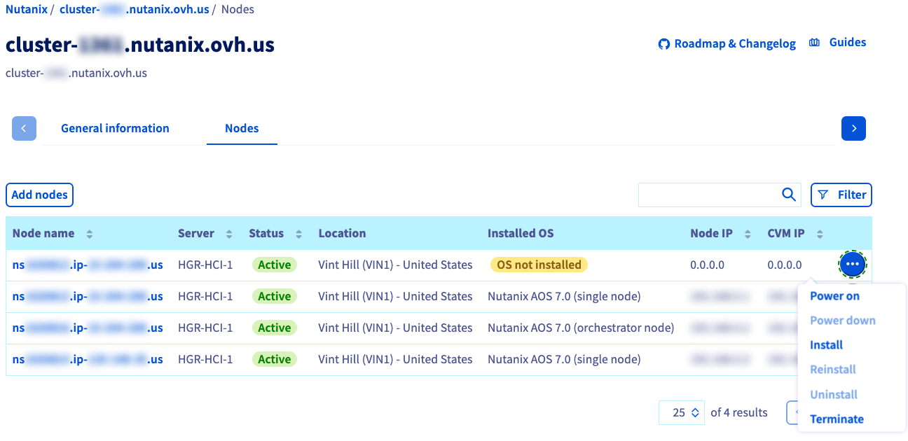

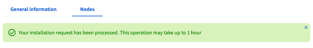

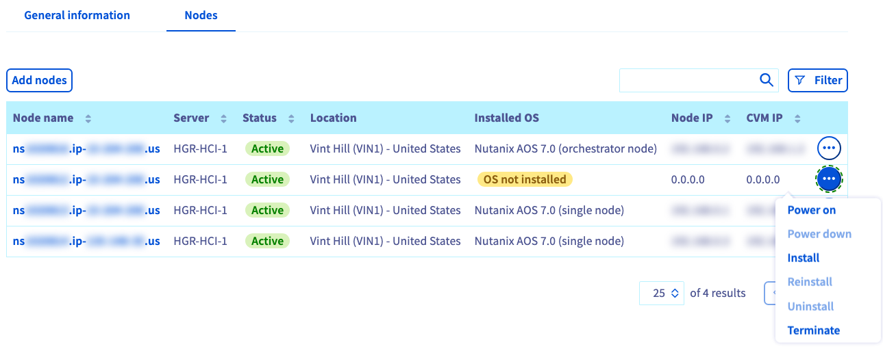

If you click Manage my nodes → again, you will see a list of your nodes. For any node with a OS not installed status, click the more options ... button and select Install.

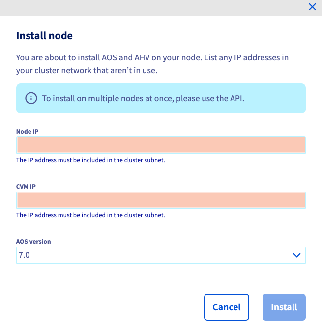

Enter the configuration details for your node. Be sure to install the same AOS version as your cluster.
Click Install.
A confirmation message will appear.

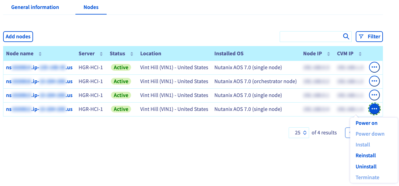

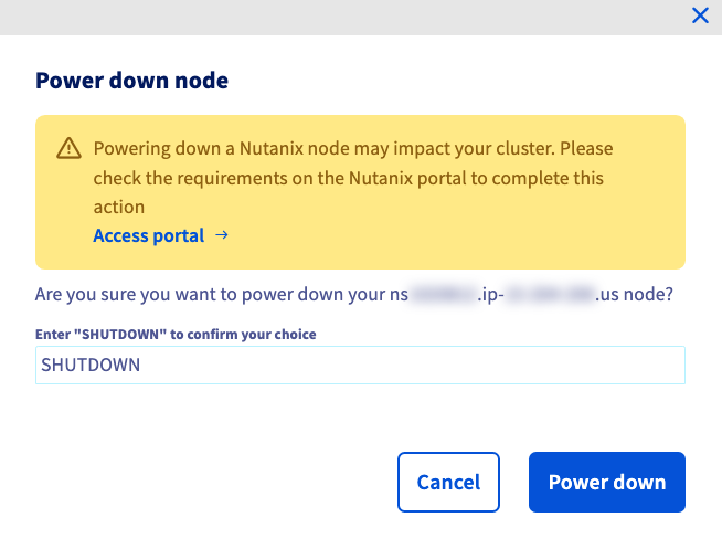

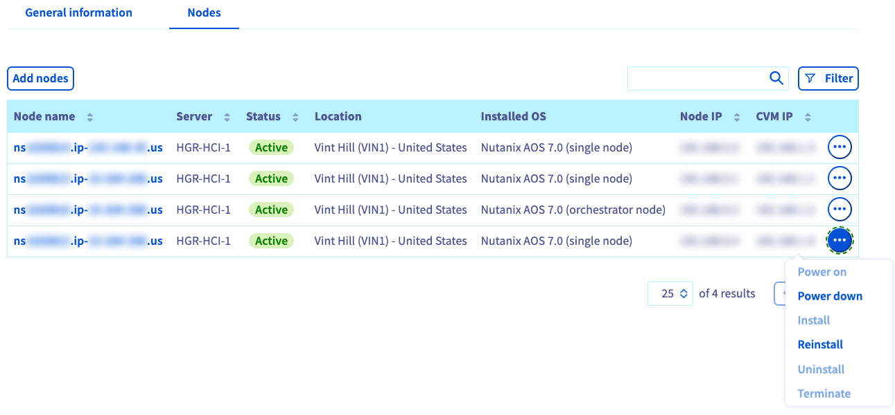

For the node you wish to remove, click the more options ... button and select Power down.
A warning pop-up will appear. Type the required term and click Power
down.
NOTE: Powering down a Nutanix node may impact your cluster. Please check the requirements on the Nutanix portal to complete this action.

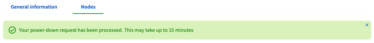

A confirmation banner will appear to confirm that your request is processing.

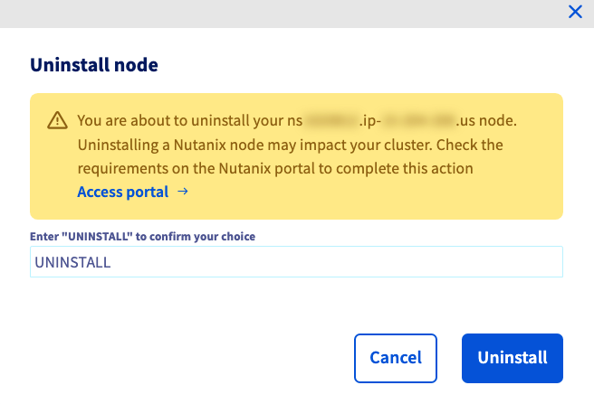

Uninstall the node
Once the node is powered down, click the more options ... button and select Uninstall.
A warning pop-up will appear. Type the required term and click Uninstall.
NOTE: Uninstalling a Nutanix node may impact your cluster. Please check the requirements on the Nutanix portal to complete this action.

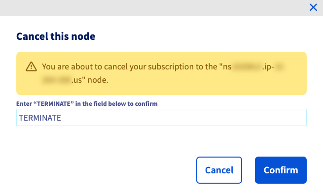

Remove the node
Once the node is uninstalled, click the more options ... button and select Terminate.
A warning pop-up will appear. Type the required term and click Confirm.
NOTE: Your suspended service will appear in your nodes list for approximately one week before being permanently deleted. This allows you to reactivate the service if you need to reverse the deletion.
