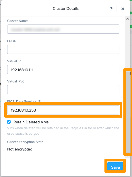

From Prism Central, click your cluster in the Cluster Quick Access widget to connect to Prism Element.
Click your cluster's name in the top left-hand corner next to the X.
Verify the IP Address in the ISCSI Data Services IP section, then click Save.

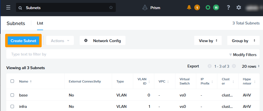

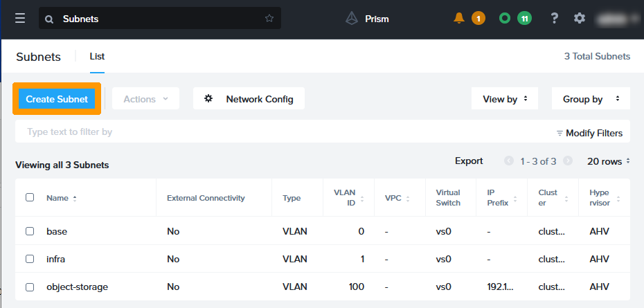

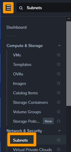

From Prism Central, go to the main menu and click on Subnets in the Network & Security category.
Click Create Subnet.

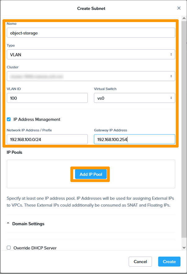

Check the IP Address Management box and fill in this information :
object-storage. -
Type: Select
VLAN. -
VLAN ID: Type your VLAN number as
100. -
Virtual Switch: Keep
vs0. -
Network IP Address / Prefix: Write your subnet
192.168.100.0/24. -
Gateway IP Address: Enter the address of your gateway
192.168.100.254.

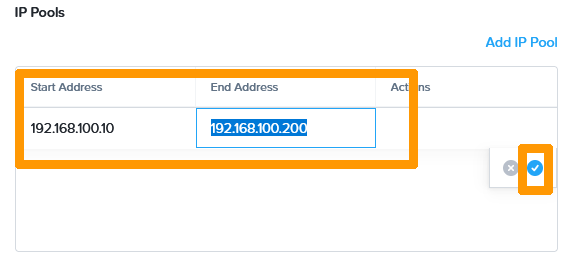

Then click Add IP Pool.
Enter this information :
Start Address: Start address of your scope as
192.168.100.10. -
End Address: End address of your scope as
192.168.100.200.
Then click the blue validation button ✓ on the right.

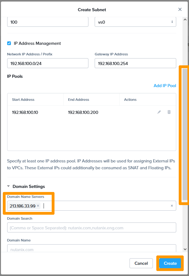

Scroll down and enter the OVHcloud DNS address 213.186.33.99 in Domain Name Servers and click Create.

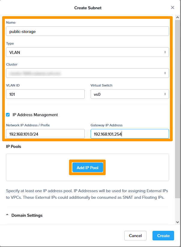

Your first VLAN is created. We will create the second VLAN, click on Create Subnet.
public-storage. -
Type: Select
VLAN. -
101. -
vs0. -
192.168.101.0/24. -
Gateway IP Address: Enter your gateway address
192.168.101.254.

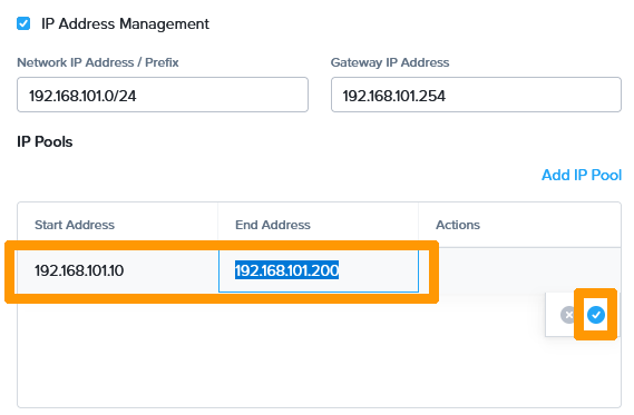

192.168.101.10. -
192.168.101.200.
Next, click the blue validation button ✓ on the right.

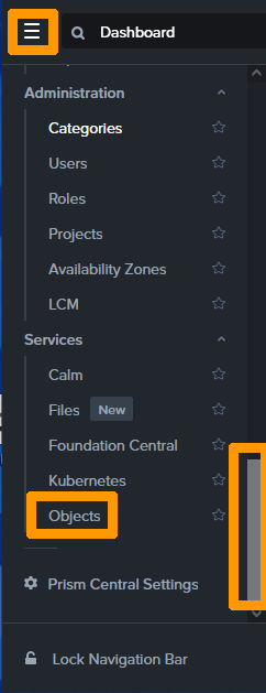

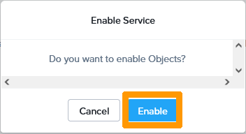

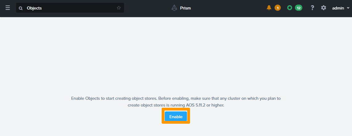

Go to the main menu, scroll to the Services section, and click Objects.
Click Enable.
Click Enable to validate the activation of Nutanix Objects.

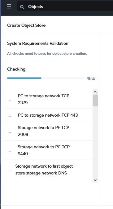

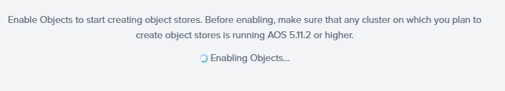

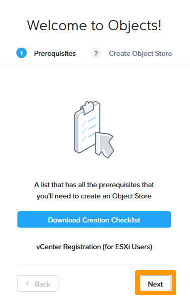

The service checks your system compatibility.

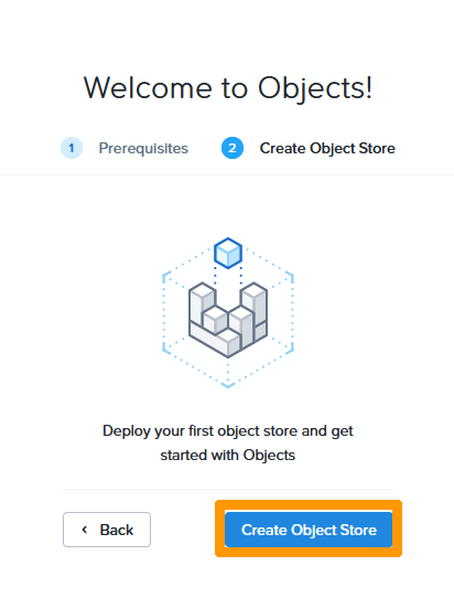

Click Next.

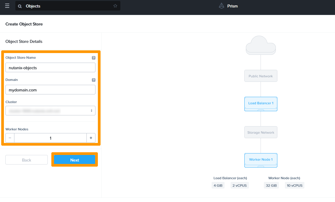

Click Create Object Store.
Fill in this information :
Object Store Name: the name of your object storage, such as
nutanix-objects. -
Domain: The domain name that will be used to access your storage, such as
mydomain.com. - Cluster: The cluster that must have Nutanix Objects enabled.
Worker Nodes: The number of nodes that your Object storage will use, select the number
1.
Then click Next.

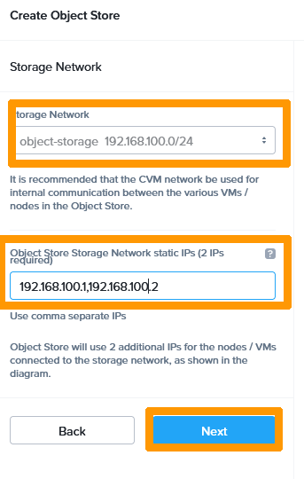

Select the VLAN object-storage in Storage Network and enter these two addresses 192.168.100.1,192.168.100.2 in Object Store Storage Network static IPs (2 IPs required). These addresses must not be within the scope of the VLAN DHCP.
Then click Next.

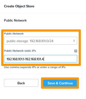

Select the public-storage VLAN in Storage Network and enter this range of four addresses 192.168.101.1-192.168.100.4 in Public Network static IPs. These addresses should not be within the scope of the VLAN DHCP.
Next, click Save & Continue.

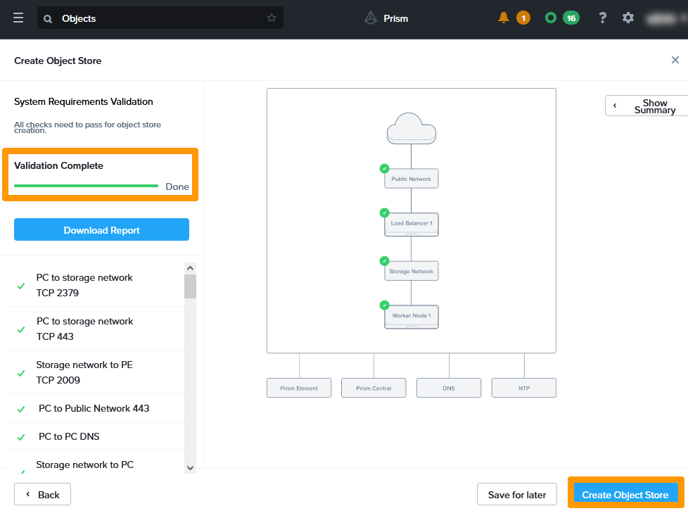

A connection check is performed between the VLANs, Prism Element, and Prism Central.

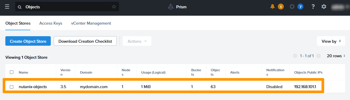

When validation is complete, click Create Object Store.
Wait twenty minutes for your Object Storage to be active and accessible through the address 192.168.101.1 that is located in your public-storage VLAN.

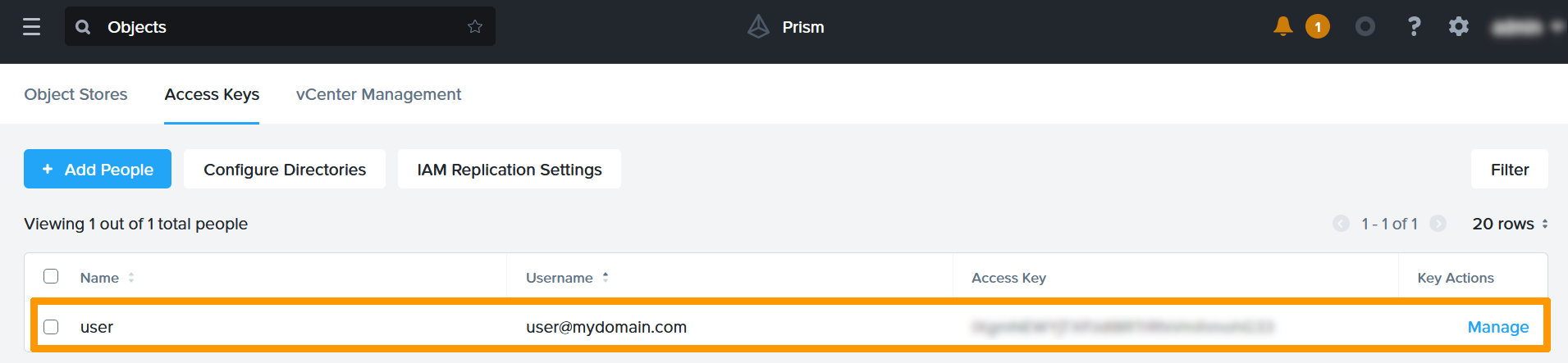

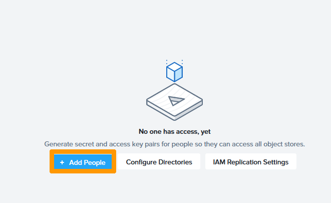

Creating an Access Key to your storage

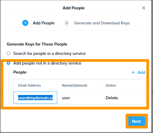

To be able to use Object storage, it is necessary to create associated Access Keys.

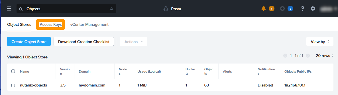

Go to the Access Keys tab.
Click + Add People.

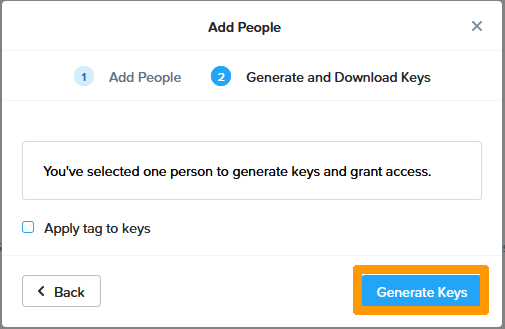

Check Add people not in a directory service, type user@mydomain.com in Email Address, and click Next.

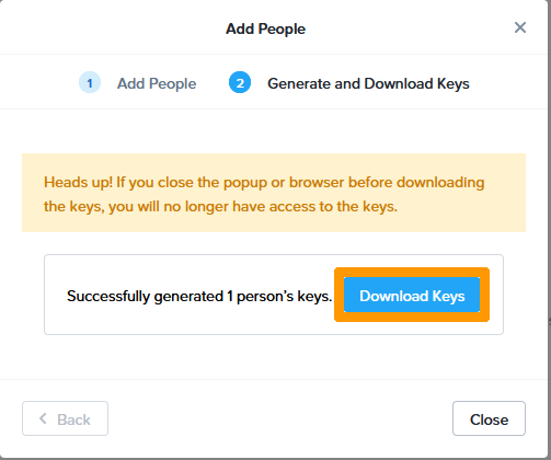

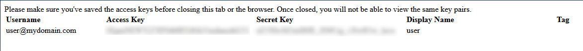

Click Generate Keys.
Click Download Keys.
Your user is created with its login details. You can regenerate Access Keys and create a new login.

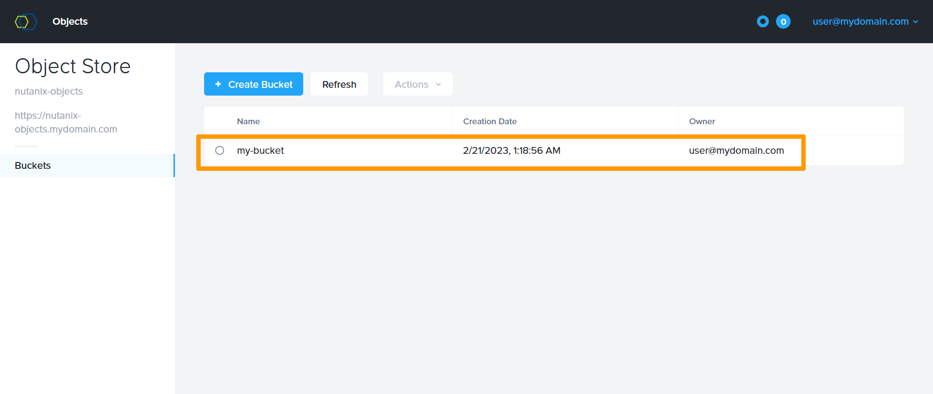

Now that the bucket is created we will use a browser to connect to the web interface provided by Nutanix to check the existence of our bucket.

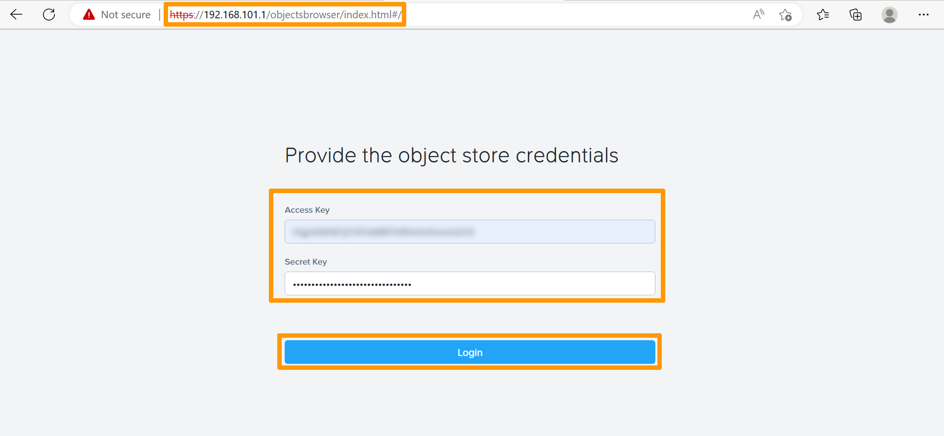

Using a web browser, connect to this URL https://192.168.101.1/objectsbrowser which corresponds to your Nutanix Objects access point, and enter your credentials (access_key and secret_key). Then click on Login.
You can see the bucket you created in the command line. You can create and delete buckets or objects in your web interface.
