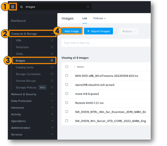

Once you connect to Prism Central:
- Select the main menu icon in the upper-left corner.
- Click
Compute & Storage. - Select
Images. - Click on the
Add Imagebutton.

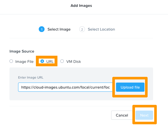

Select URL as the image source.
Paste the URL of a compatible cloud image. For example:
https://cloud-images.ubuntu.com/focal/current/focal-server-cloudimg-amd64.img
Click on Upload file, then Next.

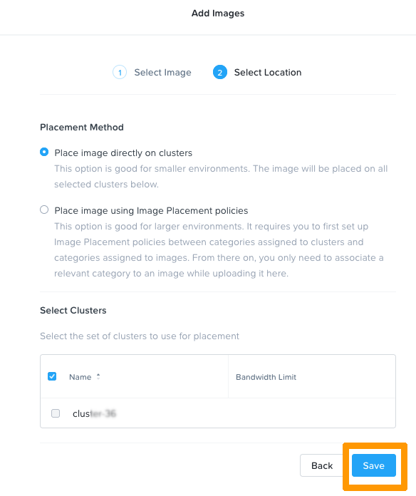

Select Place image directly on clusters, then select your cluster and Save.
