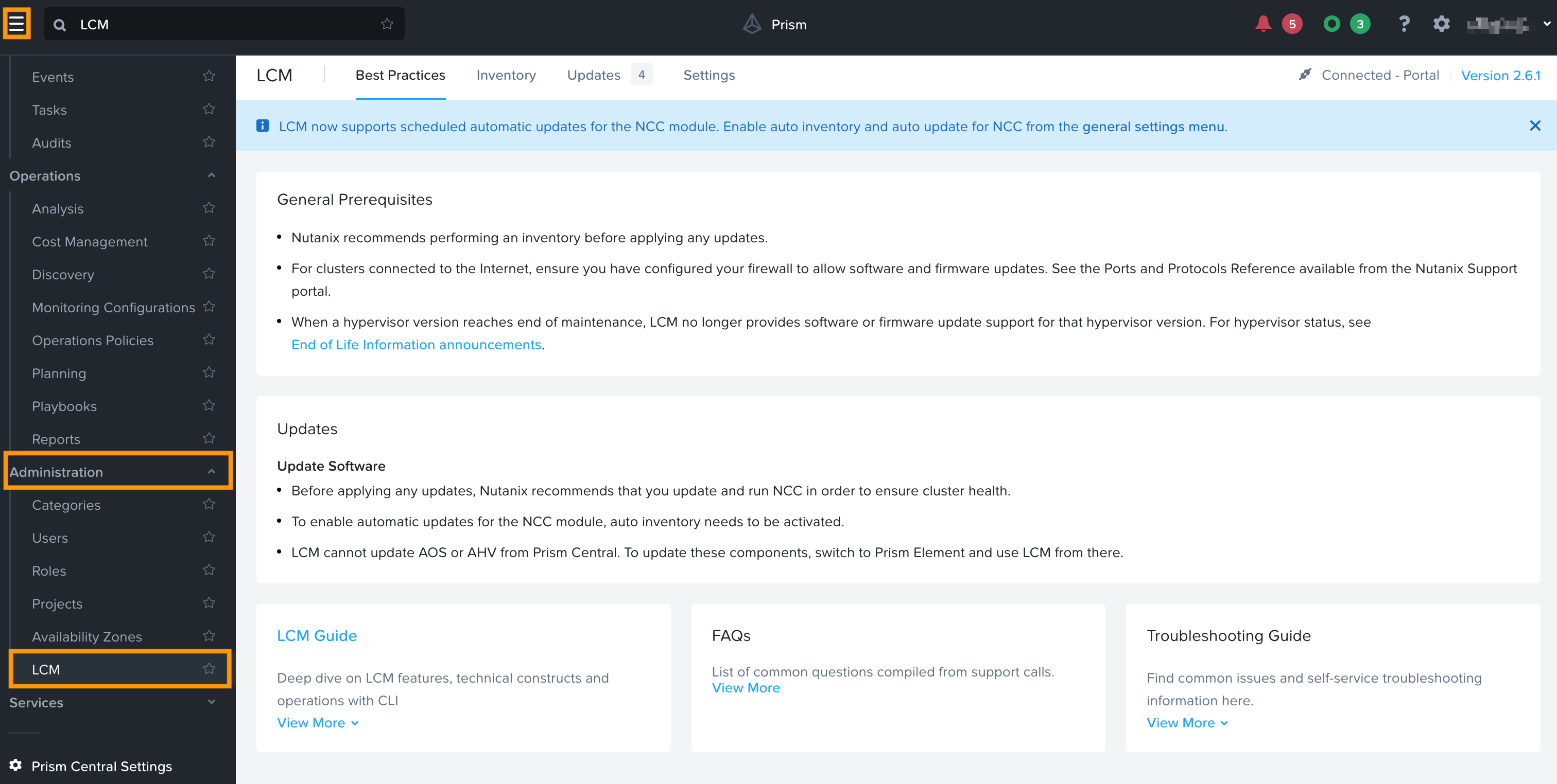

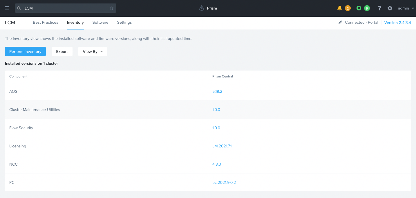

As documented in the official upgrade process, you should first launch an LCM Inventory to get a view of the software status of the Nutanix Cluster. To do this, select the main menu icon in the upper-left corner. Then, select the Administration submenu and then click LCM.

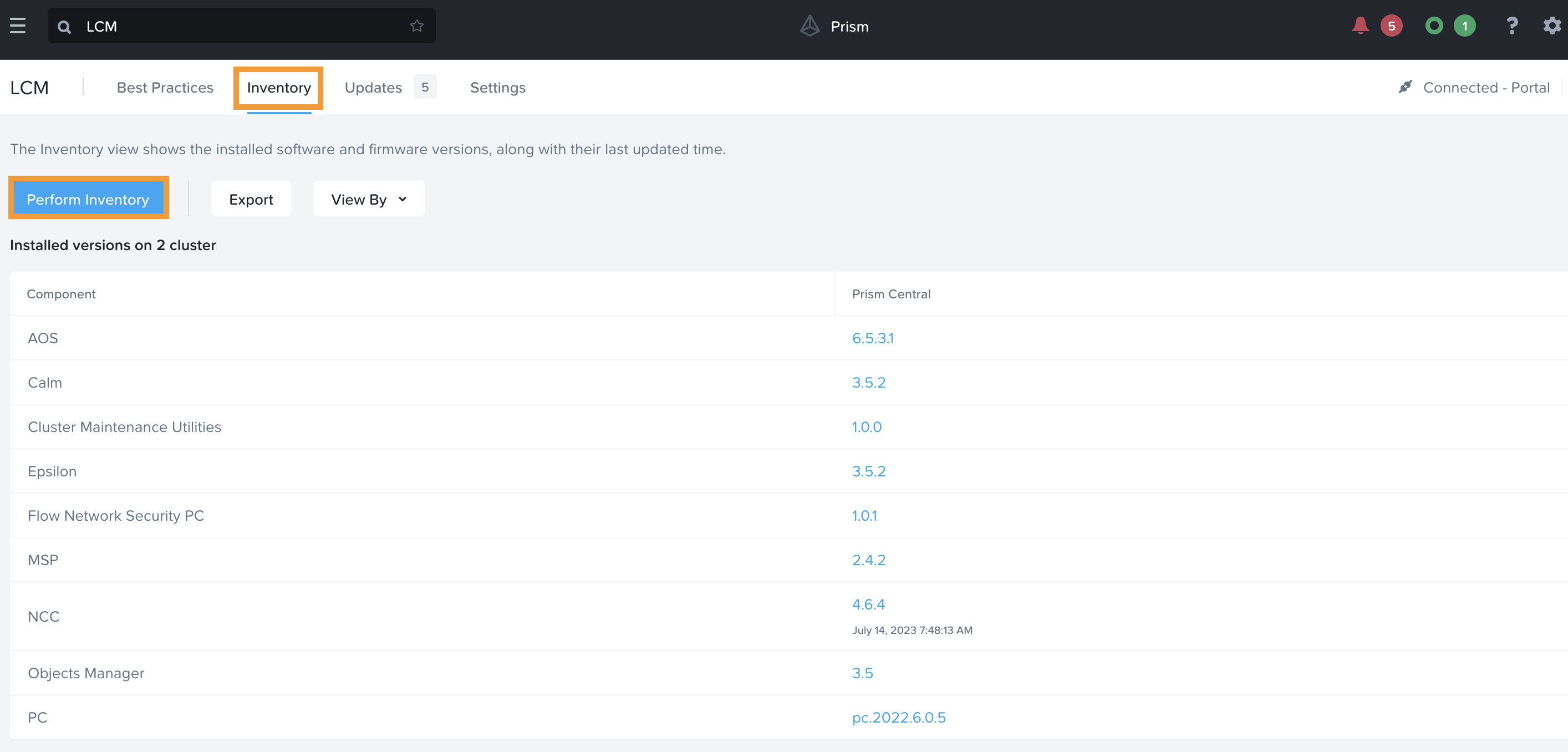

Select the Inventory tab, then select the Perform Inventory button.
After a pre-check phase, you will receive the results as soon as the inventory is done. The available upgrades will be displayed:

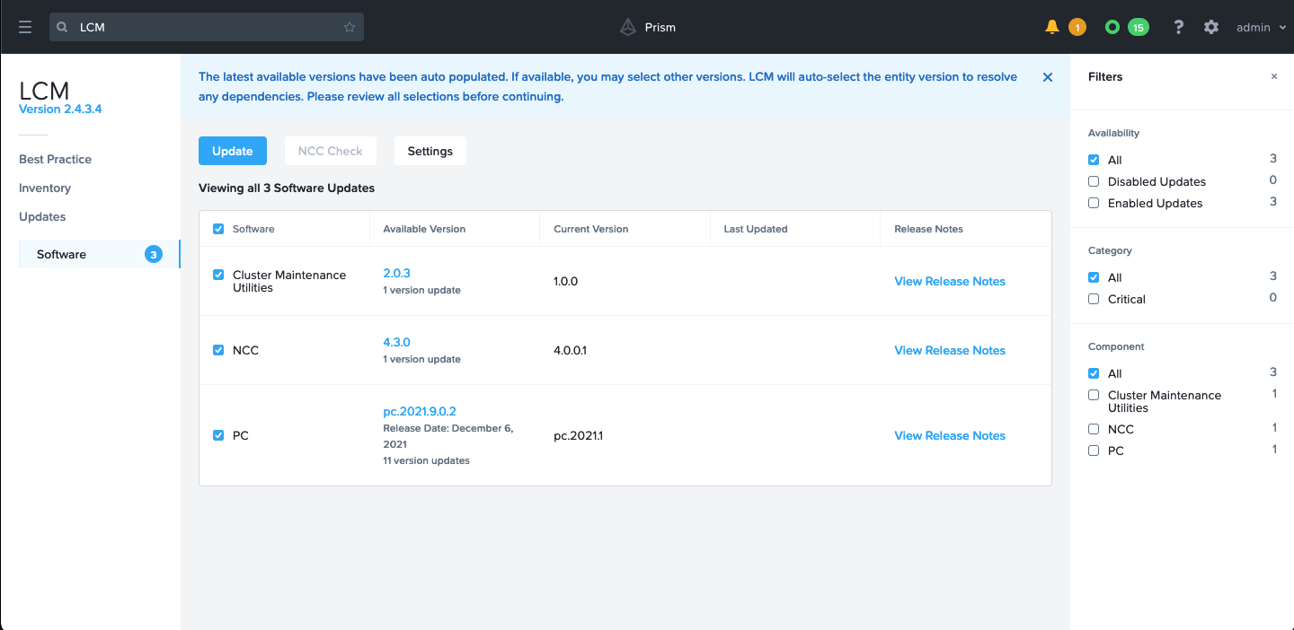

Select the upgrades you want or update all components. You can also decide to manage those upgrades directly as explained in the next two sections.
Performing the upgrade

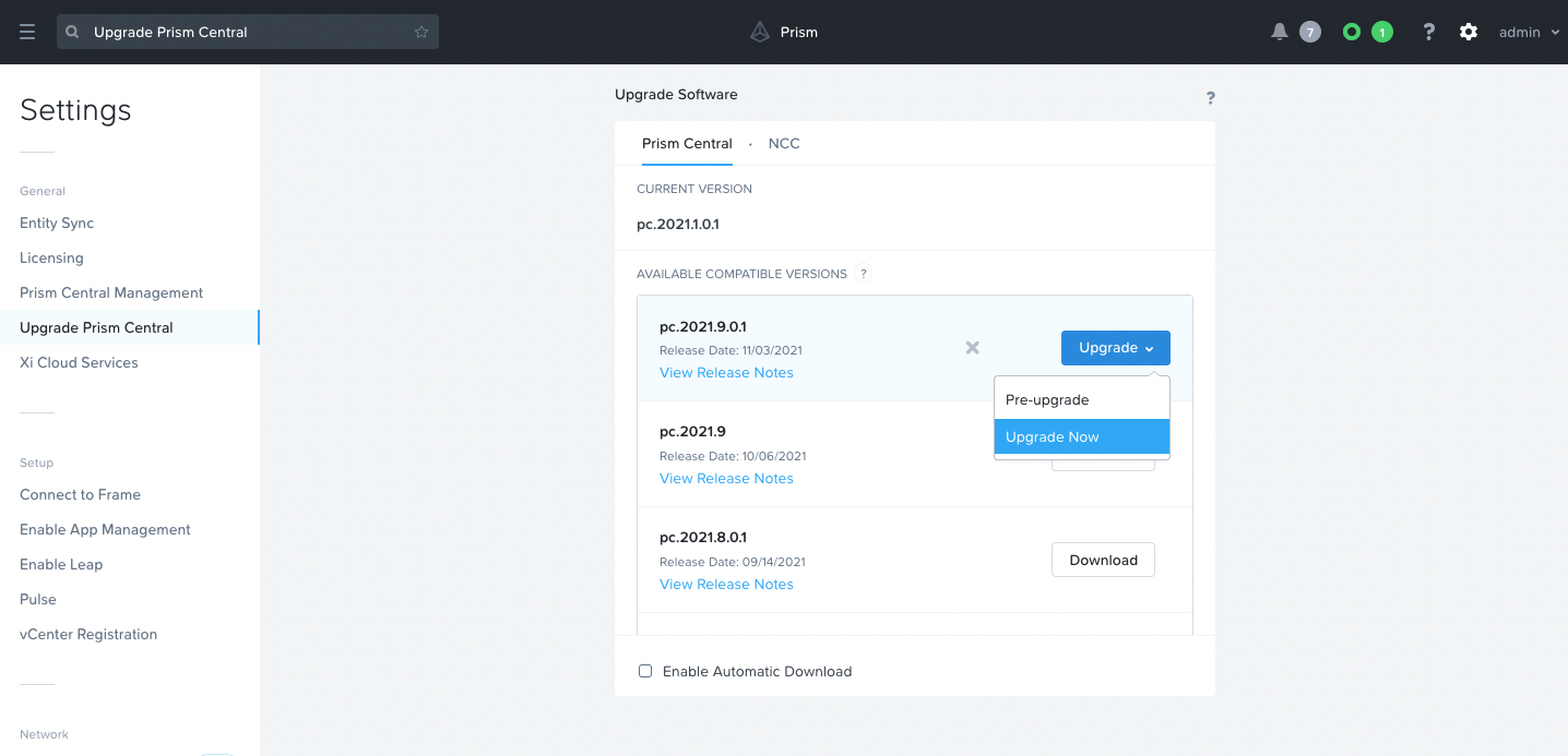

Once you are certain that you can launch the upgrade, open the Prism Central Settings:

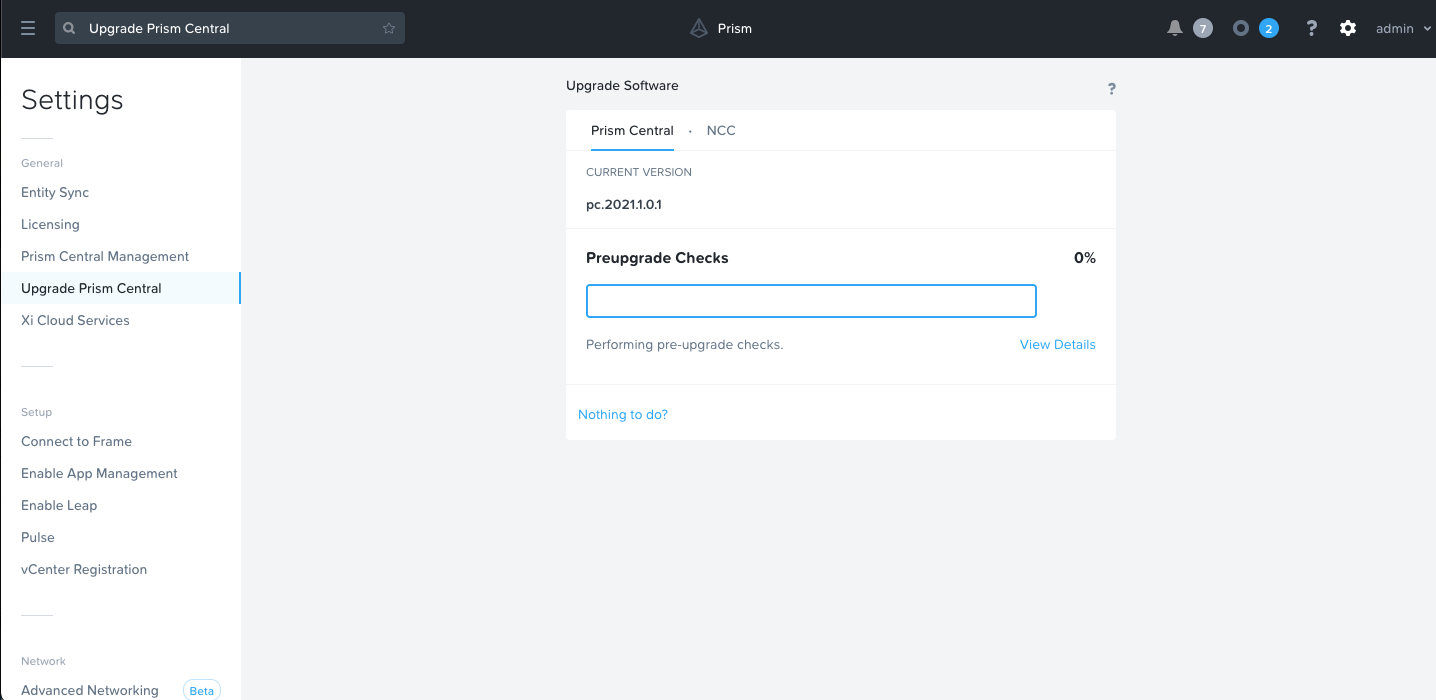

If there are available upgrades, you can select the ones you need to apply, then choose to only do the pre-check or upgrade immediately:
The pre-check will be executed in any case:

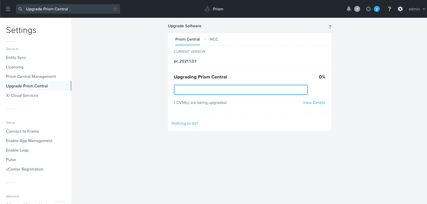

If you have selected the upgrade process, the process itself will be initiated:

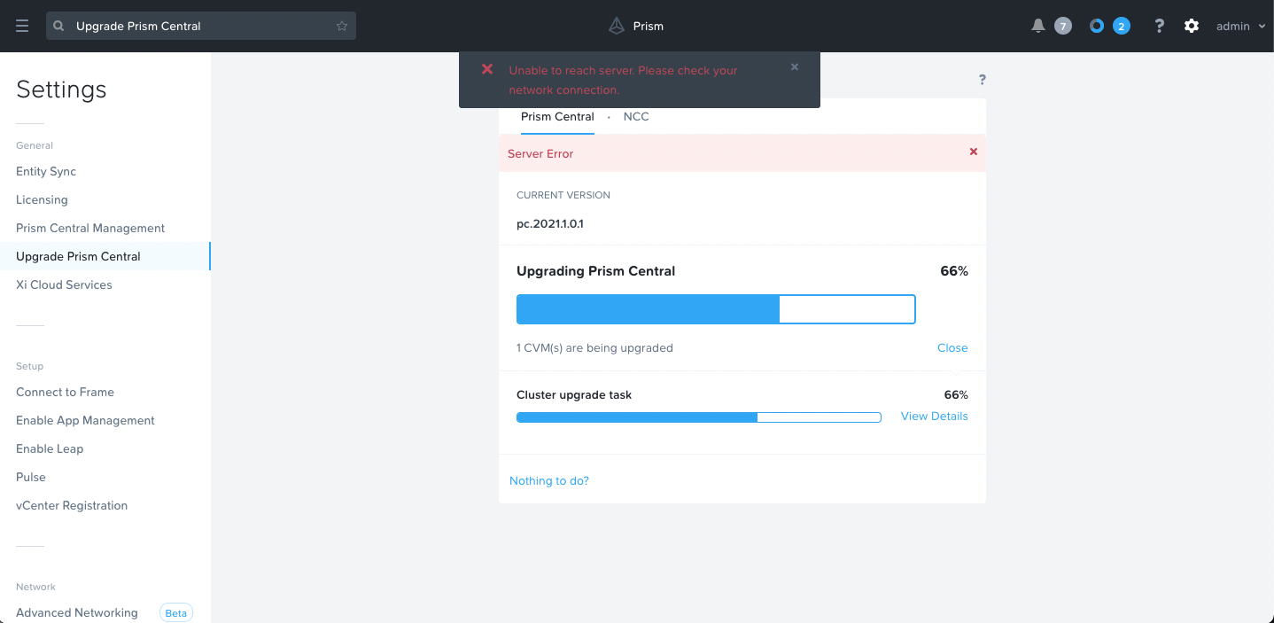

During the execution, you might lose the connection to Prism Central:
After a few minutes, you can connect back to the Prism Central interface, and you can then check or wait for the end of the upgrade process:

LCM Inventory update
Update the LCM inventory. If no upgrades are available anymore, then only the list of installed software components releases will be presented:

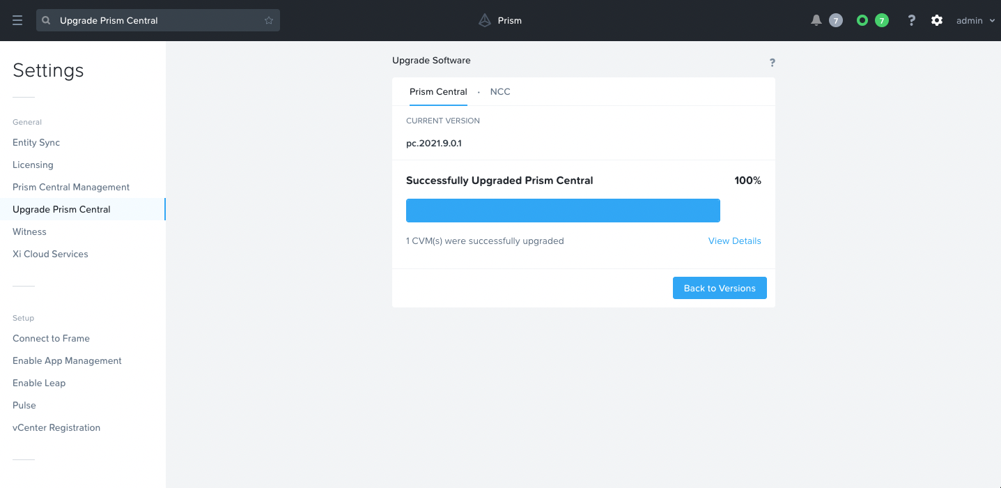

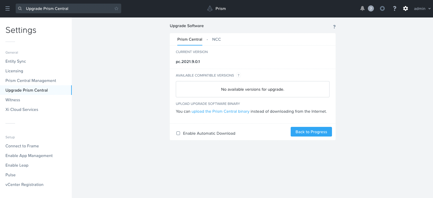

Prism Central upgrade validation

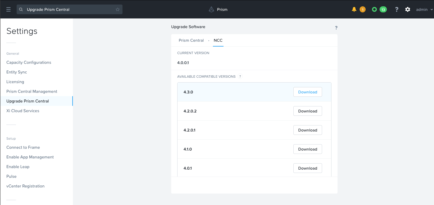

You can also check that the Nutanix Cluster Prism Central is up-to-date if there is no upgrade available for your cluster: Click on the Prism Central Settings and open Upgrade Prism Central. There should be no available versions:

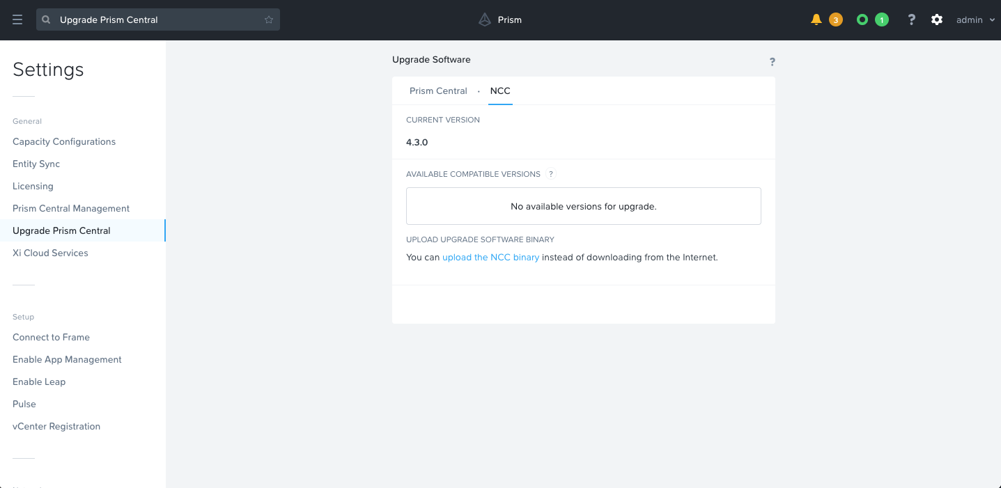

NCC upgrade validation
You can also check that the Nutanix Cluster NCC is up-to-date if there is no upgrade available for your cluster: Click on the Prism Central Settings and open Upgrade Prism Central. There should be no available versions in the NCC tab:

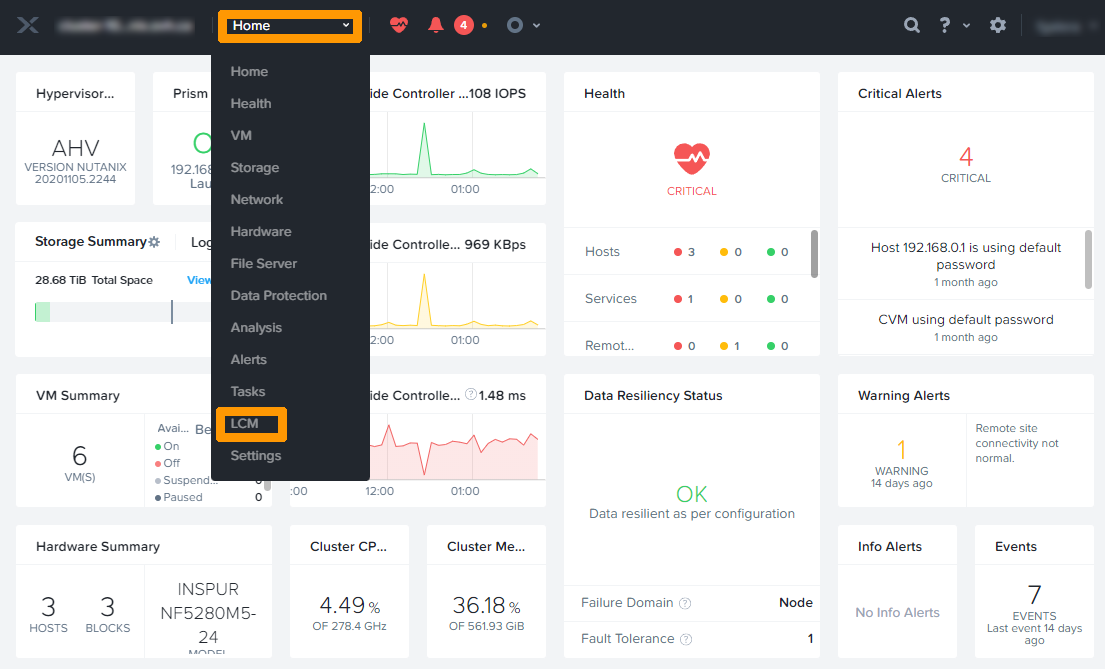

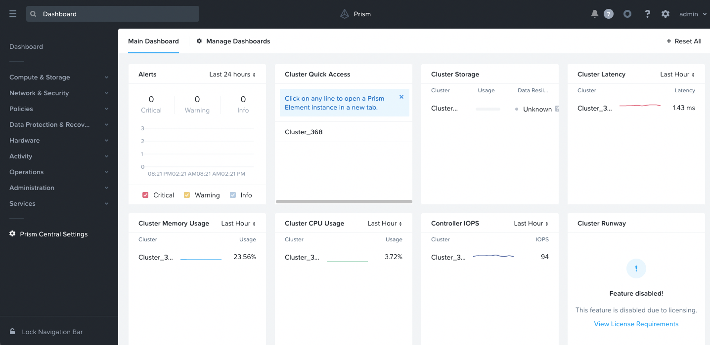

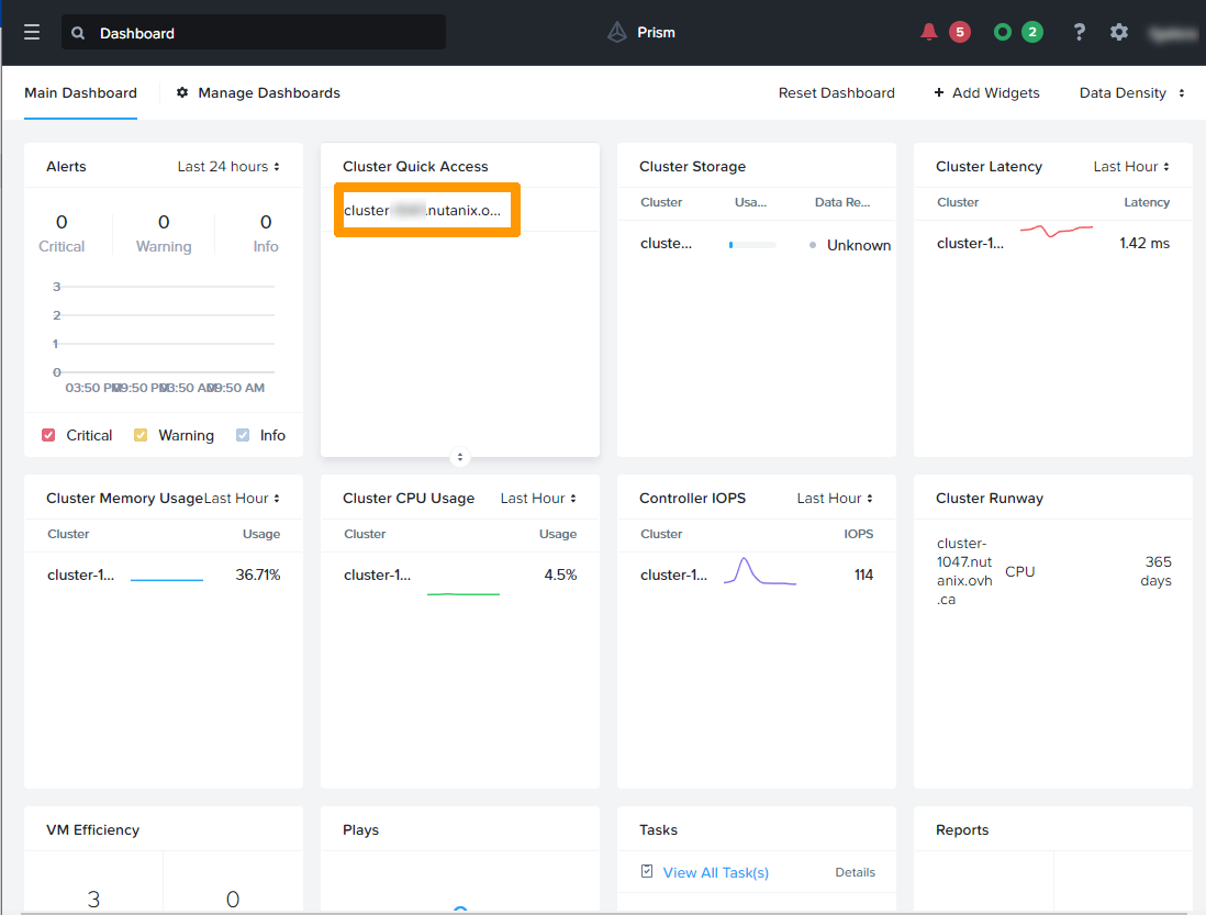

From the Prism Central dashboard, in the Cluster Quick Access frame, click your cluster.

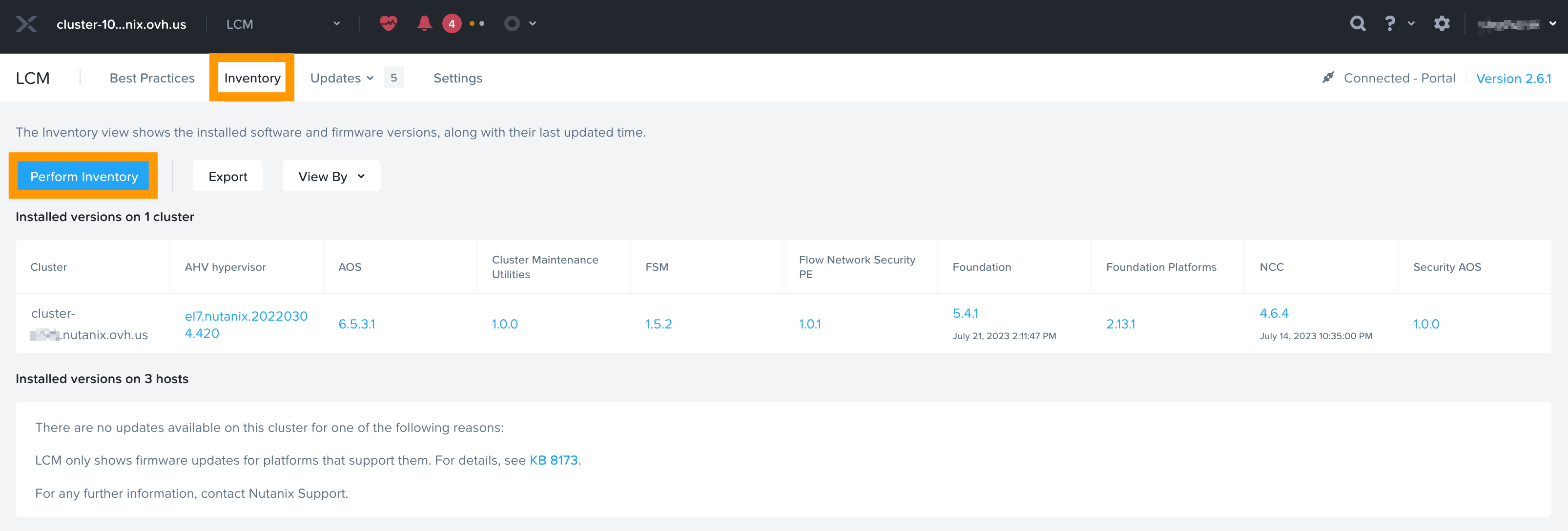

Open the Menu and click on LCM.

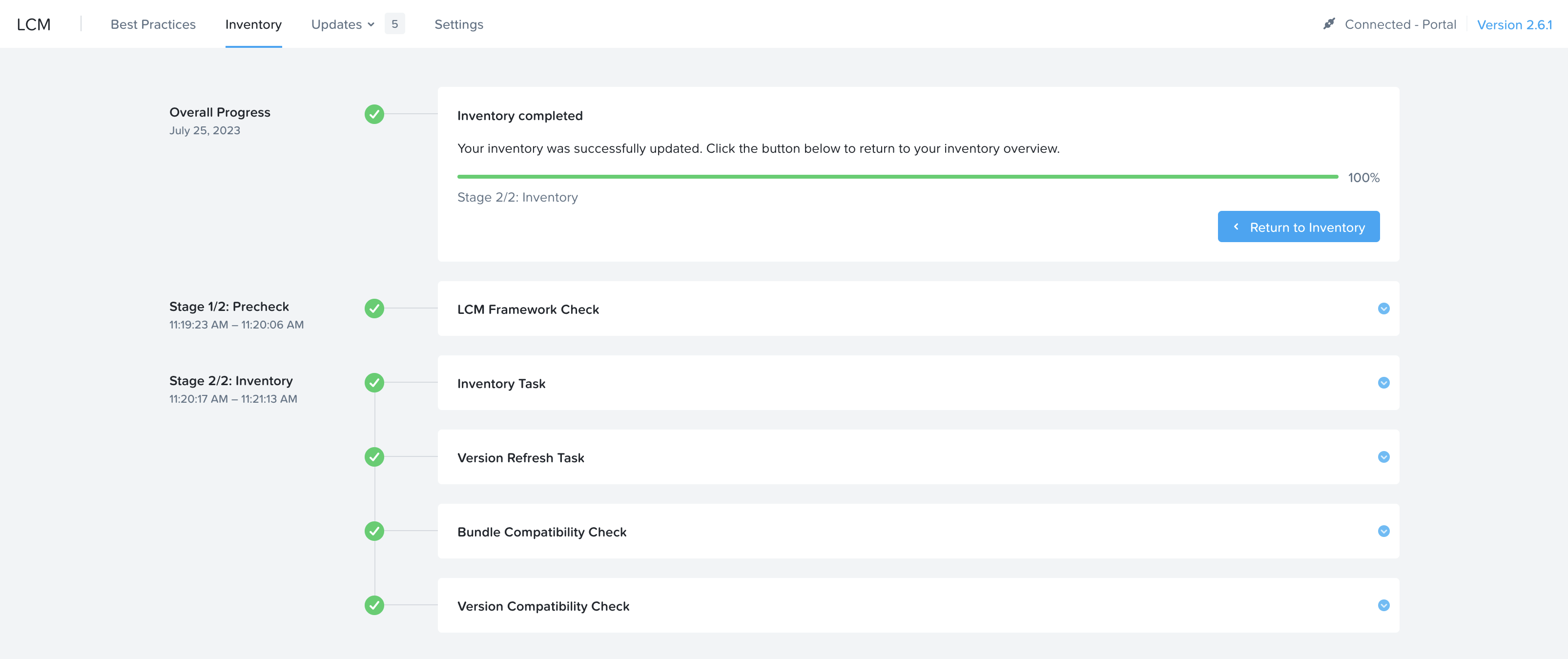

Click on the Inventory tab, then on the Perform Inventory button.
When the check is complete, click Return to Inventory.

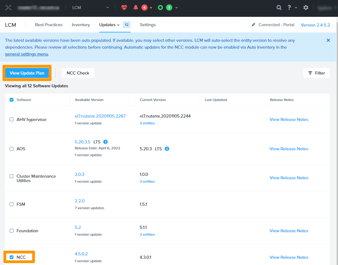

First, we will update NCC.
Check NCC and click View Update Plan.

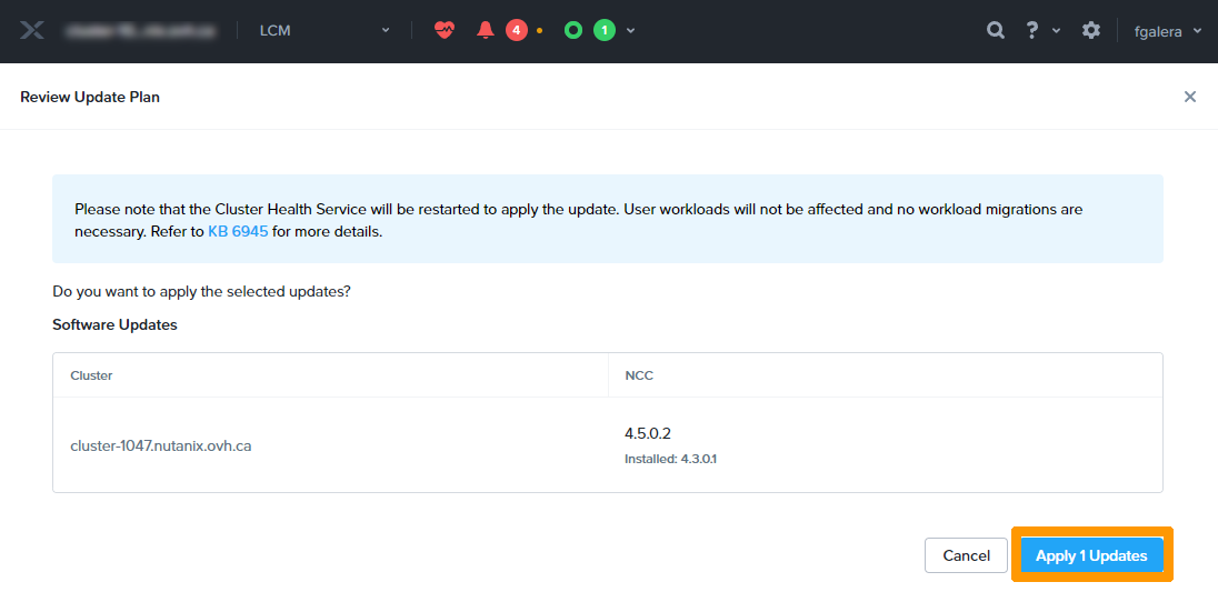

Click Apply 1 Updates.

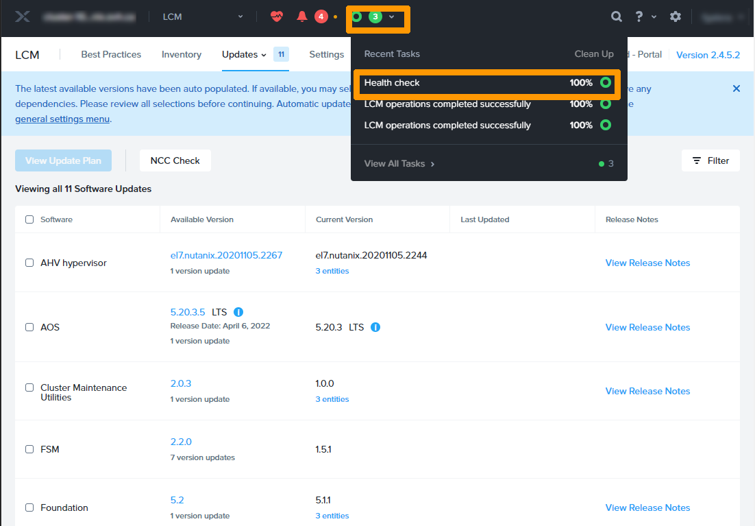

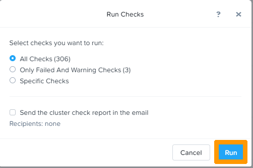

Click NCC Check to check the system before major updates.
Leave All Checks and click Run.
Wait for the Health check task to complete. You can view it in the Tasks menu.

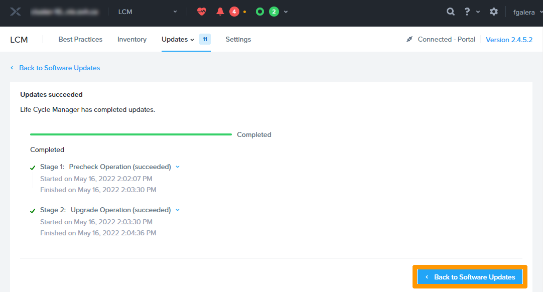

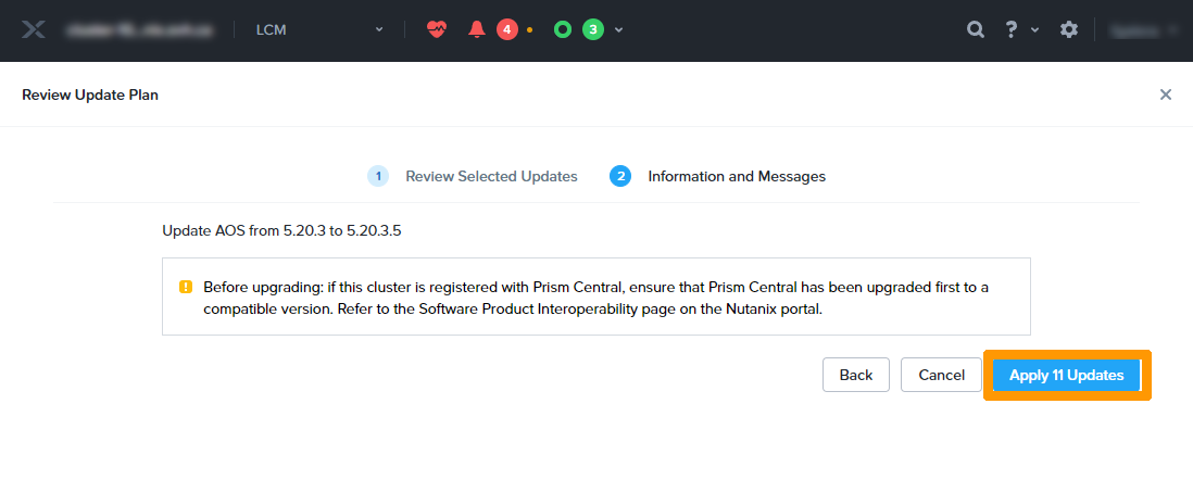

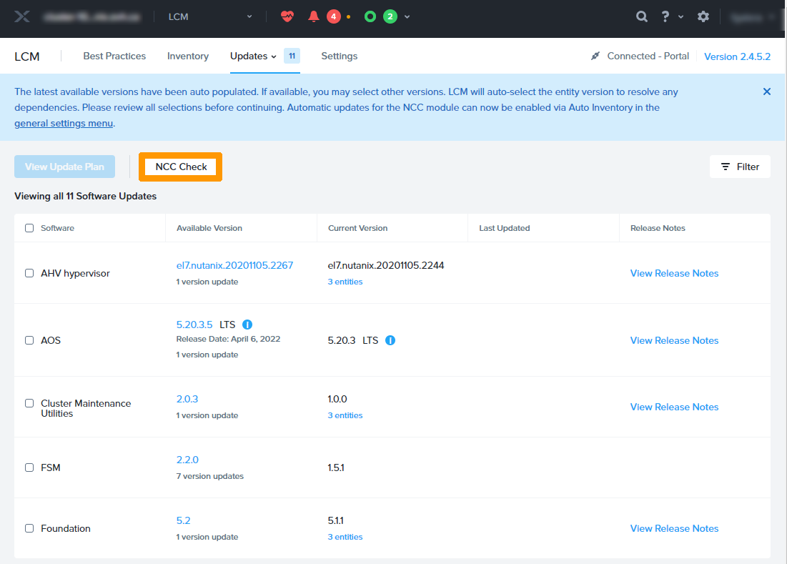

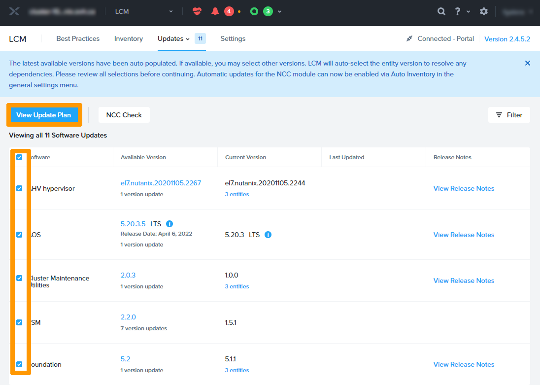

Select all available updates and click View Update Plan.

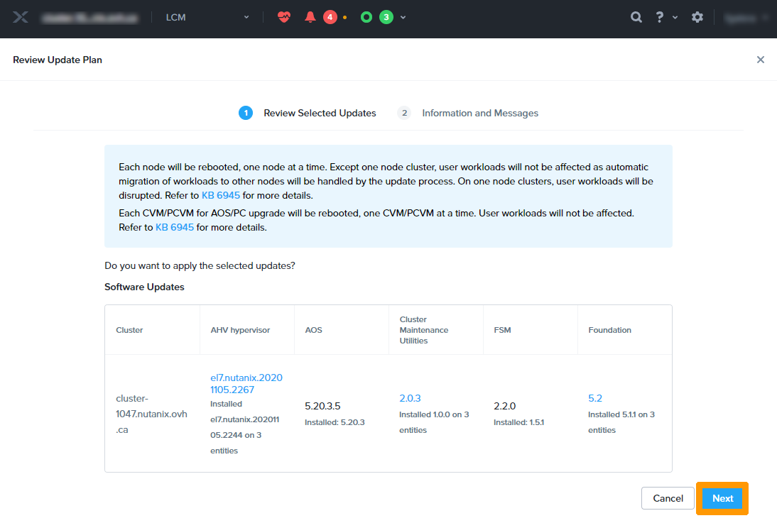

Click Next.
Click Apply # Updates.
Note: The update process can be very long, it is possible that some slowdowns occur but no downtime is to be expected.
