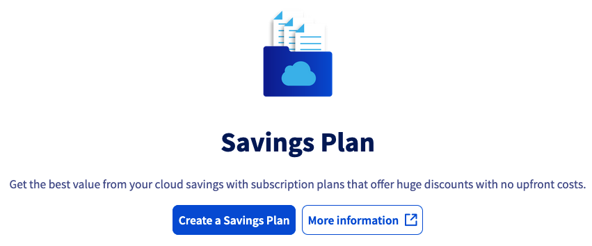

Create a Savings Plan
You can create your Savings Plan for the type of resource you want by following these steps:
Click the Create a Savings Plan button.

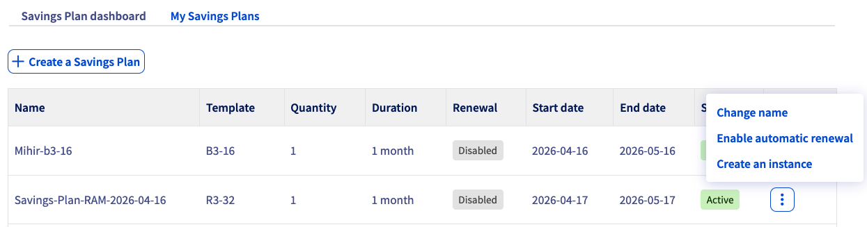

Modifying a Savings Plan
In the OVHcloud Control Panel, clicking the more options ⋮ button to the right of your plan gives you the option to:
- Edit the name of the Savings Plan,
- Activate/deactivate its automatic renewal, and
- Create an instance to be included in your plan.

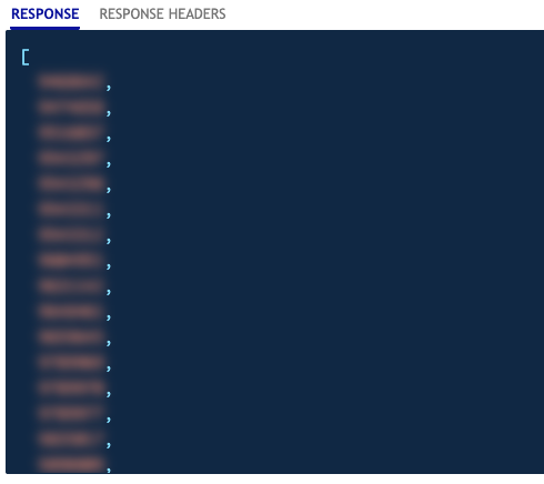

First, find the ID of your service in the list of your services, which can be obtained via the following endpoint:
You will obtain a list containing the ID of your services as follows:

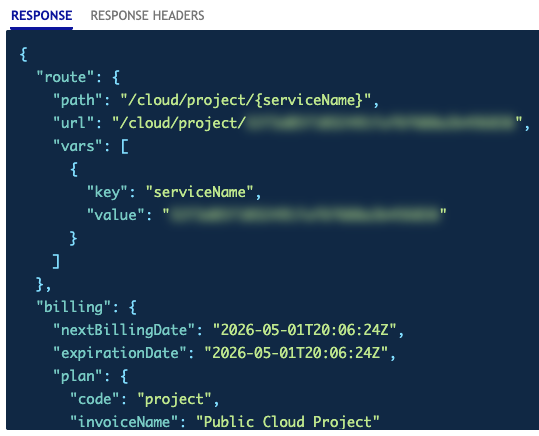

You can use this route to check whether the service corresponds to the Public Cloud project concerned:
You'll get a list containing the details of your service as follows. Check that it's the right project, using the vars.value field:

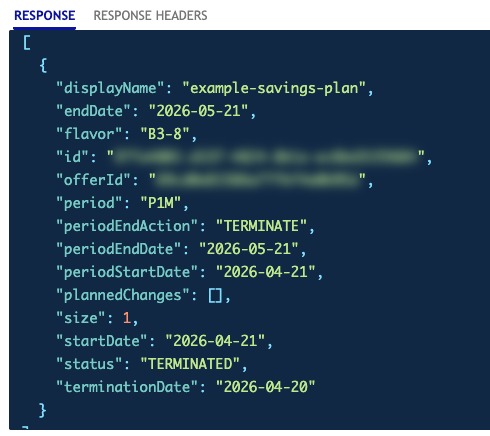

You can find the ID of your Savings Plan in the list of your Savings Plans obtained via this endpoint:
You get a list of Savings Plans as follows:
Then look for the Savings Plan concerned in the list and copy its ID.
