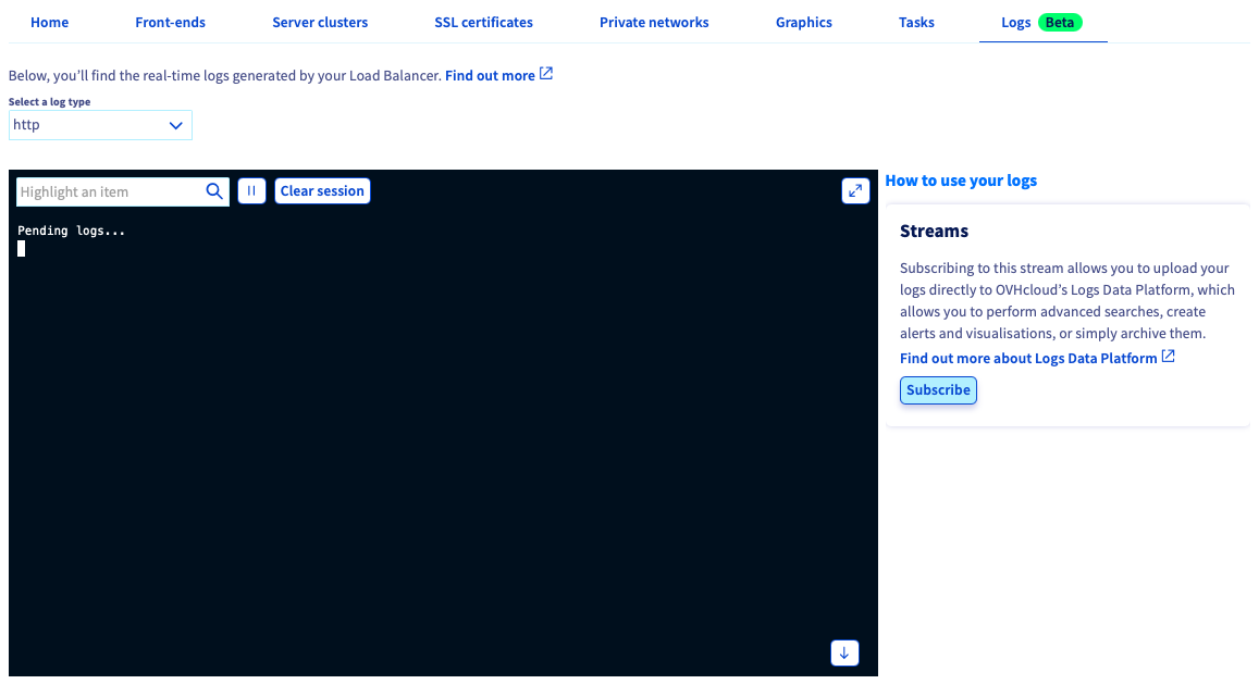

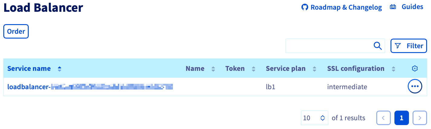

From the OVHcloud Control Panel, navigate to and click on your Load Balancer service name via the Network and Load Balancer menus.

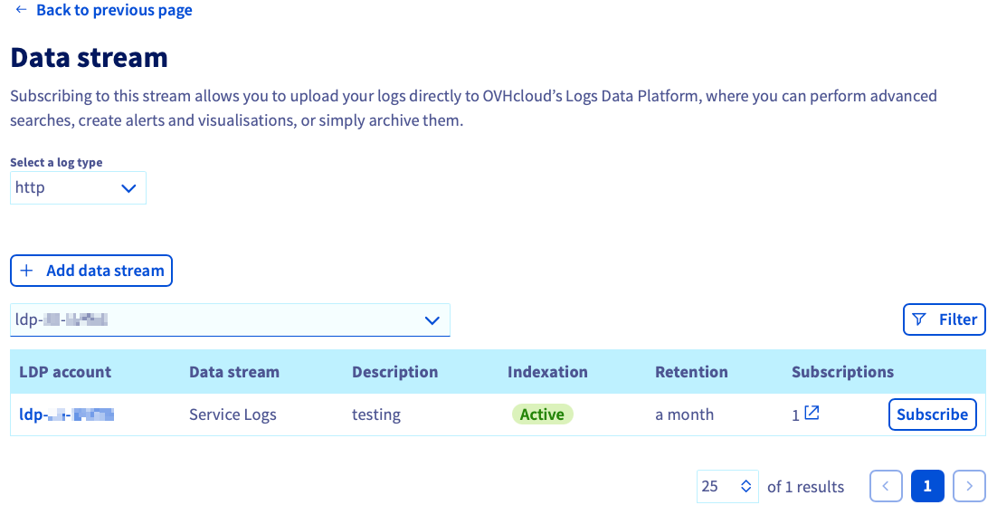

Choose the Logs tab and click the Subscribe on the right-hand side of the screen.
Select a log type and the Logs Data Platform service to which you wish to push logs.

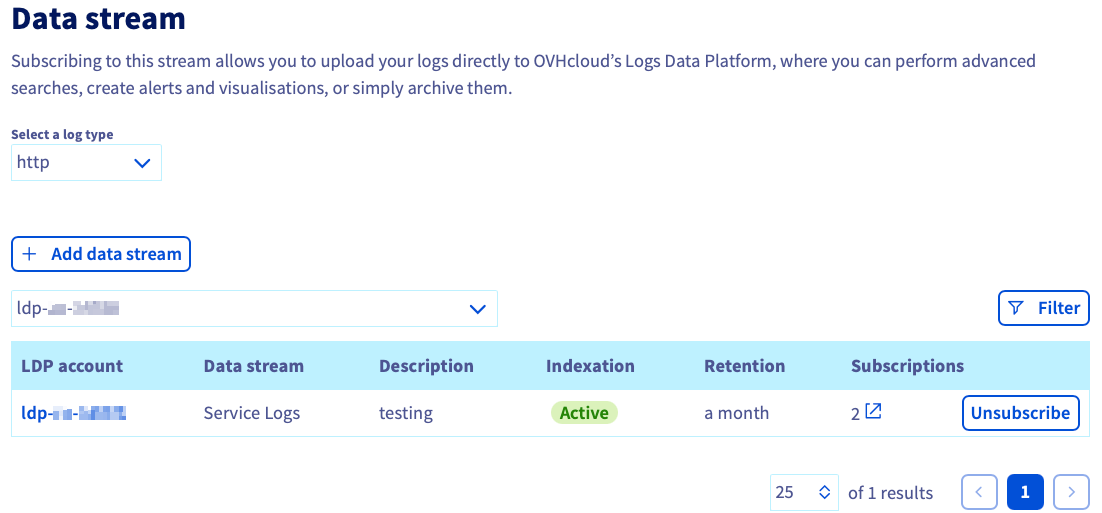

Via the OVHcloud Control Panel
To delete your subscription, simply click the Unsubscribe button to the right of your stream.
