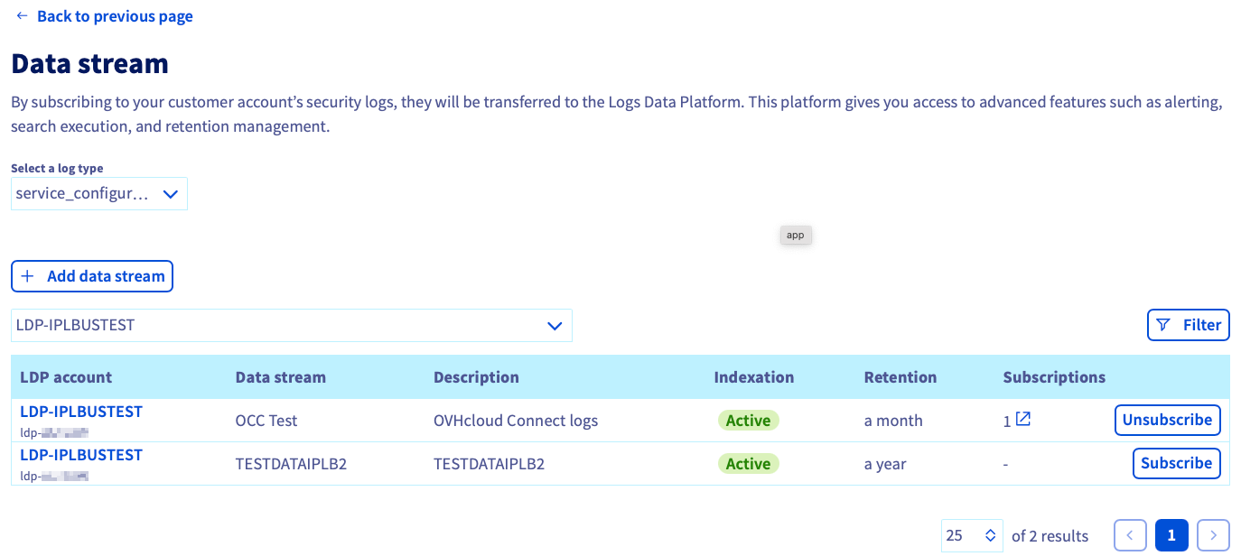

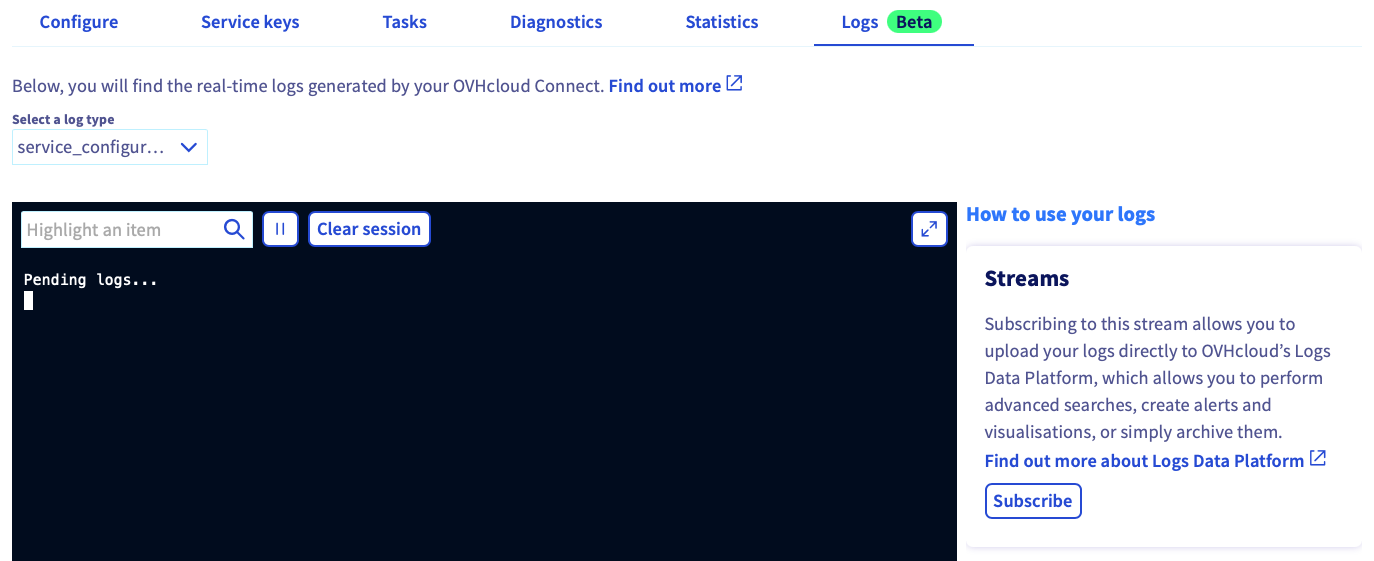

From the OVHcloud Control Panel, select your OVHcloud Connect service via the Bare Metal Cloud and Network menus.
Click on the Logs tab, followed by the Subscribe button on the right-hand side.
Select a log type and the Logs Data Platform service to which to send the logs. Click Subscribe to the right of the LDP stream you want to use.

To delete your subscription, simply click the Unsubscribe button to the right of your stream.
