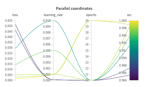

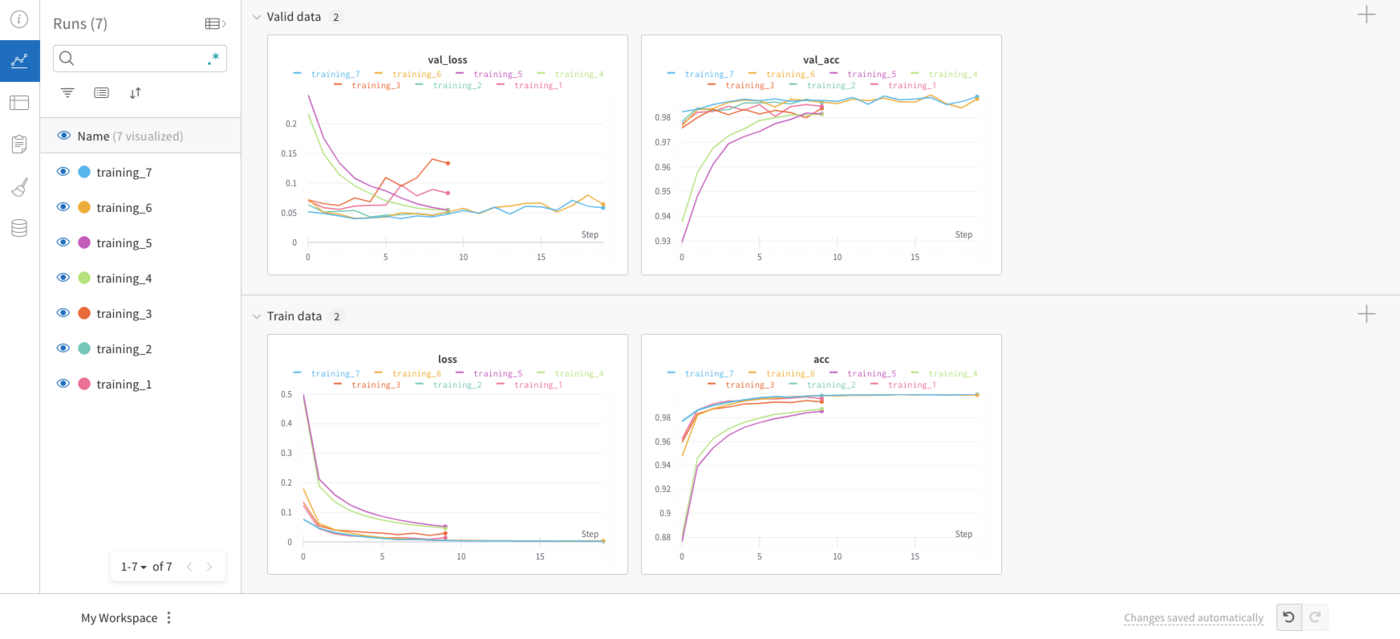

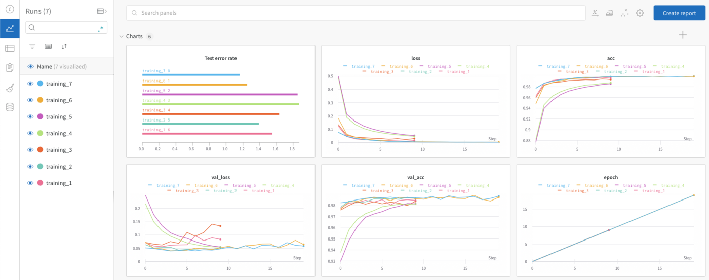

The aim of this tutorial is to show how it is possible, thanks to Weights & Biases, to compare the results of trainings according to the chosen hyperparameters.
For example, you can display the accuracy and loss curves for your valid and train data. These metrics will be displayed for each epoch of each training.
You can then compare your trainings using the Parallel coordinates graph type:

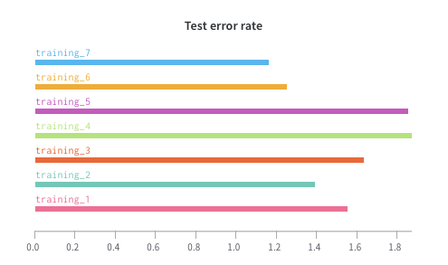

You can also compare the Test error rates:

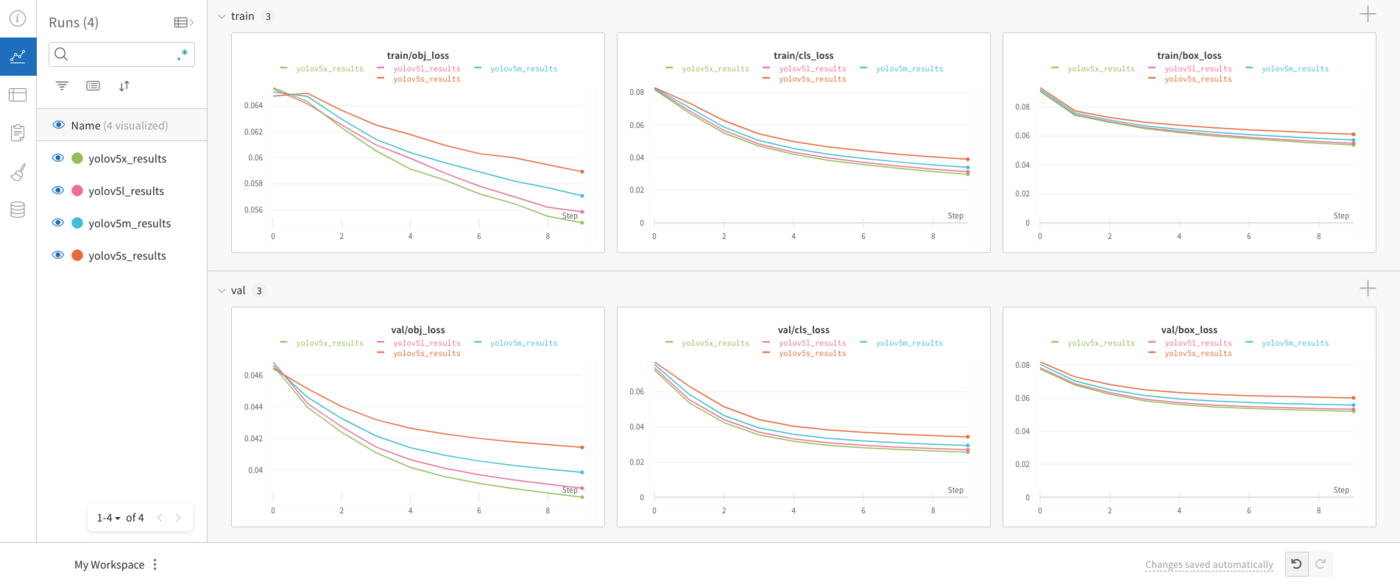

Notebook using PyTorch and Weights & Biases is based on YOLOv5 and the COCO dataset
The notebook using PyTorch and Weights & Biases is based on YOLOv5 and the COCO dataset. To access it, follow this path:
ai-training-examples > notebooks > computer-vision > object-detection > miniconda > yolov5 > weights-and-biases > notebook_Weights_and_Biases_yolov5.ipynb

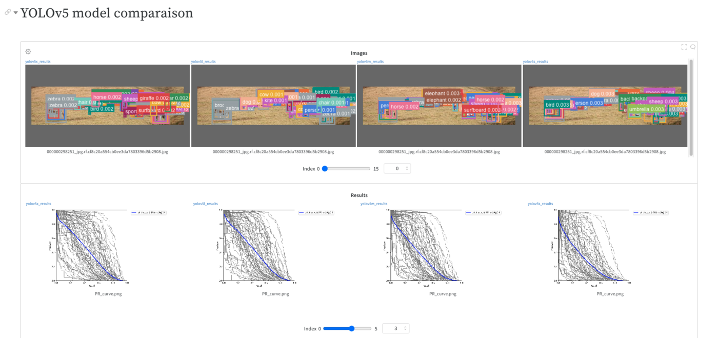

The aim of this tutorial is to show how Weights & Biases can be used with the YOLOv5 real-time object detection framework. In order to achieve this, the YOLOv5 s, m, l and x models performance will be compared on the COCO dataset for the same number of epochs.

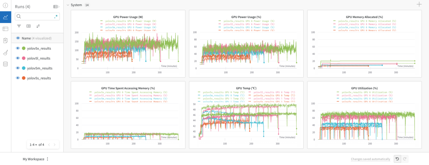

Another possibility with Weights & Biases is to display the use of your computing resources:
You can also create your report with your curves and images and share it with your team!
