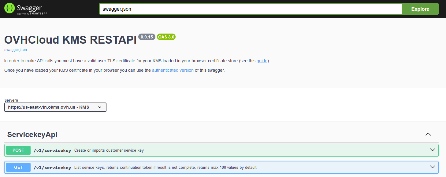

Using the KMS API via the Swagger UI

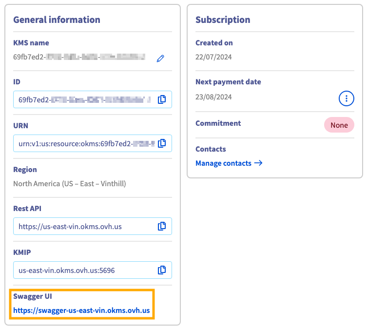

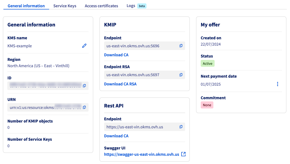

You can access the swagger for your KMS by clicking on the link in the OVHcloud Control Panel in your KMS dashboard.
You will land on the non-authenticated version of the Swagger UI that is meant for API documentation purposes. If you want to use the Swagger UI to make requests on your own KMS, you will need to switch to the authenticated version, whose link is in the description section:
The next steps will guide you on how to authenticate.

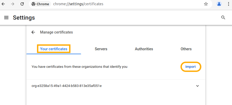

Importing your KMS credentials into the browser
To access the authenticated Swagger UI, you need to load your KMS access certificate into the browser Certificate Manager.
For that, it is required to convert it to PKCS#12 format. PKCS#12 is a binary format for storing a certificate chain and private key in a single, encrypted file. It is commonly used for importing and exporting certificates and private keys, especially in environments that require secure transport of these items, such as web servers and client applications.

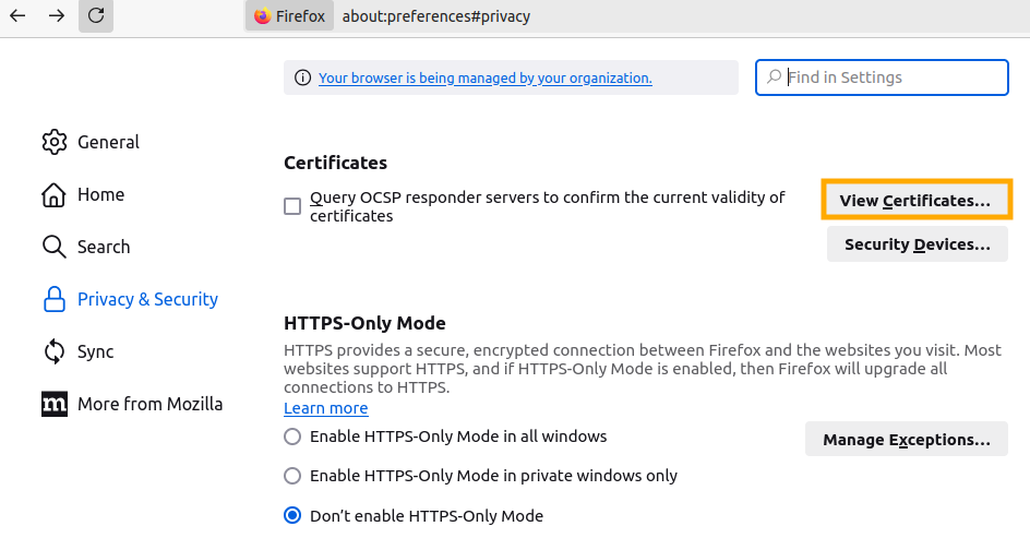

Click the tab for your browser.

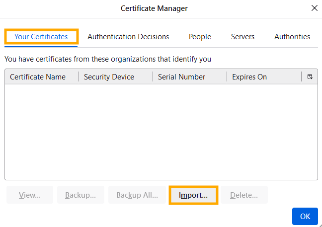

- Type
about:preferences#privacy
into the address bar. - Scroll down until you reach a section named Certificates.
- Click on
View Certificates...
to open the Certificate Manager.
- Go to the tab named
Your Certificates
, thenImport...
and select the location of yourclient.p12
file.
- You will be prompted to enter the password you used during the PKCS#12 file creation.
- After entering the password, your certificate will be imported and ready for use.

- Type
chrome://settings/certificates
into the address bar. - Go to the
Your certificates
tab. Click onImport
and select yourclient.p12
file.

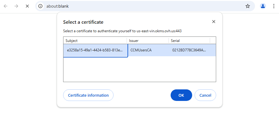

Accessing the authenticated Swagger UI
Once your certificate is loaded into your browser, you can go to the authenticated Swagger UI.
NOTE: If the authenticated Swagger UI does not load after you select the correct certificate, refresh the page.
You will be prompted to identify yourself with a certificate. Select the previously imported PKCS#12 certificate in the drop-down list.
In Firefox
In Chrome/Chromium

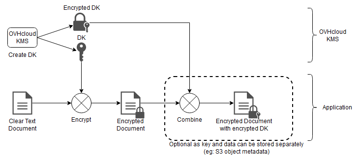

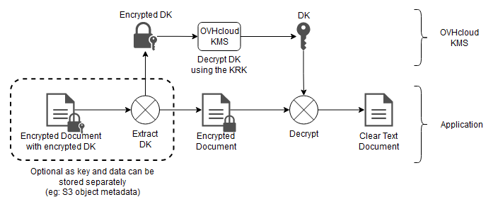

Encryption with a Data Key (DK)
For better performance, you can generate a Data Key (DK) from a Symmetric Key (AES) to use from your application. The AES key used must have been generated with the "wrapKey, unwrapKey" operations.
You can generate a DK using the following API:
API Call | Description |
POST /v1/servicekey/{id}/datakey |
Generate a DK derived from a CMK |
The API expects the following values:
Field | Value | Description |
name | string | Key name |
size | Integer | Key Size (64-4096) |
Data Key generation example:
The API will then return the Data Key:
- key: encrypted key encoded in base64. This information must be stored with the encrypted data and will be used for decryption by the KMS.
- plaintext: plain key encoded in base64. This information must be deleted once the encryption is complete and must not be backed up.
The use of the Data Key is then done through encryption algorithms like AES-GCM which is not covered by this documentation.
Conversely, you can retrieve the decrypted version of a Data Key via the following API:
POST /v1/servicekey/{id}/datakey/decrypt |
Decrypting a DK |
key | string | Encrypted Data Key |
And it returns the decrypted Data Key in a plaintext field.
