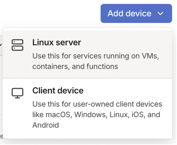

- Go to the
Devicestab and clickAdd Device. - Select
Linux serveras the device type.

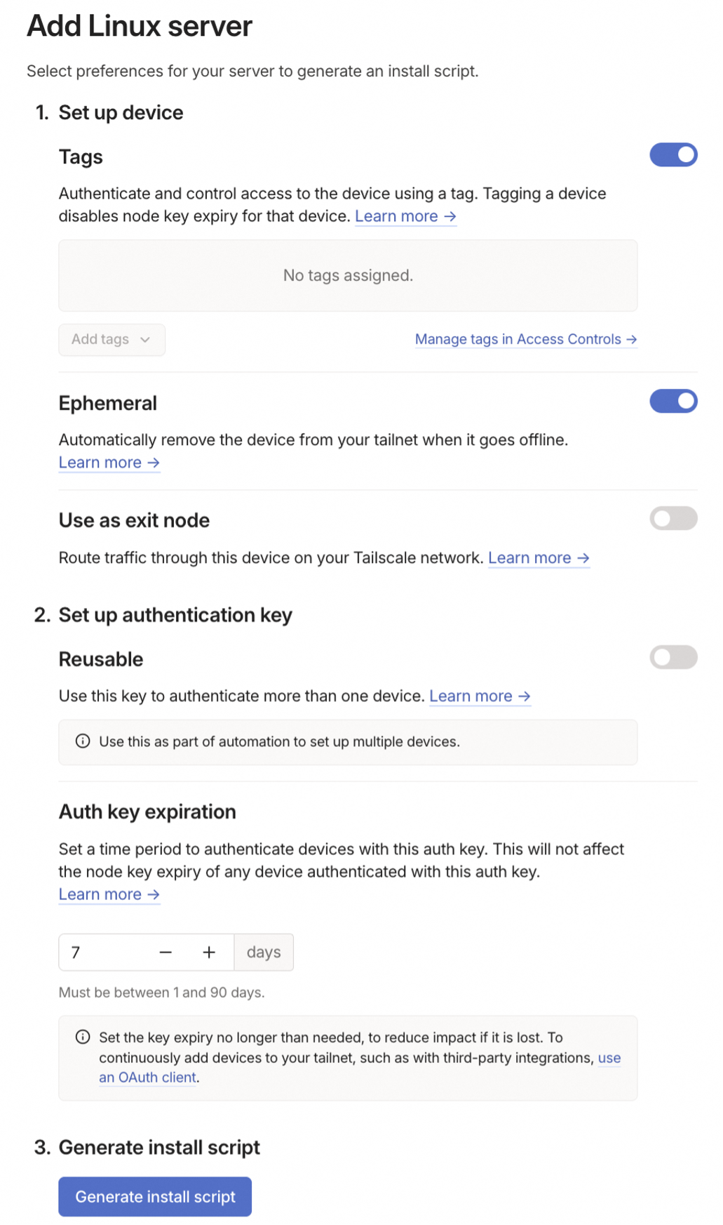

- Enable
ephemeral nodesto ensure that nodes are automatically removed from the network when their corresponding server is deleted.
- Copy the provided install script for later use.

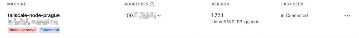

- Log in to the Tailscale admin panel to approve the new node by visiting the Tailscale login page.
- Approve the node using the menu on the right (with the more options
...button).
- Once approved, you will see a success message in the terminal:

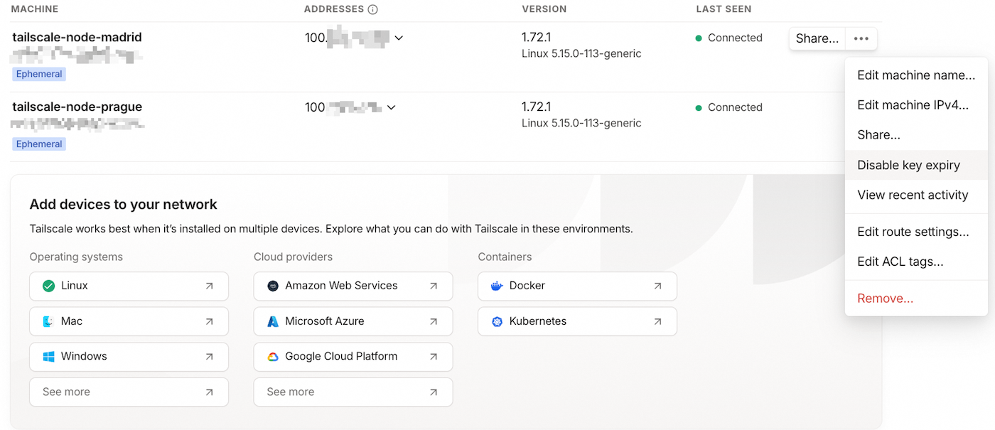

Step 7 - Manage Key Expiry
Tailscale nodes are assigned keys, and these keys can expire. If your nodes are expected to remain in the network for a longer period, you may want to disable key expiry. You can do this in the Tailscale admin panel, depending on your security and access requirements.
