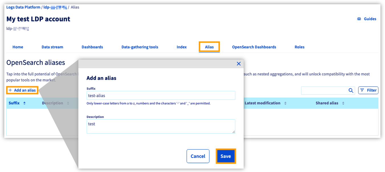

- Log in to the OVHcloud Control Panel and access your Logs Data Platform service.
- In the Alias tab, click on the
+ Add an alias
button. - Choose a name and define a description for your alias.
- Save the entry by clicking the
Save
button.

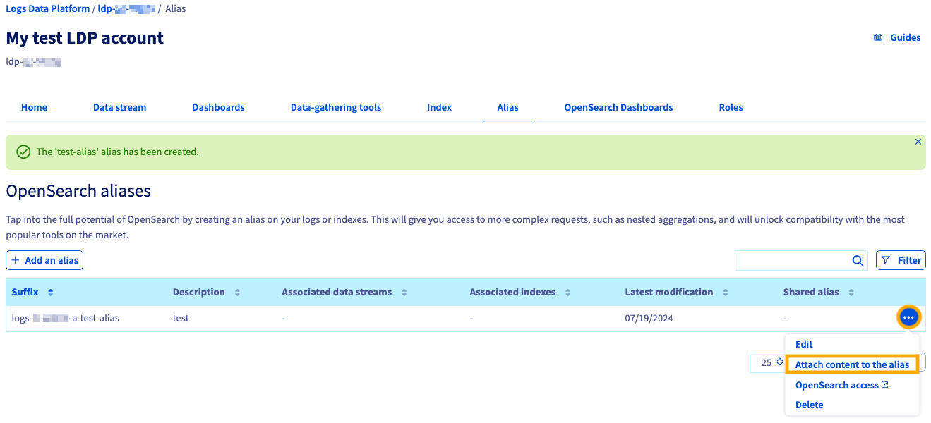

- Once the alias has been created, use the more options
button to the right and selectAttach content to the alias
option.
- Define the Graylog streams you want to associate with your alias.
