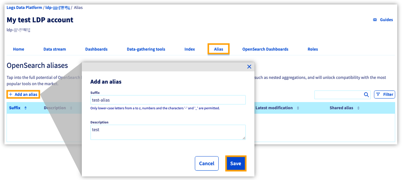

To create an alias in the management interface, go to the alias tab of your Logs Data Platform account and click + Add an alias.
Choose a name, add a description, and click Save.

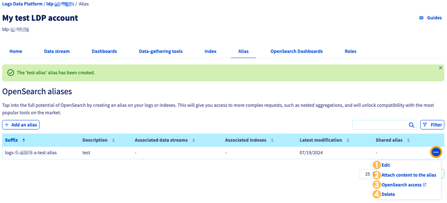

Once your alias is created, you can use the more options ... button to manage it.
From this menu, you can:
- Edit the description for the alias.
- Attach and detach streams and/or indices to the alias.
- Access the alias via OpenSearch's web UI.
- Delete the alias.

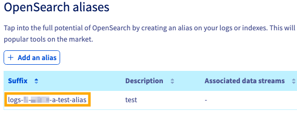

https://<your_cluster>.logs.ovh.com:9200. - An index name. This is your alias name, found on the left column of your alias homepage like in the following picture. It should look like this:
<ldp_service_name>-a-<alias_name>. - A user: the Logs Data Platform service name associated with the index (the same as the one you use to connect to Graylog).
