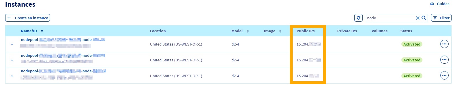

Get your Kubernetes cluster nodes' IP addresses by selecting Instances under Compute in the menu on the left.
Following the related documentation on how to authorize the suitable IP addresses, add your Kubernetes cluster node IPs to the authorized list.
