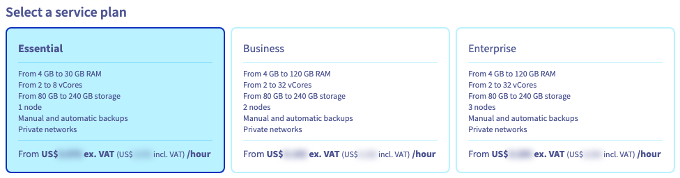

Choose the plan that best fits your needs. The use of private networking with services is available with all plans.

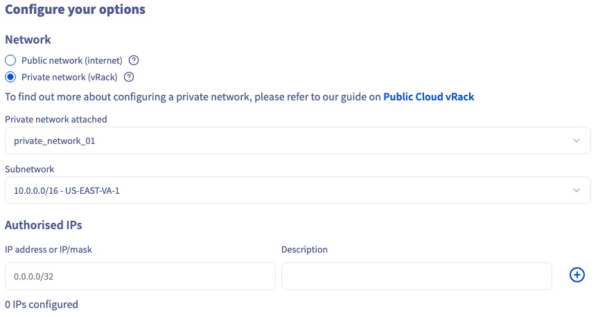

Select Private from the Network Type list, then choose your private network.
From the Subnetwork list, select the 10.0.0.0/16 - YYY. The YYY value is the name of the data center you chose.

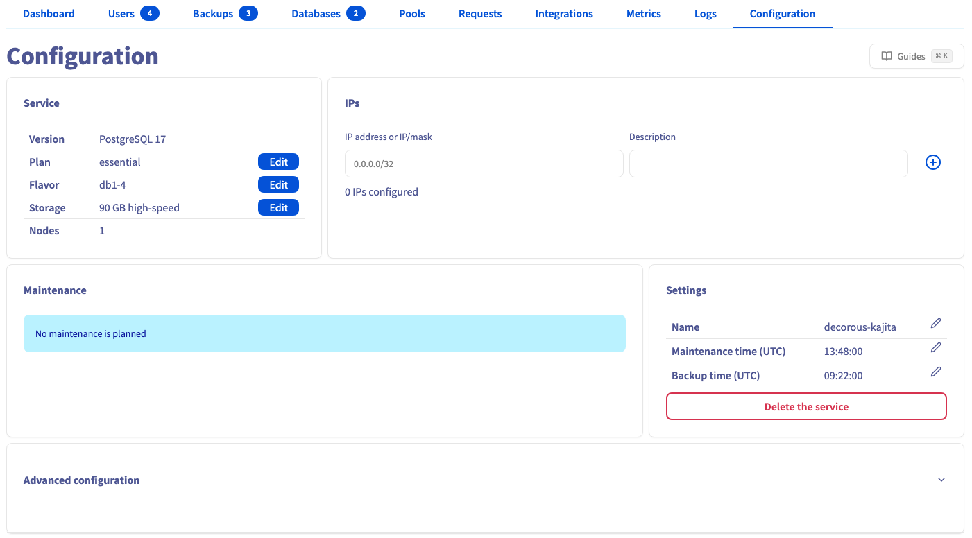

Follow the Configure your [___] instance to accept incoming connections guide of your selected engine type (available here) to configure your service after installation, while taking note of the information in the boxes below.
In the IPs panel, authorize the whole private network, as defined in previous steps, and click +.
