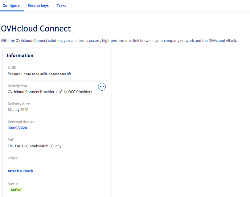

Log in to the OVHcloud Control Panel, go to the Bare Metal Cloud section and click on Network. Next, open OVHcloud Connect and click on your solution.

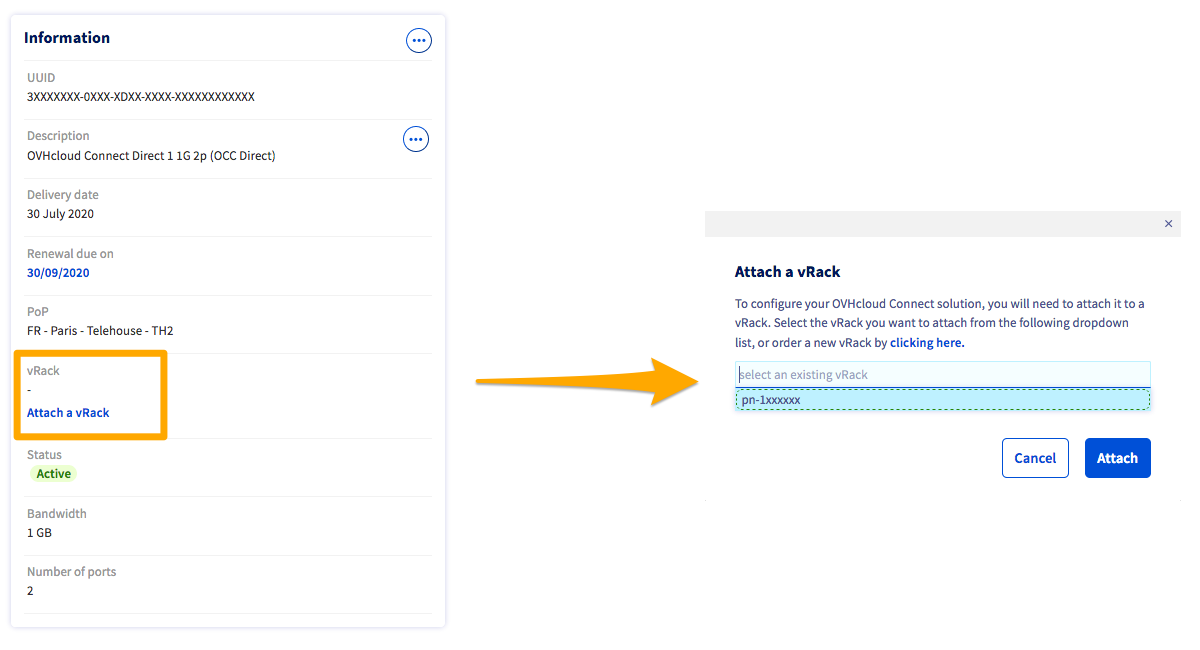

Step 1: Associating a vRack
You will need to link a vRack to your solution first. Click the Attach a vRack button and select an existing vRack from the drop-down menu.
A message will confirm the vRack association.

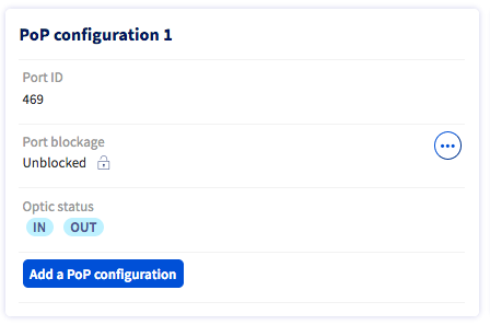

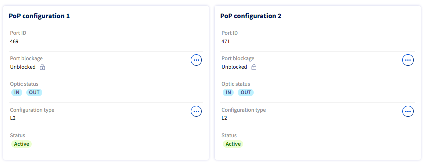

Configuration

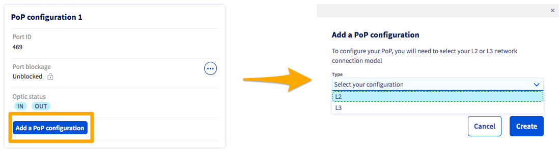

Once you have linked your vRack, two PoP configuration menus will appear. Click the Add a PoP configuration button in the first menu, select L2 from the drop-down menu, then confirm.
The L2 configuration will then be enabled in the two PoP configuration menus.

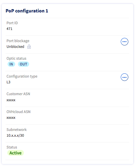

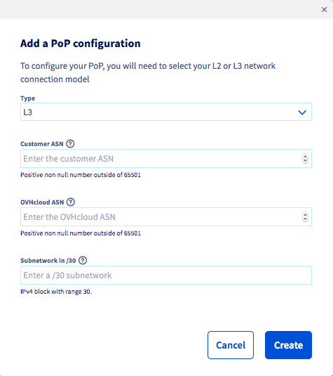

Configuration L3
Once you have connected your vRack, click Add a PoP configuration and select the L3 configuration from the drop-down menu.
You will then need to enter the following:
| Information | Description |
| Customer ASN | Your AS BGP number, which is configured on your router located in the PoP |
| OVHcloud ASN | The OVHcloud AS number that will be configured on the OVHcloud Connect routers located in the PoP |
| Subnetwork in /30 | A size /30 IPv4 block, used for the link between your router and the OVHcloud Connect router located in the PoP |
The PoP configuration menu will then appear.
You can also add a second PoP L3 configuration via the second PoP configuration menu.

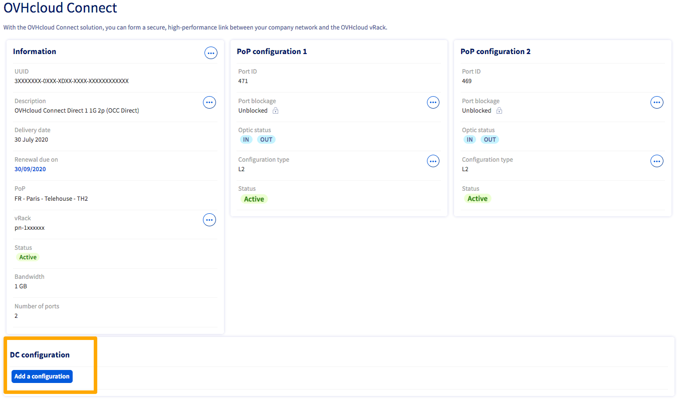

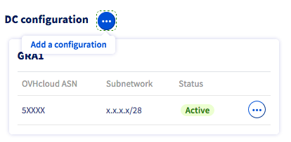

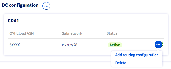

Step 3: Adding a data center configuration
Configuration

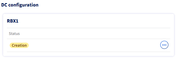

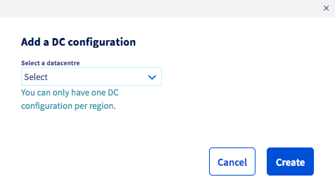

When your PoP configuration is active, click Add a configuration under the DC configuration menu. Select a data center from the drop-down menu and confirm.
The DC configuration will then begin.

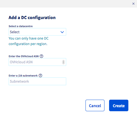

Configuration L3
When your PoP configuration has been set, click Add a configuration under the DC configuration menu.
Select a data center from the drop-down menu, then enter the information required.
| OVHcloud ASN | The OVHcloud AS number that will be configured on the OVHcloud Connect routers located in the AZ. This number may be different from the ASN chosen for the PoP |
| A /28 subnetwork | A private subnetwork configured in your vRack in the selected AZ. This can be an IPv4 block of size /28 or higher |
You can add additional data center configurations by clicking on the ... button, then Add a configuration.

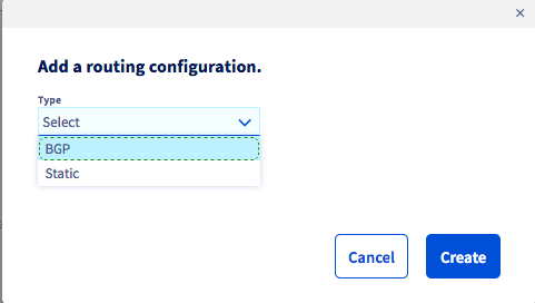

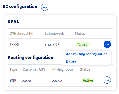

Adding a routing configuration
Click on the (...) button on the desired data center then on Add routing configuration.
Then choose the routing type between Static and BGP.

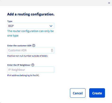

If you choose the type BGP, then enter the required information.
| Customer ASN | Your AS BGP number, which is configured on your router located in the AZ |
| IP Neighbor | IP address of the BGP neighbor of your router in the AZ. This address must be part of the subnetwork specified in the AZ Configuration section |

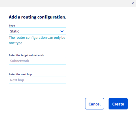

If you choose the Static type, enter the required information:
| Target Subnetwork | A prefix using CIDR notation |
| Next hop | An IP address acting as gateway in the subnetwork range |
You can add multiple routing configurations within the same data center. The configuration type (BGP or Static) chosen for your first routing configuration will then apply to the next configuration on the same data center.

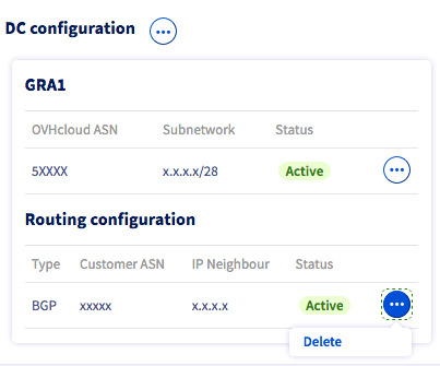

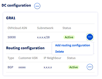

Deleting a routing Configuration
To delete a routing configuration, click the ... button on the routing configuration to delete, then click Delete.
Deleting a DC configuration
To delete a DC configuration, click the ... button on the DC configuration to delete, then click Delete.
Deleting a DC configuration will delete the related routing configurations.

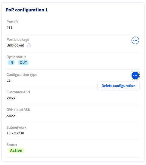

Deleting a PoP configuration
To delete a PoP configuration, click the ... button on the PoP configuration to delete, then click Delete configuration.
Deleting a PoP configuration will delete the related DC and routing configurations.
