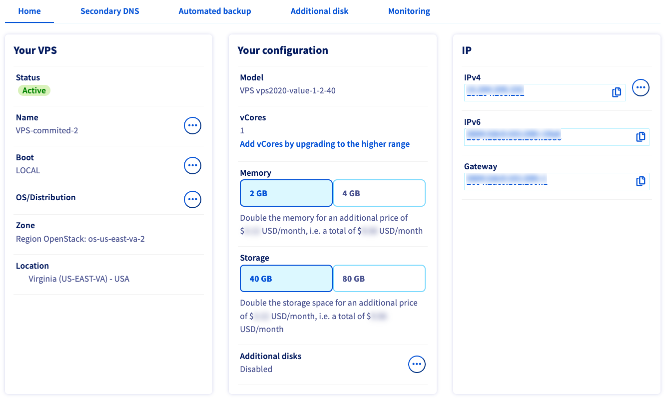

Log into the OVHcloud Control Panel and navigate to your VPS via the Bare Metal Cloud and Virtual private servers menus.
The IPv6 address and the IPv6 gateway assigned to your server will appear in the IP panel of the Home tab. Once you have copied them, continue with applying the IPv6 configuration.

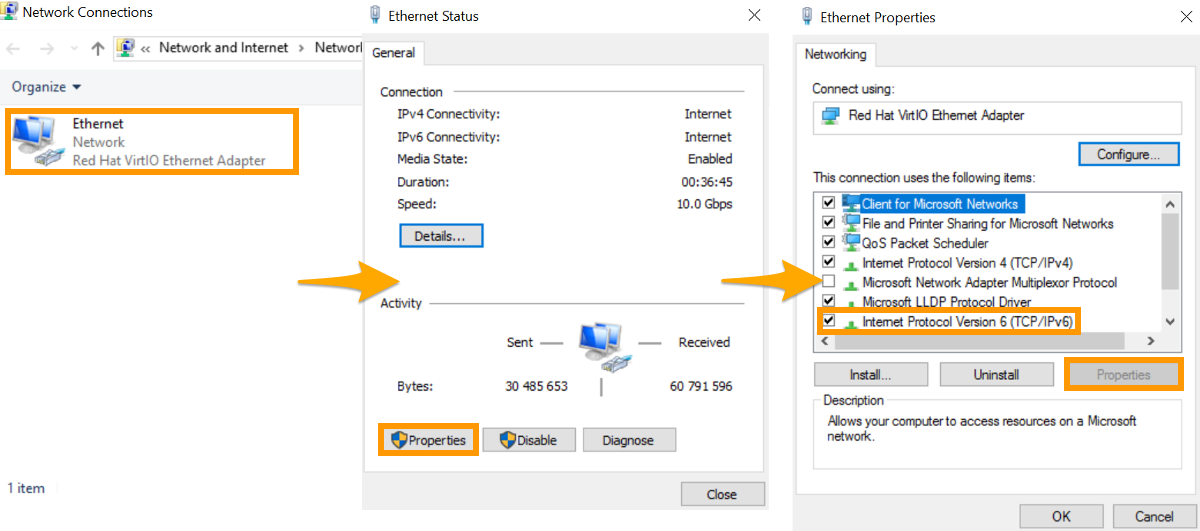

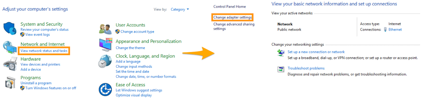

By default, IPv6 is not configured on Windows Servers. To enable it, open the Control Panel and click on View network status and tasks, then on Change adapter settings.
Click on Ethernet to open the settings and click on the Properties button to view the Ethernet Properties.
Select Internet Protocol Version 6 (TCP/IPv6), then click on the Properties button.

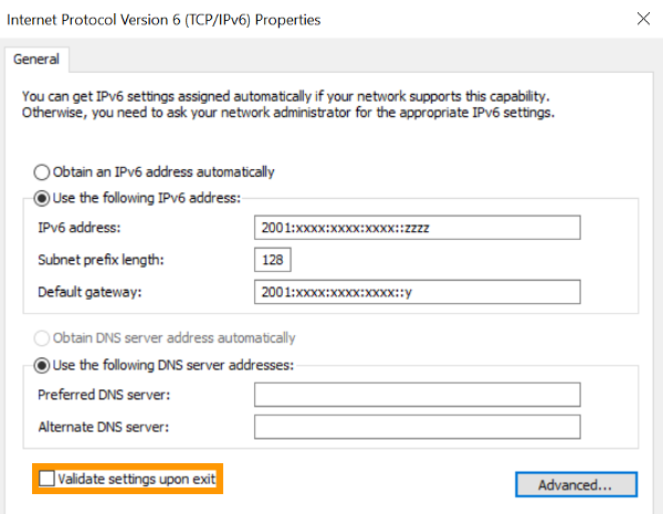

In the IPv6 Properties window, select Use the following IPv6 address. Enter the IP addresses that you have retrieved in the first step.
You also have the option of entering the IPv6 DNS resolvers of your choice under Use the following DNS server addresses. This is not mandatory if the DNS resolvers of the IPv4 configuration are already functional.
Finally, tick the Validate settings upon exit box and click the OK button to validate your changes. An error message may appear if the specified gateway is not on the same IPv6 subnet (/128 and /64 for example). You can ignore this message and continue to the next step regardless.
