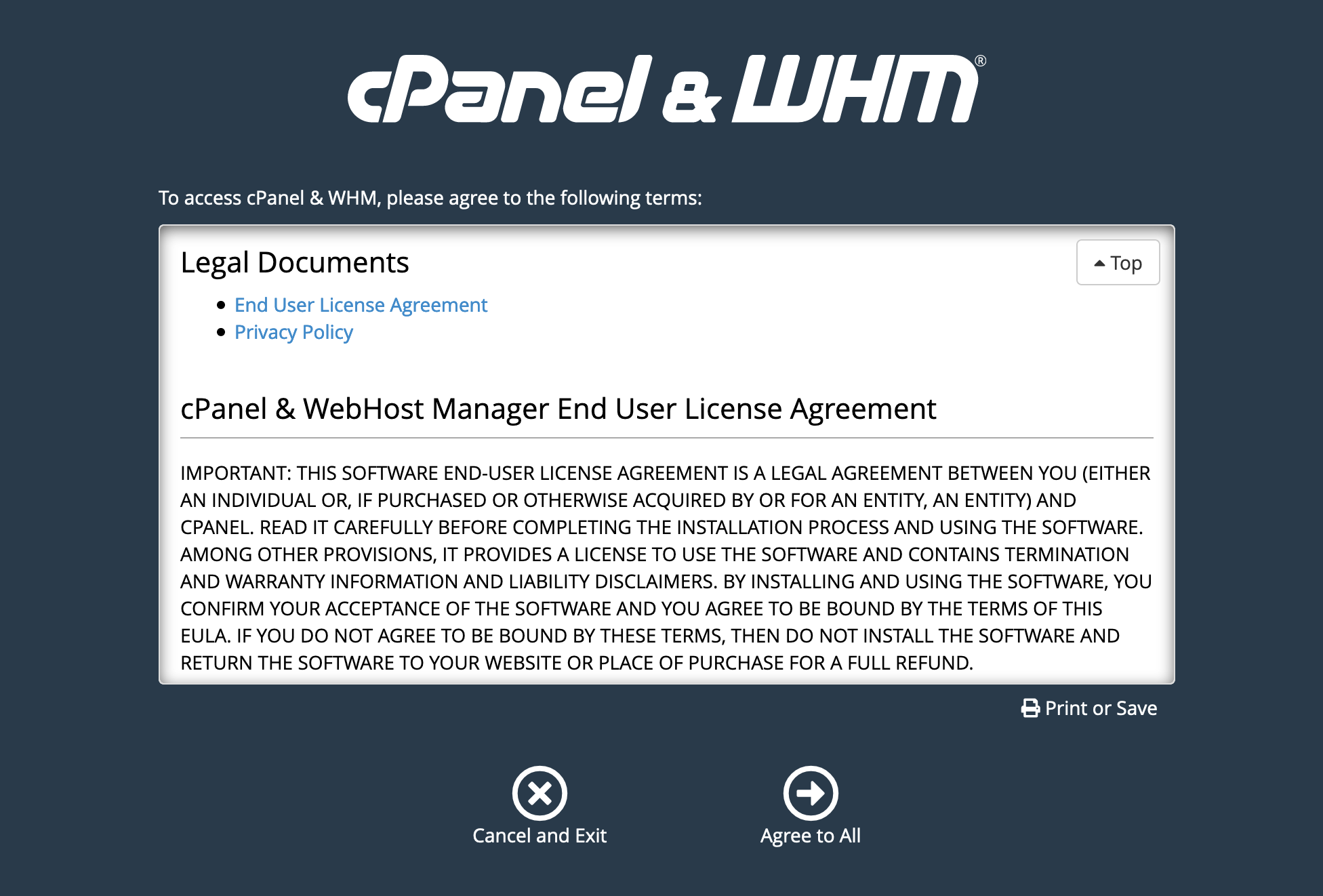

Step 1: Read and accept the terms of cPanel

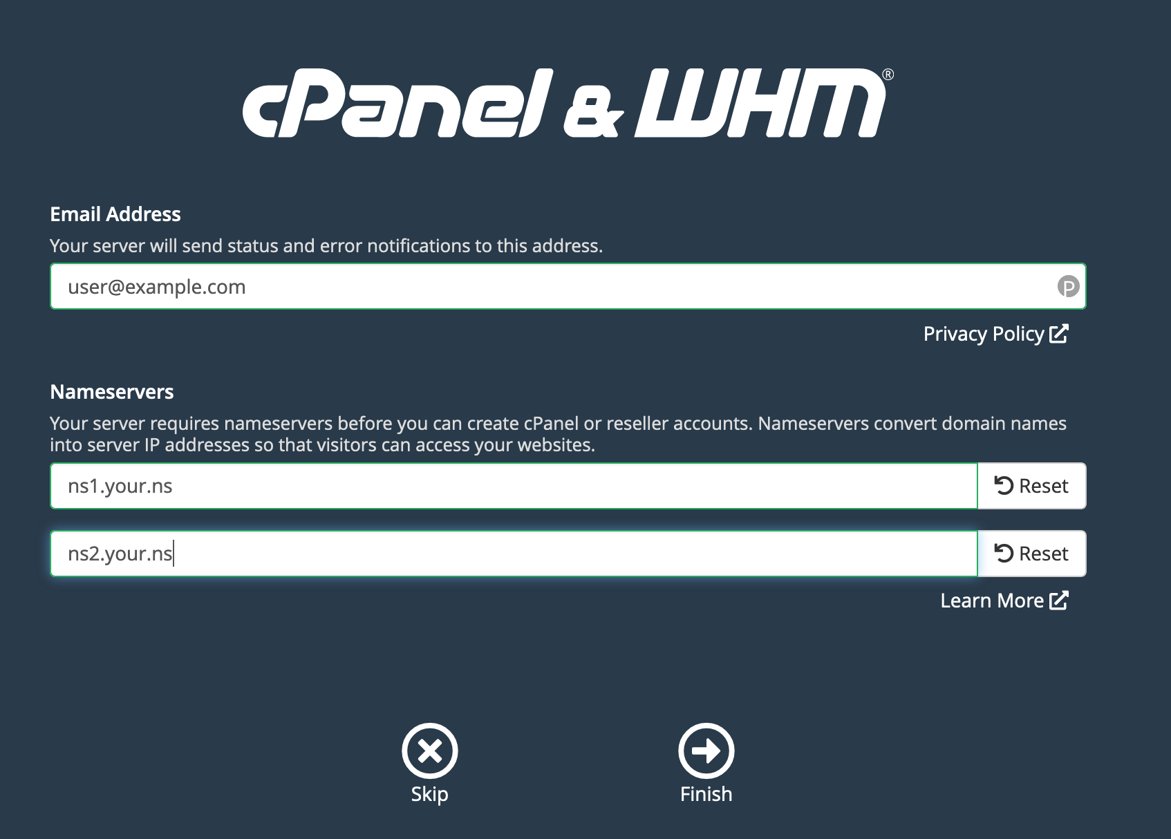

Step 2: Provide your email and nameservers you wish to set on the VPS

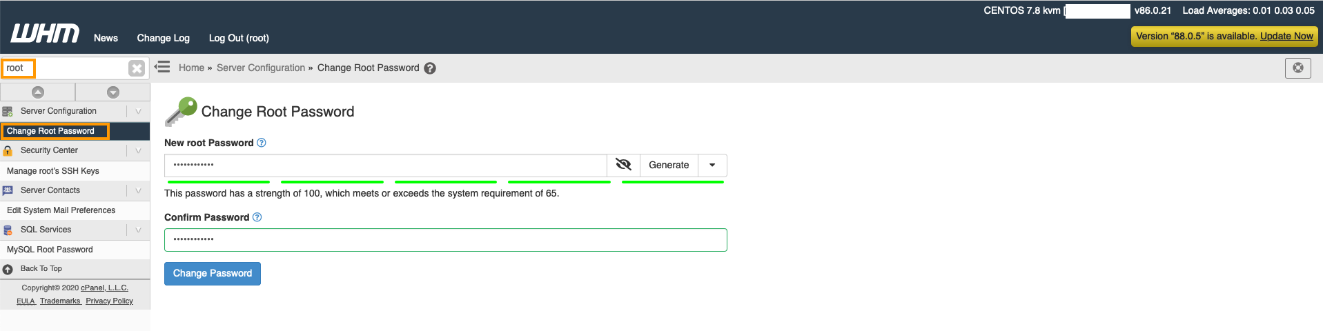

Step 3: Set the root password
Now you should be able to login to WHM and SSH using the root user with the password that was just set.

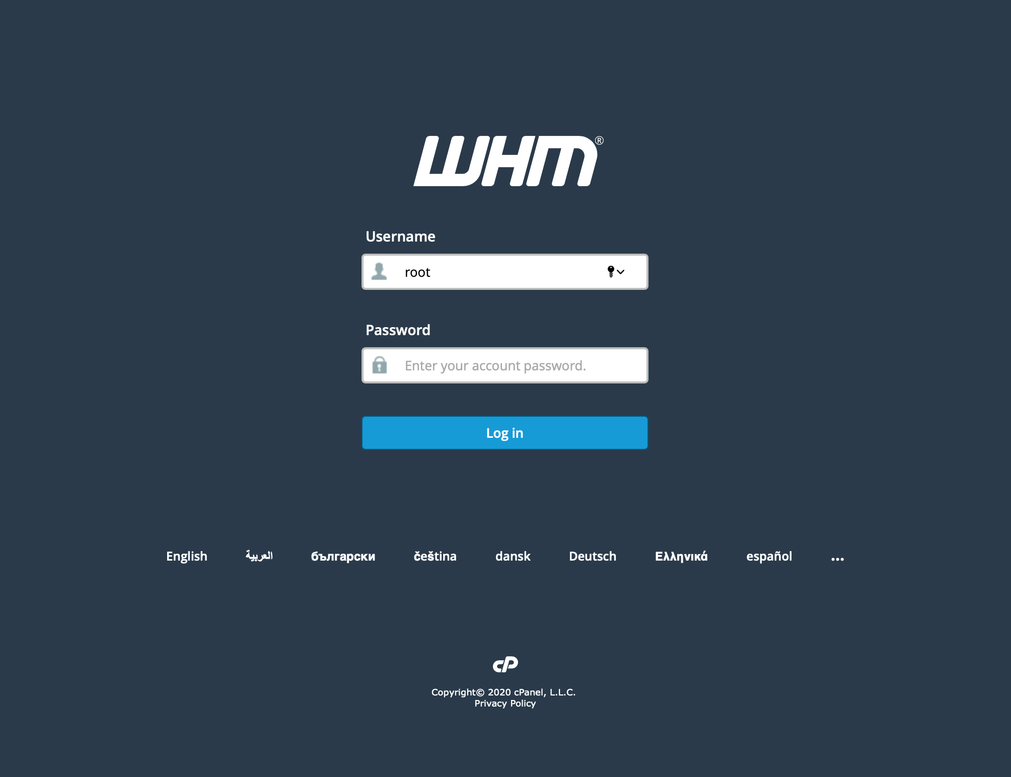

In the below screenshot we use WHM as an example. Enter the username "root" and the password you set for this user.
You have now successfully accessed WHM and cPanel.
