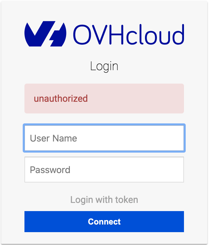

field corresponds to the address to paste in your browser to access the notebook. If you're already logged in with your browser, then it will display the notebook. Otherwise, you will get a page like this:

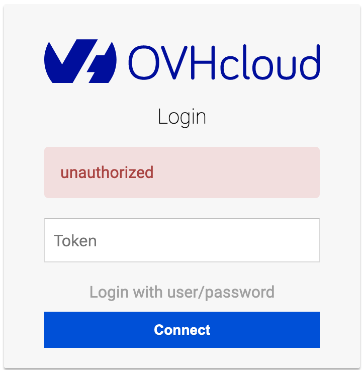

You can try in a private navigation window to get the login page and test the token. Clicking on Login with token
leads to this page:
Paste the token we created earlier into the text box and click on Connect
. You should now see your notebook.
