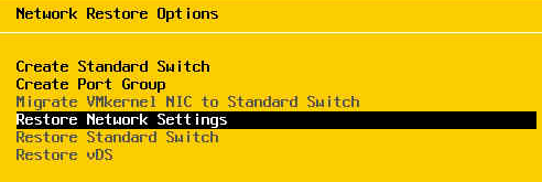

Version 7.0 or newer
The following procedure applies only to versions 7.0 and later. From this release on, the state.tgz file is encrypted. You will need to reboot the network from the Direct Console menu via your KVM or IPMI.
Please refer to the screenshot below:

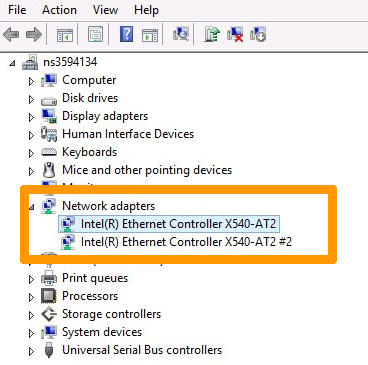

After the motherboard is replaced, the server cannot be reached until you manually change the MAC addresses through Device Manager.
There are two methods:
Via IPMI/KVM
1. Log in as an administrator from the IPMI/KVM interface.
2. Open the Run utility (Windows logo key + R), and through the run prompt, run the devmgmt.msc command:
3. Open Network adapters and select the adapter corresponding to eth0.
4. Right-click on Properties > Advanced.
5. Locate Locally Administered Address.
6. Enter the new value for the MAC address (numbers only, no spaces).

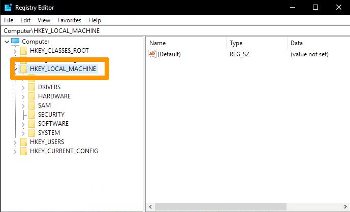

Via WinPE
1. Restart the server in WinPE mode.
2. Issue the regedit command at the run command prompt.

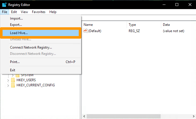

3. Load the local registry through the one available in WinPE, then click HKEY_LOCAL_MACHINE:

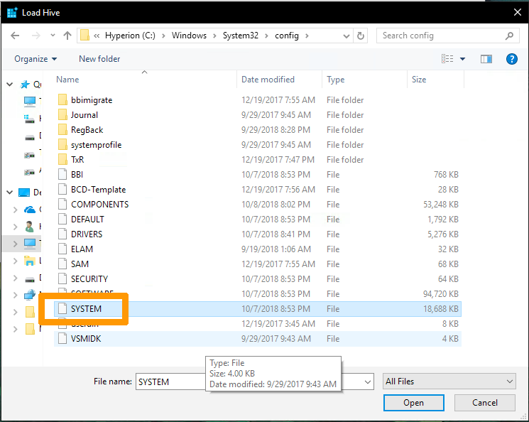

4. Then click Load Hive....
C:\.5. Locate the SYSTEM registry.
6. You will be asked to enter a name. For example, you can choose OVH_TEST.

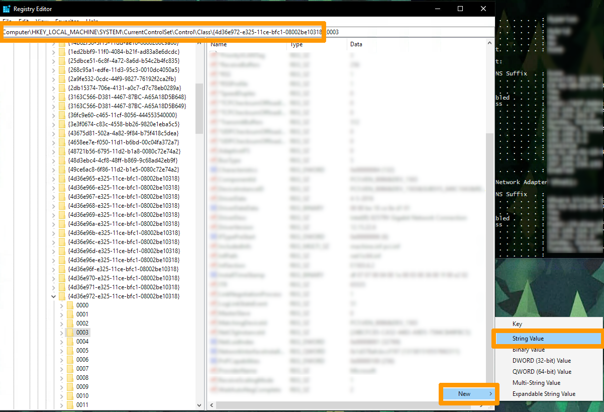

7. Locate the following registry value:
NOTE: As long as we are on WinPE, the value CurrentControlSet should be equal to CurrentSet001.
You should see several subkeys named like this: 0000, 0001, etc.
8. Click each subkey to check the DriverDesc value that should match your network interface. You can check the name of your interface from a terminal using the following command:
9. Look in the NetworkAddress registry entries on the right pane and change the value to your new MAC address. If this entry does not exist, right-click in an empty box to create a String with the name NetworkAddress.
10. You will need to unload the registry to apply the recent changes. Click OVH_TEST (created earlier) then click File (in the top left-hand corner) and select Unload hive....

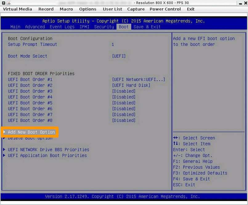

- Use case: the installed system (in this case CentOS 6) is no longer bootable after replacing the disk (no EFI input is visible through the BIOS).
1. Reboot the server to enter the BIOS menu.
The first step involves regenerating the files you need to restore your partition to full operation:
- Go to the BIOS
bootmenu:- Select
Add New Boot Option. - Choose the path to your
Path for boot partition optionand select the file system that contains your boot partition. - Select the
EFI\centos6\bootx64.efifile and chooseCreate.
- Select
The image below is a summary of the actions mentioned above:

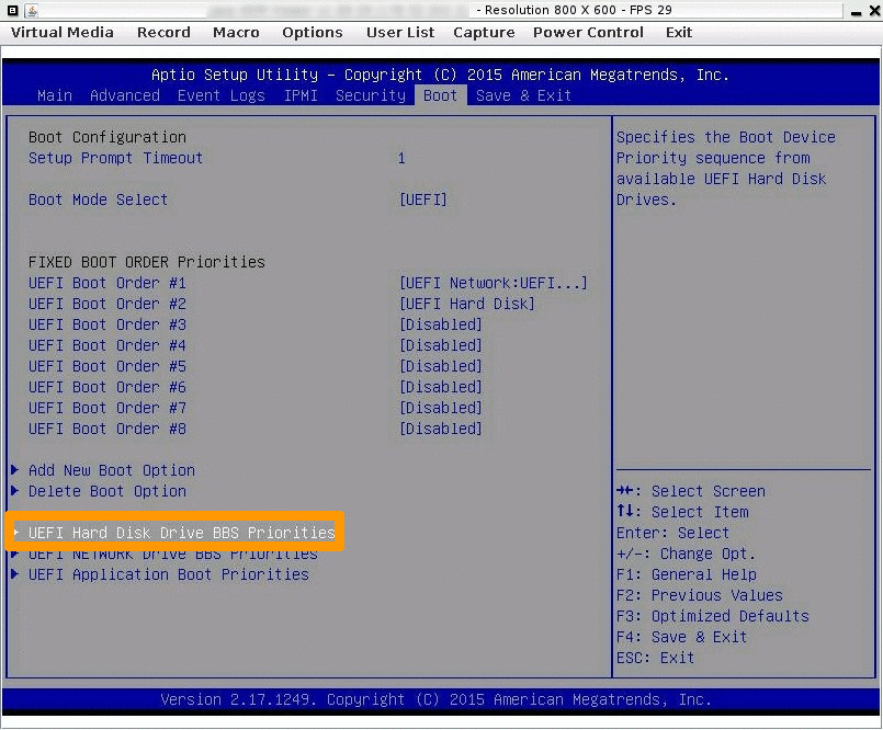

The second sequence is to make the selected partition active in the previous sequence.
- In the BIOS
bootmenu:- Choose
UEFI Hard Disk BBS Priorities. - Choose
UEFI Boot Order #1then selectCENTOS6to position it as the first start choice in the current list.
- Choose
