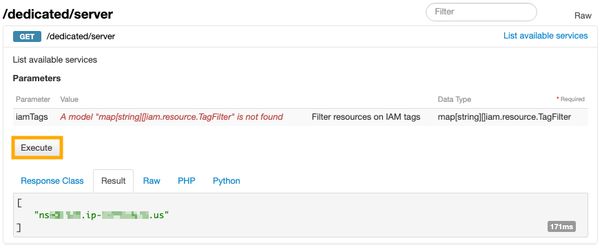

First, access the OVHcloud API and open the /dedicated/server section.
Find the service name
You will need the internal name of your dedicated server to find your Additional IP limit. If you do not know, or know how to find, this information you can use the OVHcloud API or the OVHcloud Control Panel to retrieve it.
In the OVHcloud API, locate the API call below and click Execute.
The result will show the internal name of your service.

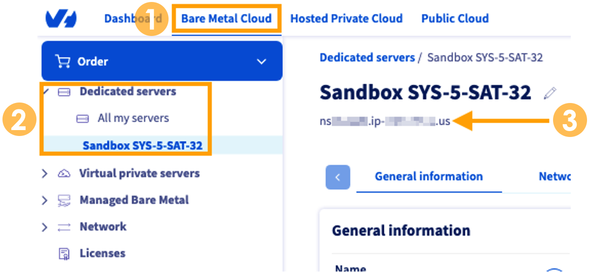

From the OVHcloud Control Panel:
- Select
Bare Metal Cloudfrom the top navigation bar. - Click the
Dedicated serverssection and select your server. - Find the internal server name. Even if you have renamed your server, the internal name will be visible beneath the new one you created.

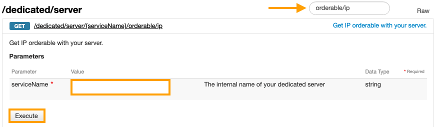

In the OVHcloud API, locate the following API call. You can find it quickly by using the Filter option as shown in the picture below.
GET /dedicated/server/{serviceName}/orderable/ip
Enter the serviceName you found in the previous step, then click Execute.
