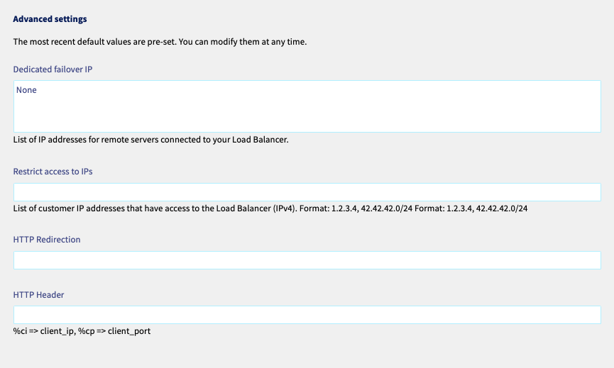

You can define dedicated Additional IPs via the OVHcloud Control Panel by going to the Bare Metal Cloud section, then Load Balancer.
Once you have selected the Load Balancer you want to modify, navigate to the Front-ends tab, where you can create a new front-end or edit an existing one.
In Advanced settings, you can select the Additional IPs you would like to add to your front-end.
Once the front-end has been configured, click Add or Modify, depending on whether you are configuring a new or existing front-end.
