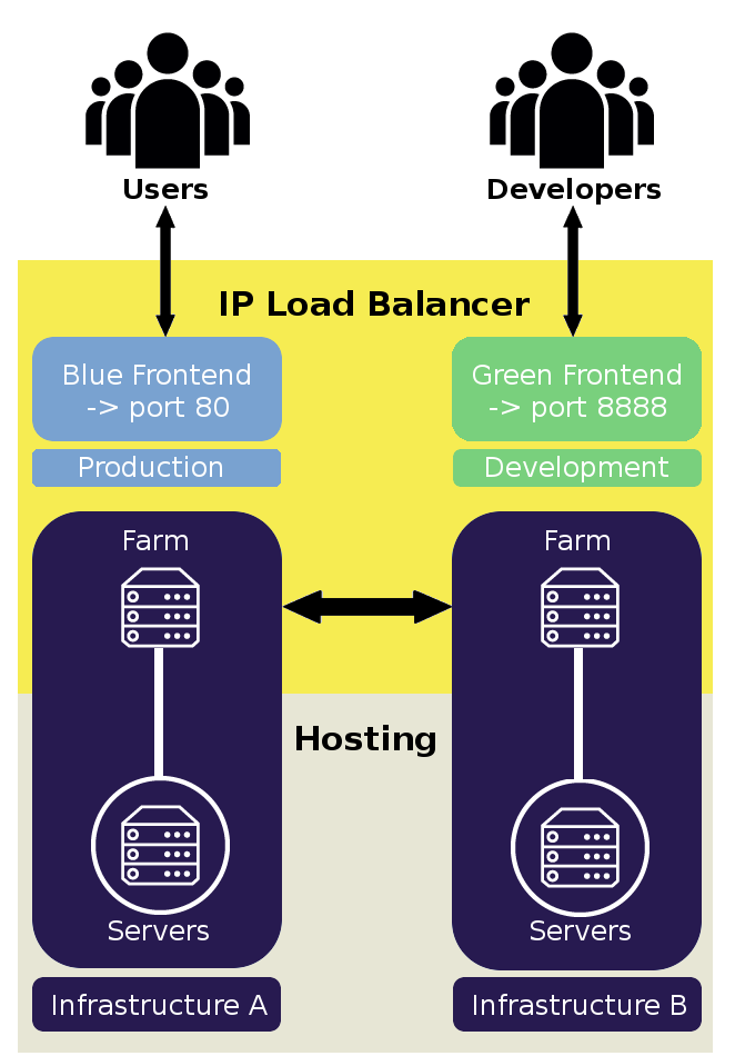

A blue-green infrastructure involves switching from infrastructure A to infrastructure B, once infrastructure B has been fully updated and validated. The Load Balancer will manage this switch.
The diagram below gives a general idea of the architecture:
Infrastructure A
This infrastructure is made up of a server cluster that will later be associated with a front-end of your IP Load Balancer. This server cluster will expose an HTTP or a TCP service to the front-end. It also balances loads by sending the front-end’s incoming traffic to the servers. For more details on the role of various components of the OVHcloud Load Balancer service, you can read the following guide: Introduction to the OVHcloud Load Balancer.
In our scenario, we will declare a server cluster of servers for the HTTP service. Please note that you can create as many clusters (as well as TCP services) as are required for your final service to be exposed to your customers.

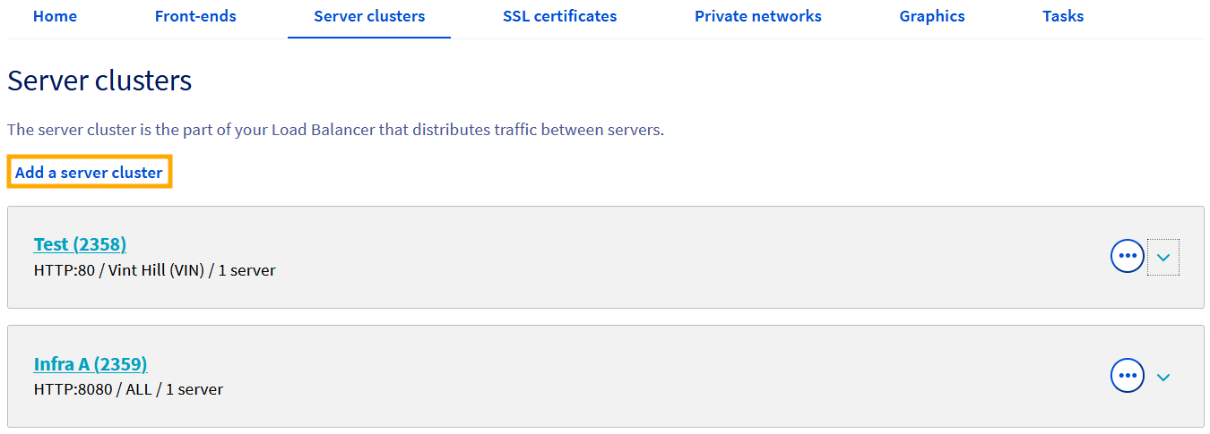

Navigate to your load balancer service in the OVHcloud Control Panel via the Network and then Load Balancer menus.
NOTE: If you are not using the beta version of the OVHcloud Control Panel, you can find the OVHcloud Load Balancer via the Bare Metal Cloud or Hosted Private Cloud sections.

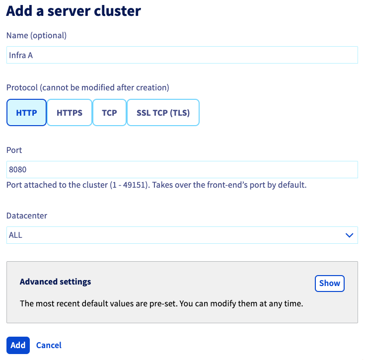

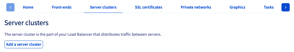

Choose the Server clusters tab, then click the Add a server cluster button.
Provide or choose a Name, Protocol, Port, and Datacenter, and then click Add.

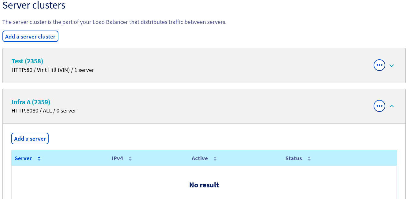

Link a dedicated server to your farm if it hosts your production infrastructure. The service exposed to the front-end is supplied by the server’s port 8080. You can link one or more servers with each cluster (for example, to balance the load or offer higher fault tolerance).

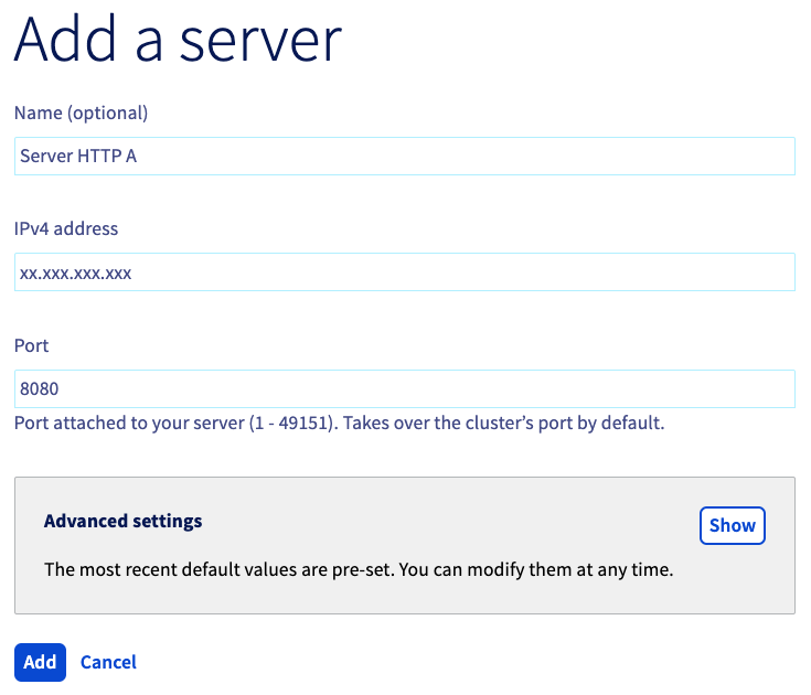

From the Server clusters tab, expand the details of the cluster you just created and click Add a server.
Provide or choose a Name, IPv4 address, and Port, and then click Add.

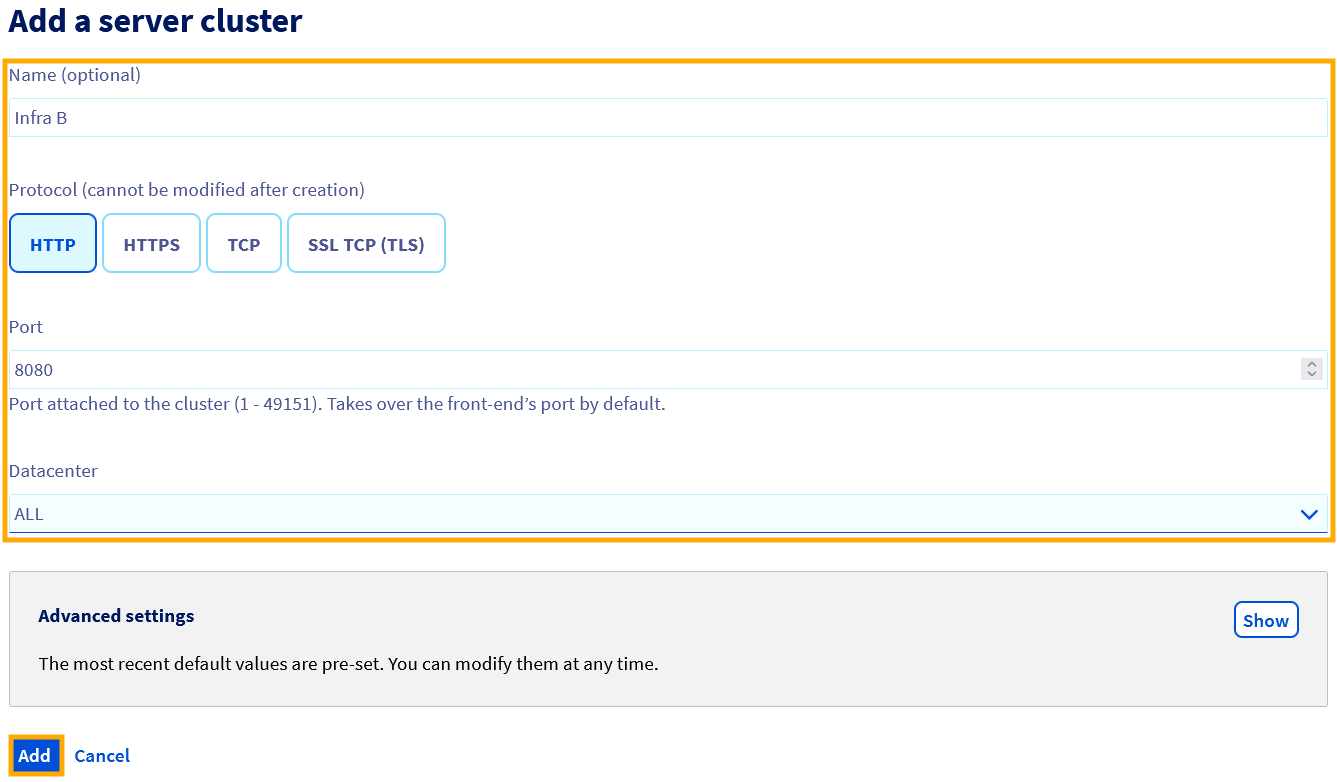

Deploy the server cluster for the HTTP service (and/or any other TCP services required for your final service to be exposed to your customers).
In the OVHcloud Control Panel, from the Server clusters tab, click Add a server cluster.
From the OVHcloud API, create a second server cluster using the command below:

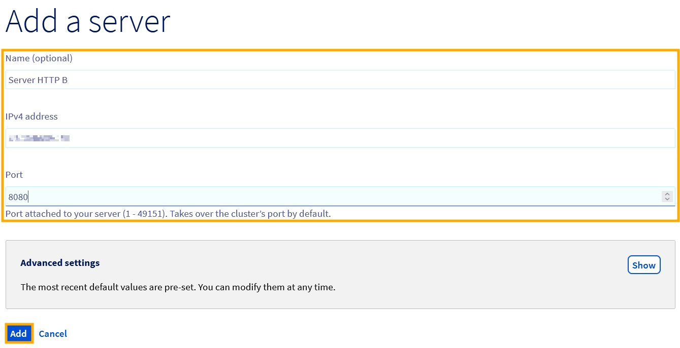

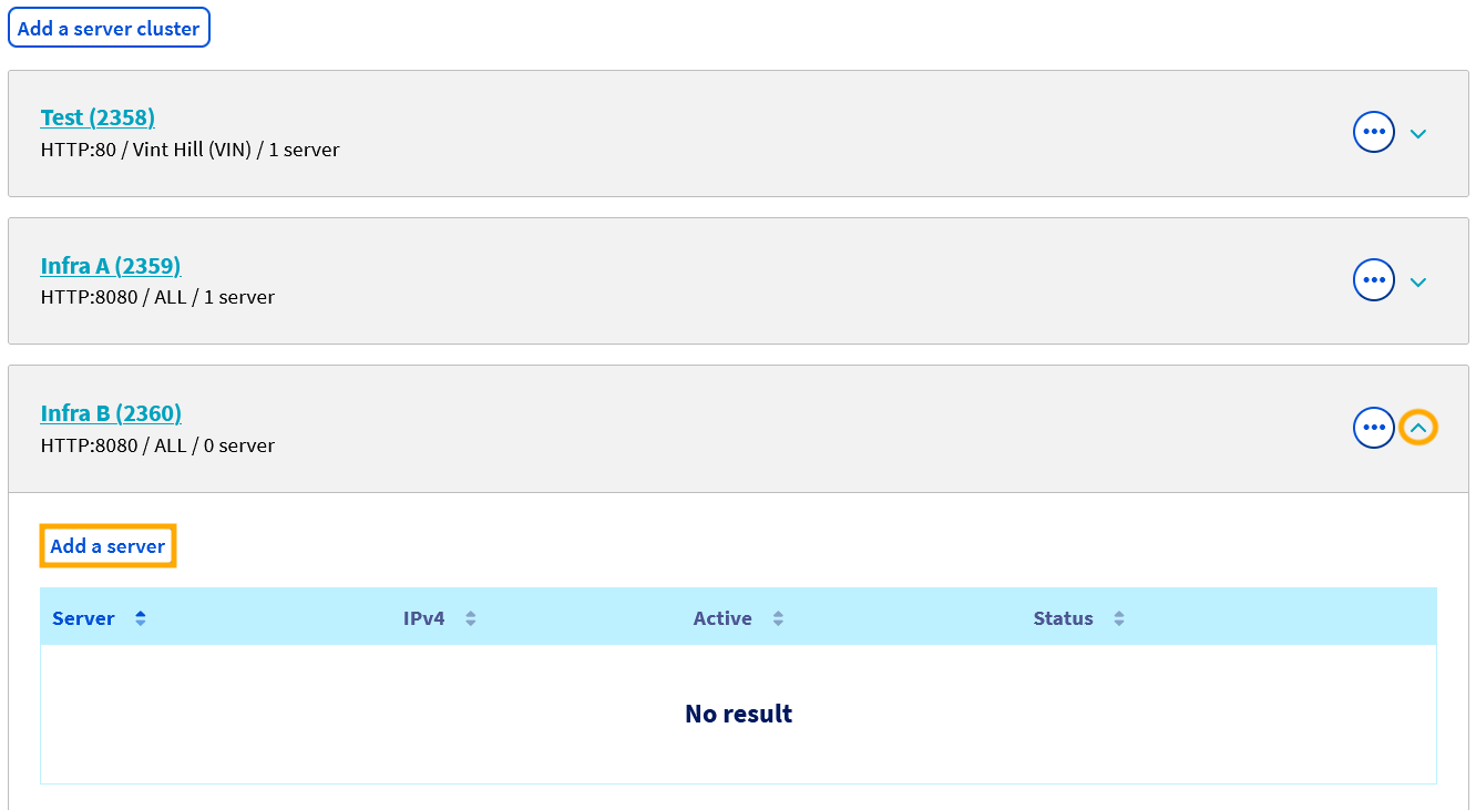

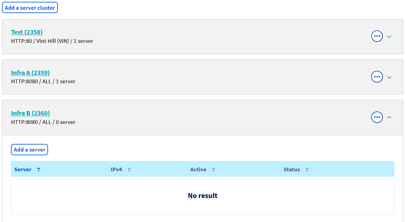

Associate a server with your server cluster. Here, it involves one or more physical servers hosting your development infrastructure.
In the OVHcloud Control Panel, from the Server clusters tab, expand the details of the second cluster you created and click Add a server.

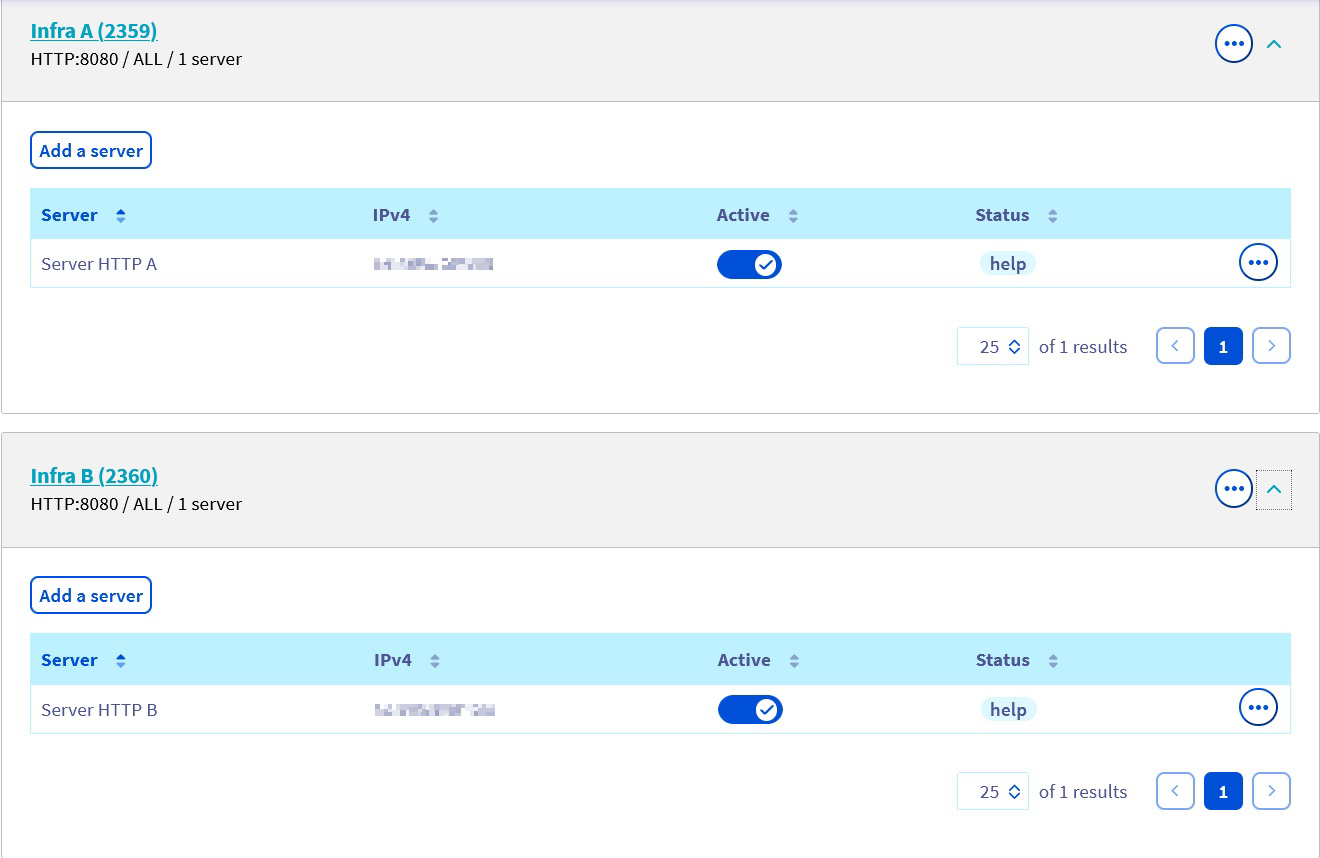

At this stage, you should see two clusters with a server attached to each:

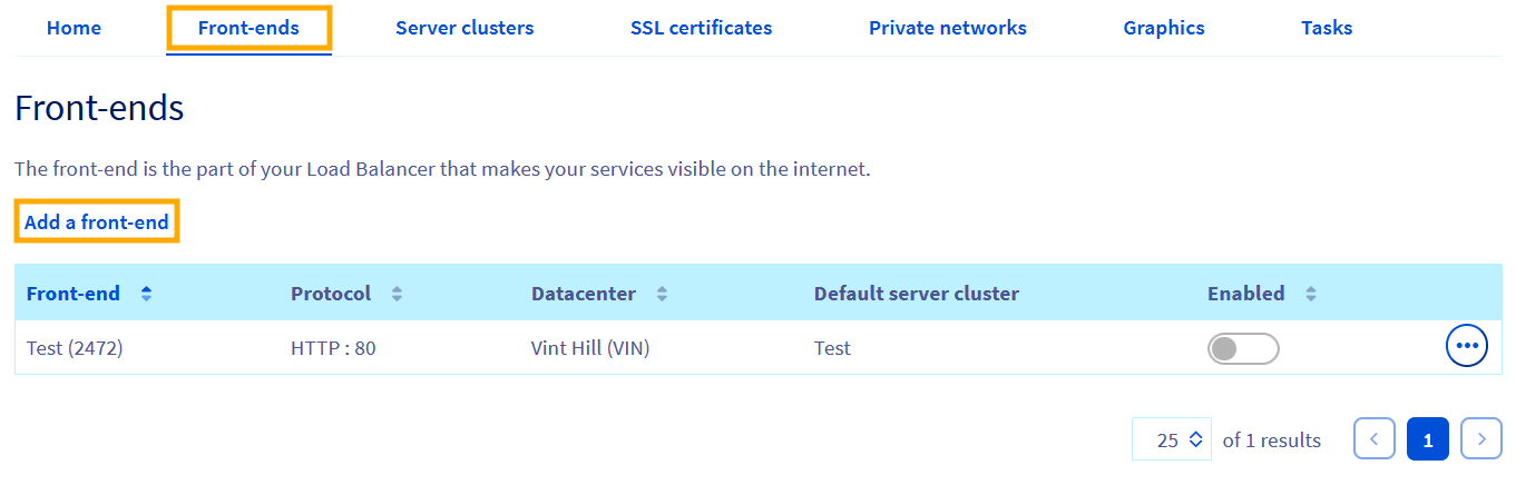

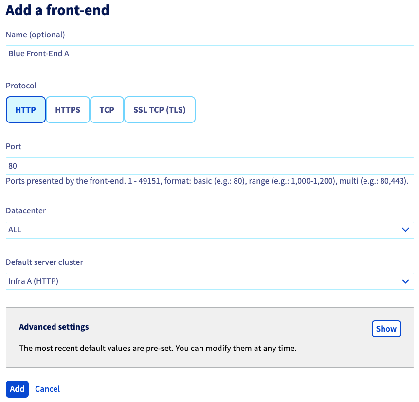

Blue front-end

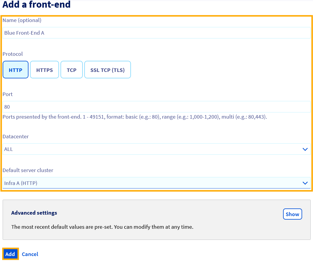

This front-end is dedicated to accessing the production infrastructure. The ports exposed to your customers are the standard ports for accessing the service. In this case, we are exposing an HTTP service, so we will use port 80 (443 if you would like an SSL termination).

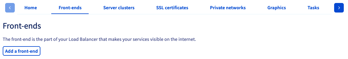

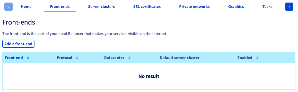

In the OVHcloud Control Panel, select the Front-ends tab and click Add a front-end.
Provide or choose a Name, Protocol, Port, Datacenter, and Default server cluster, and then click Add.

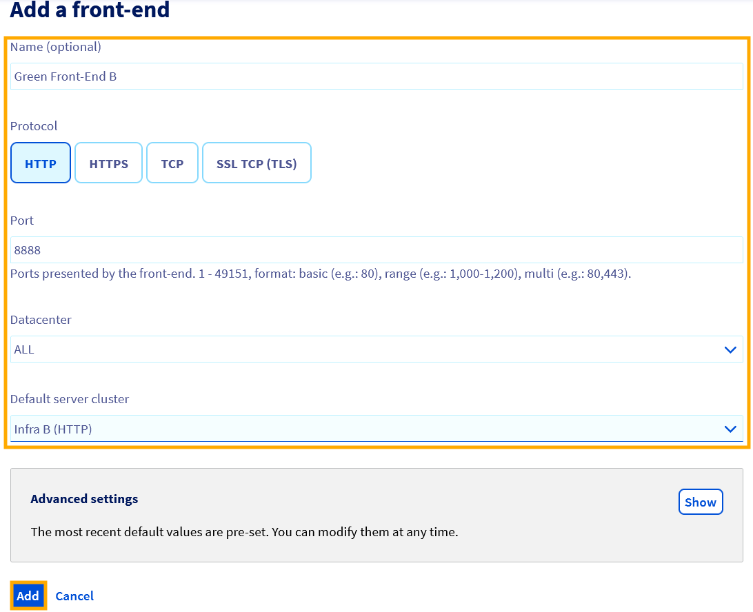

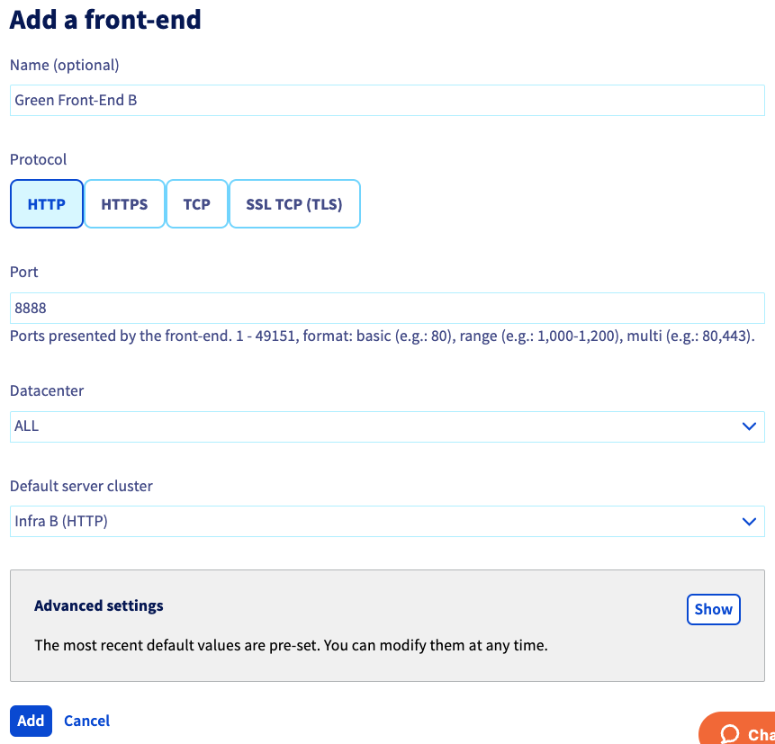

This front-end is dedicated to accessing the development infrastructure. The ports exposed to your customers will be non-standard ports that you can choose arbitrarily. In this case, we will expose the HTTP development service on port 8888.
In the OVHcloud Control Panel, from the Front-ends tab, click the Add a front-end button again.

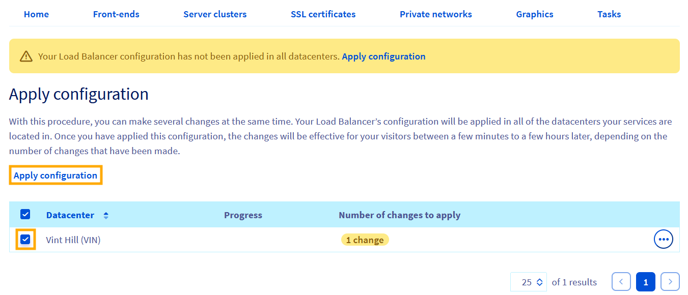

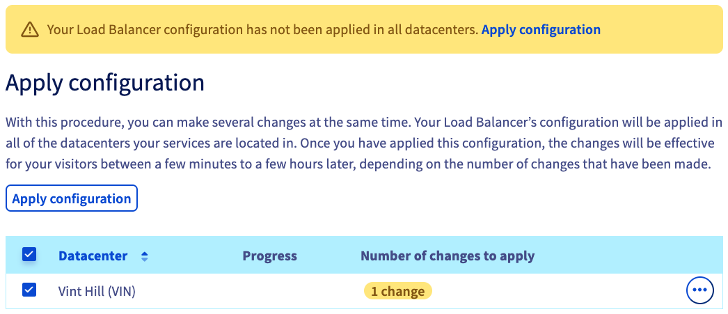

Once you have finished configuring the components of the OVHcloud Load Balancer service, you now just need to apply your changes.
In the OVHcloud Control Panel, click the Apply configuration button in the yellow banner.
On the next screen, select ☑ your Datacenter and click the Apply configuration button.
From the OVHcloud API, use the following call:

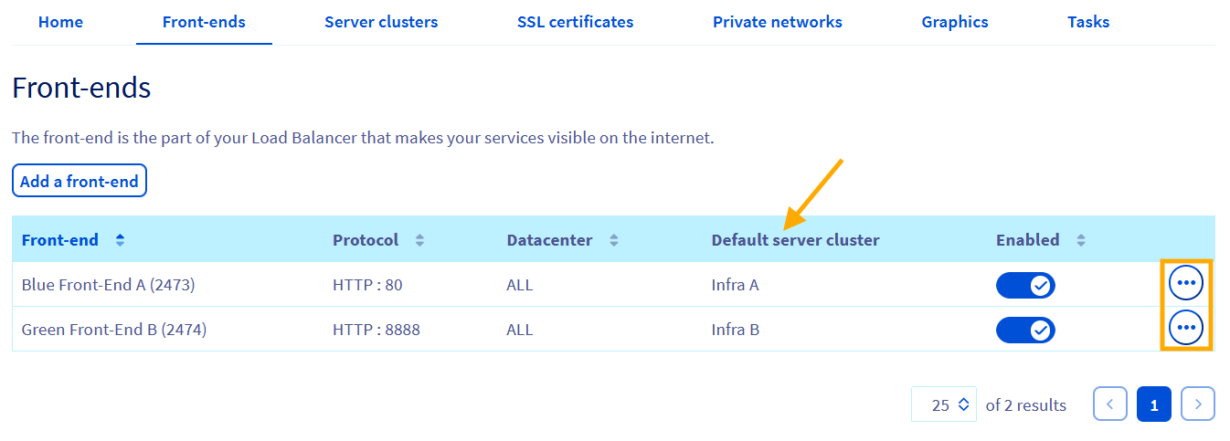

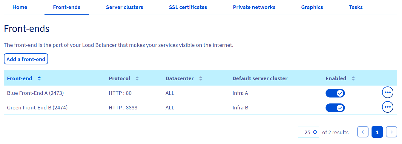

To switch between the two clusters, you can simply update your different front-ends by modifying the ID of the server cluster it is attached to, and applying the modification.
The blue front-end (id 2473) will then be associated with Infra B (new production, id 2360).
The green front-end (id 2474) will then be associated with Infra A (new development, id 2359).
In the OVHcloud Control Panel, in the Front-ends tab, check that each of your front-ends is connected to the correct Default server cluster.
If not, you can use the more options ... buttons at the right edge of each row to edit the default server cluster for your front-ends.
From the OVHcloud API, modify the associated cluster for each of the front-ends:
