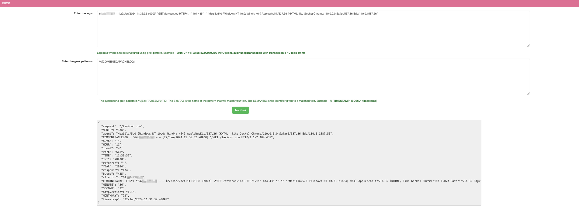

Grok patterns and debugger
As an example of the main pattern matching that is currently used, or to test some more specific ones, you can use some tools like Javainuse Grok Debugger:

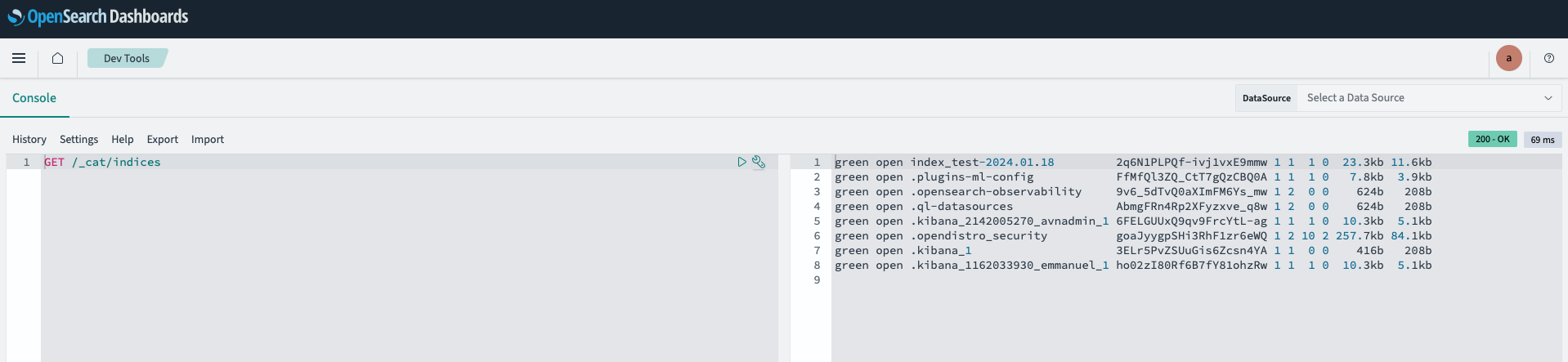

Now that we have Logstash running and parsing the Apache access log file, let's do a different connection to the Apache service and validate that Logstash is forwarding all access data to OpenSearch™. Let's also connect to the OpenSearch™ Dashboard to check that the corresponding index has been created and that some first documents have been populated.

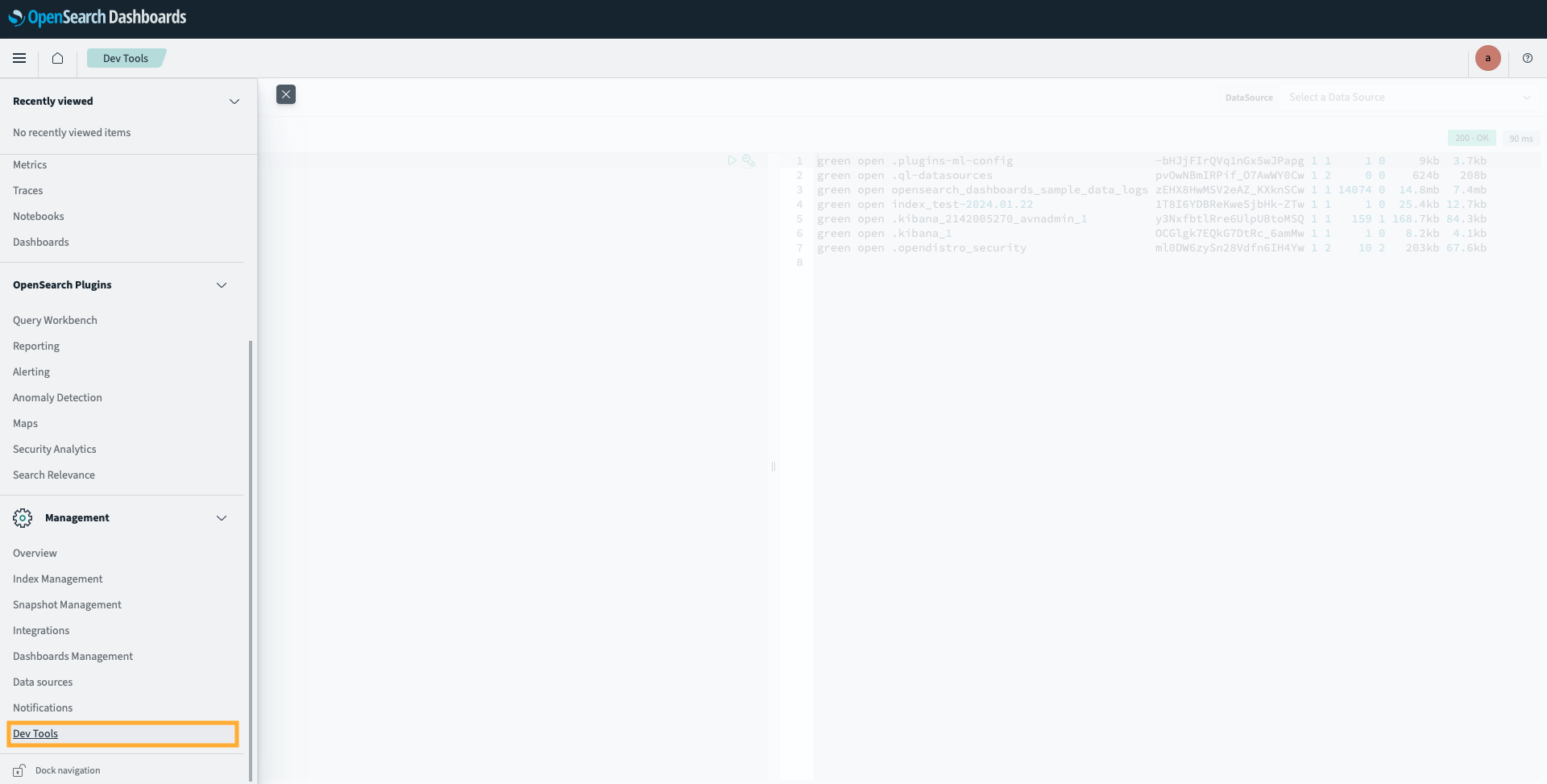

Use the Dev Tools to query the indices:
Then, in the console, execute a GET /_cat/indices command to get the index list with the number of documents for each:

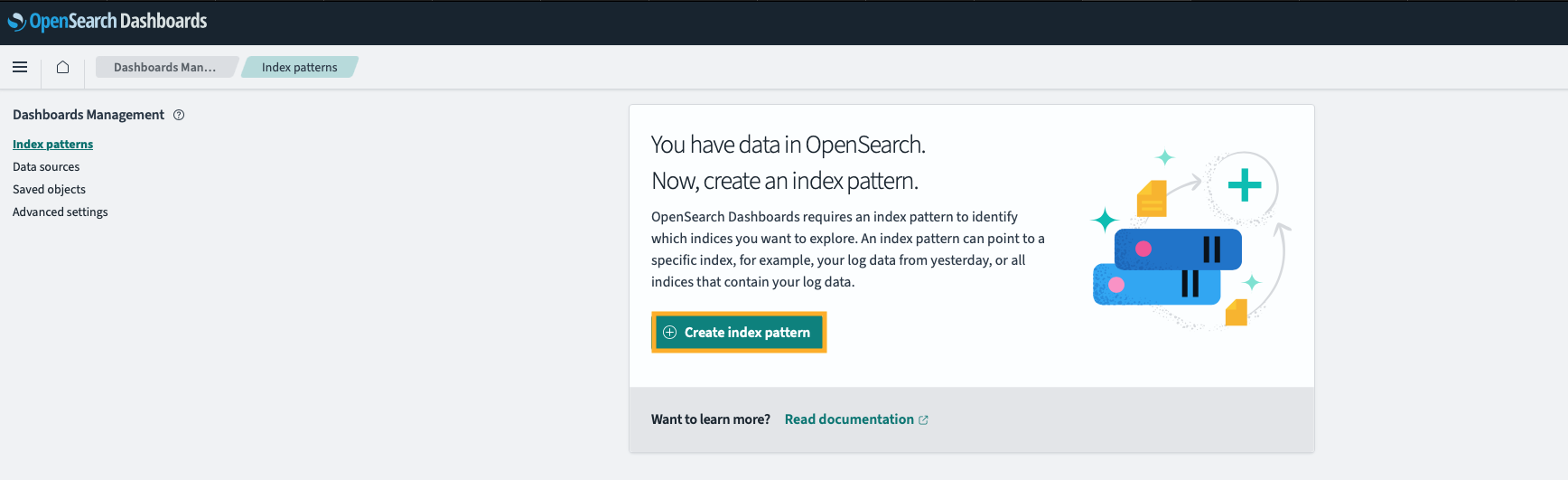

Create an index pattern
To aggregate all corresponding daily indices, we have to create an index pattern from the Dashboard Management menu:

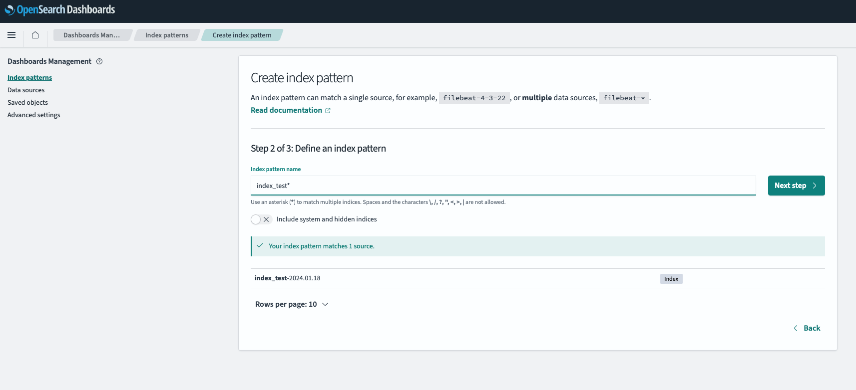

Click + Create index pattern.

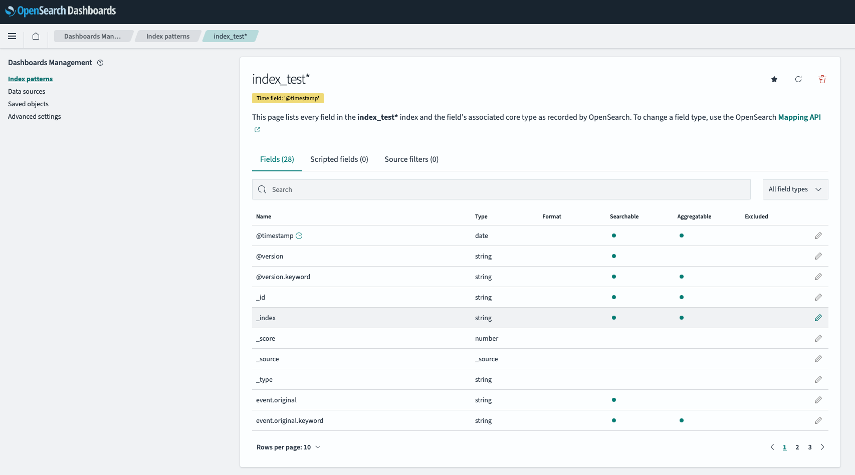

As we want to consolidate all our daily indices, let's define the pattern as index_test:

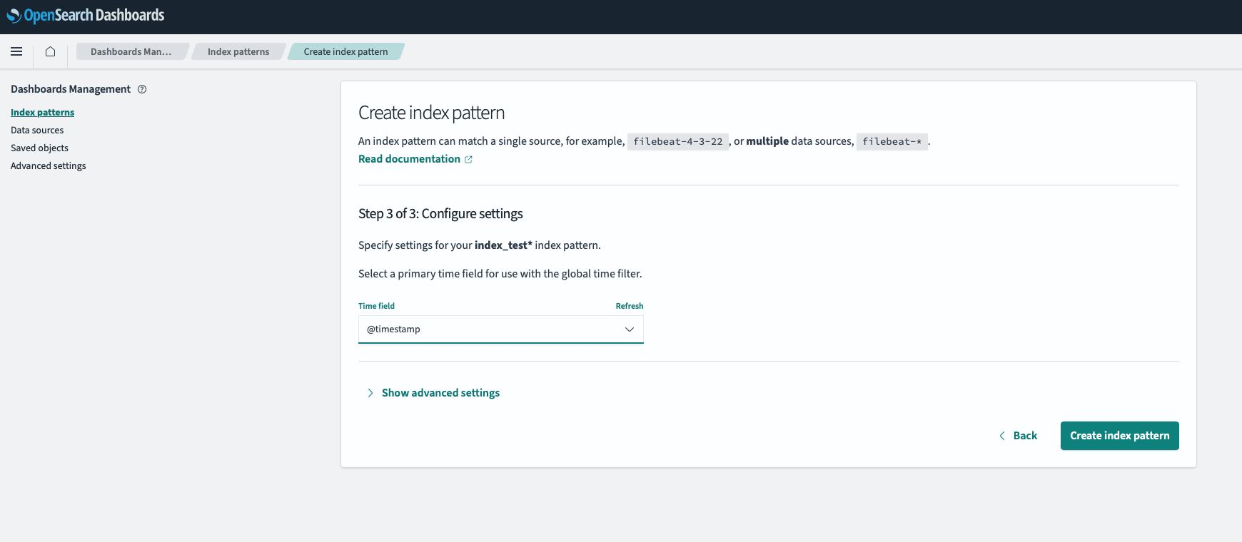

Then define the timestamp:

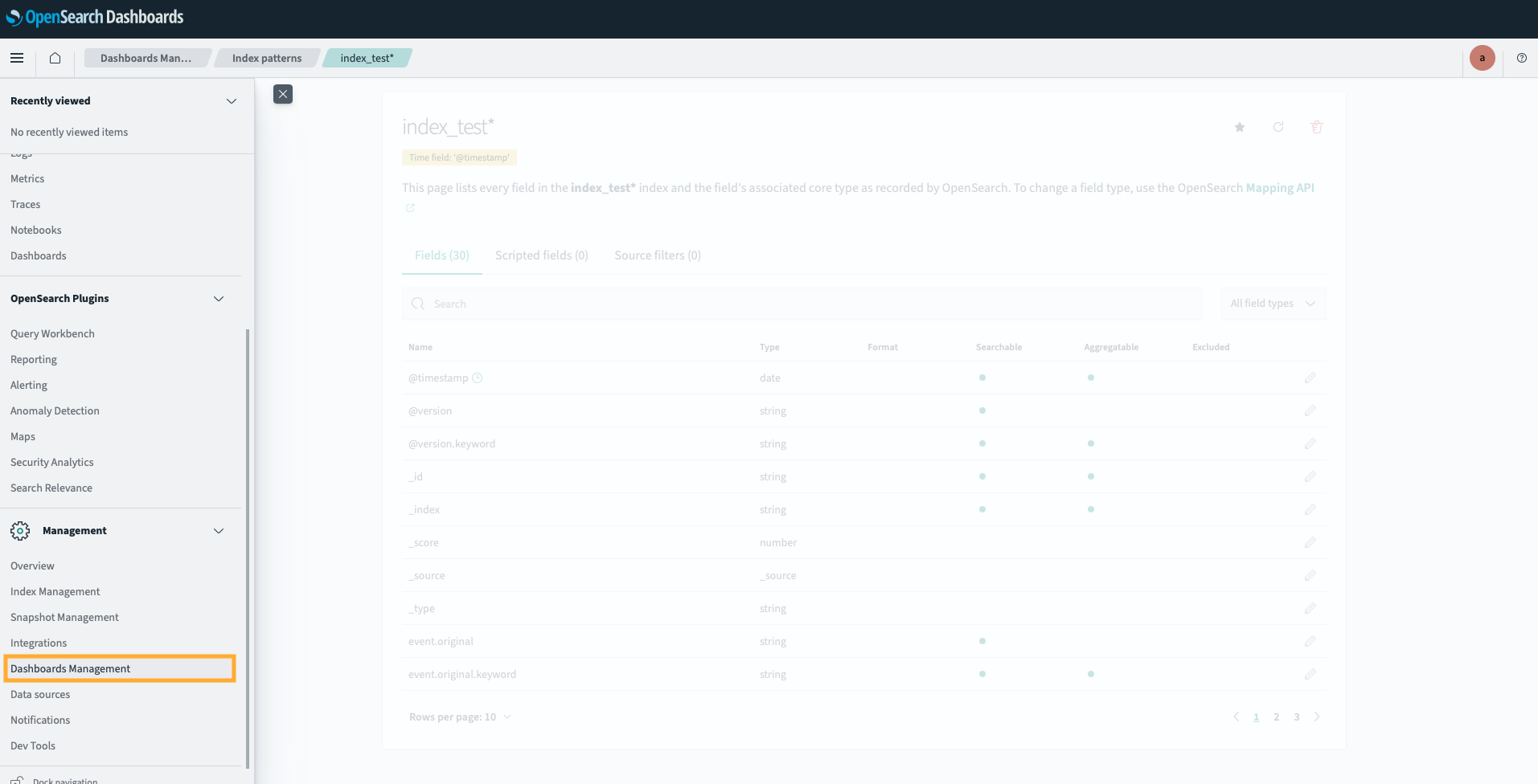

OpenSearch™ will then define all fields available and their type directly from stored documents in the index:

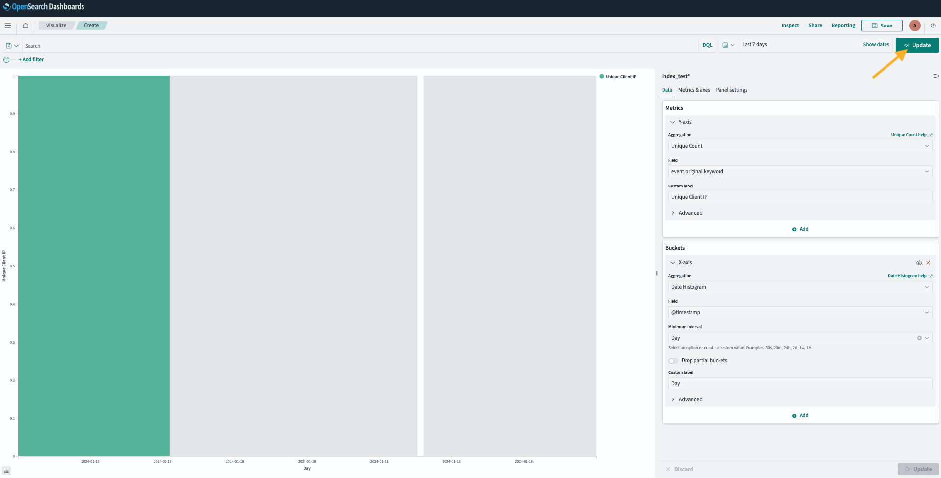

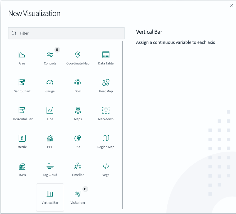

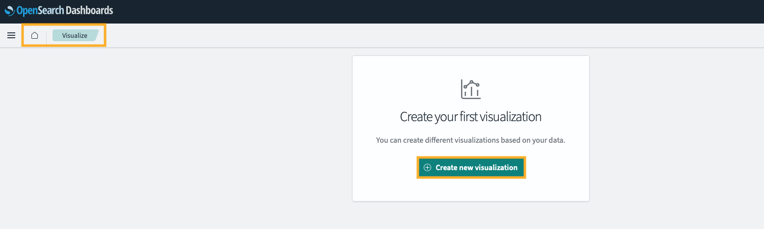

Create a new visualization
In the OpenSearch™ Dashboard, click Visualize, then + Create
new visualization.
Select the visualization type:
Then select the data source (the index pattern you just created):
You now have to define all the criteria that you need to visualize:
- the period (last 7 days in our example);
- for the metrics, the Y-axis data (aggregation/field);
- and the same for Buckets with time intervals in case of data aggregation.
Click Update after making changes to the data definition, or refresh if you change the data time scale.

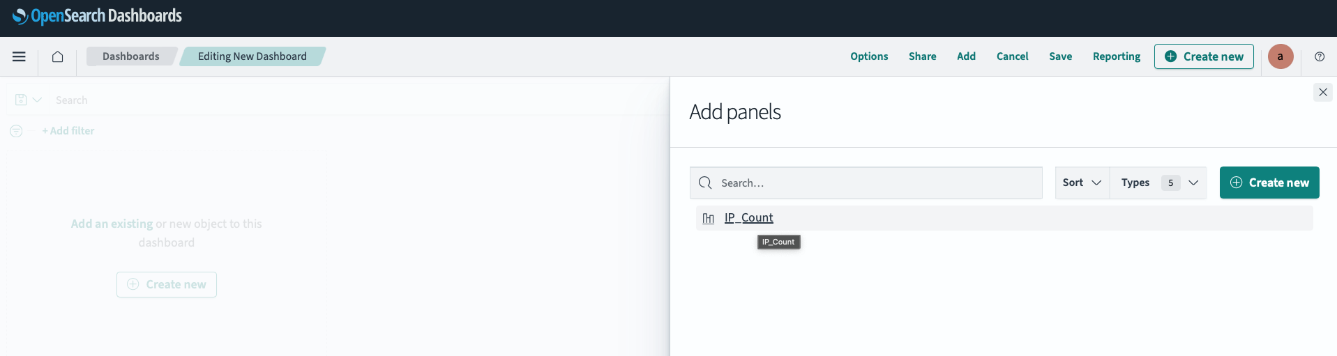

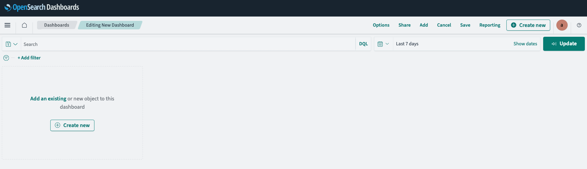

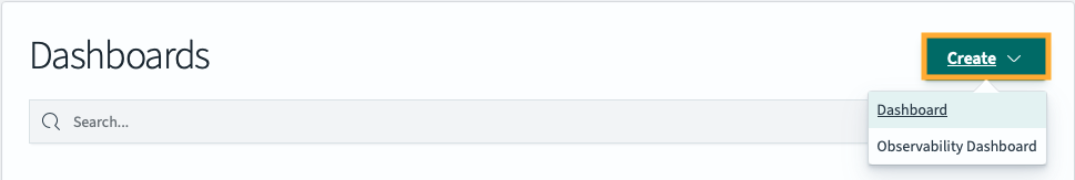

Create a new dashboard:
As we have already created a visualization, Add an existing object:
Search and select the one we just created:
Reorganize your panels, and add new or existing ones as wanted:
