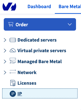

Creating a Virtual MAC for a Additional IP in the OVHcloud Control Panel
In this section, we will be creating a virtual MAC address to be used by the NIC (Network Interface Card) which Hyper-V assigns to a VM. To begin, log in to the OVHcloud Control Panel. Click Bare Metal Cloud at the top of the page. Then, on the left-hand sidebar click the IP option.

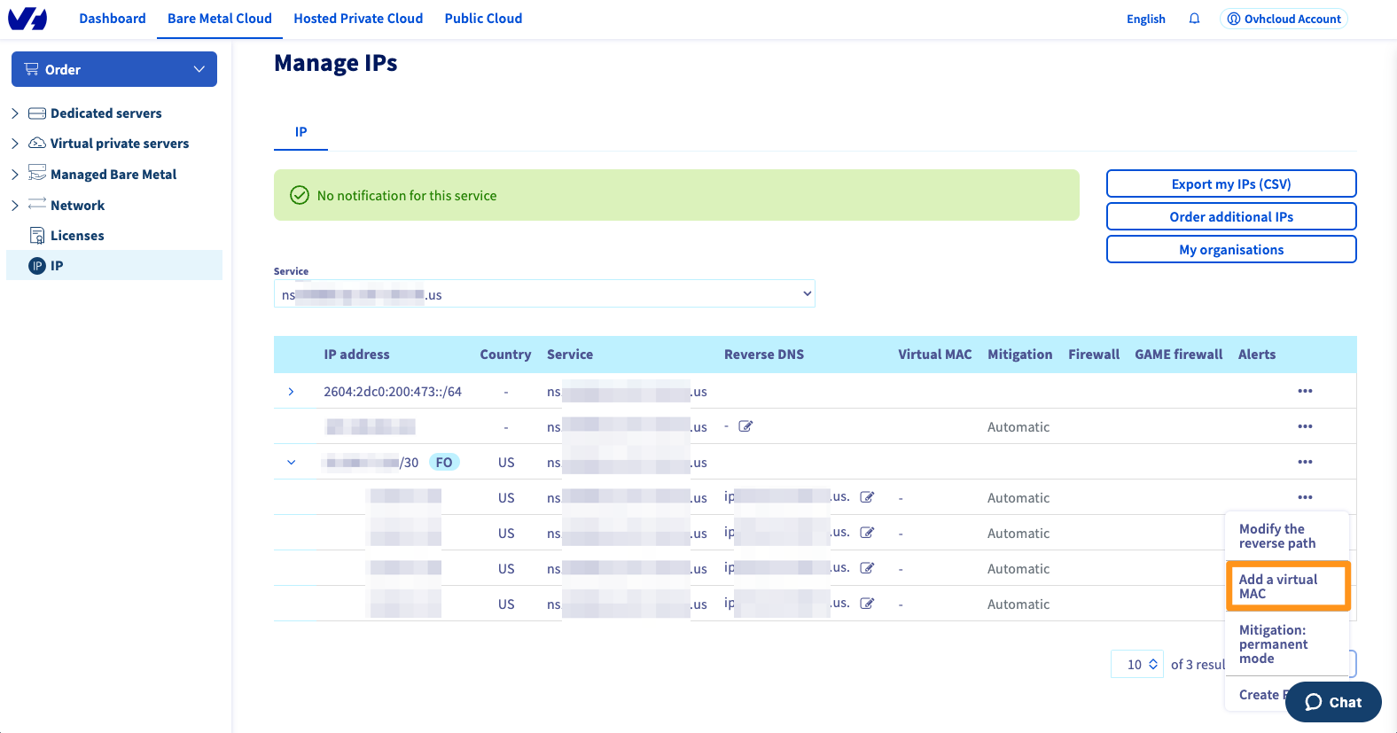

Choose the additional IP you wish to configure to your VM and click the ellipses (...) button next to it. Then, select the Add a virtual MAC option from the drop-down menu.

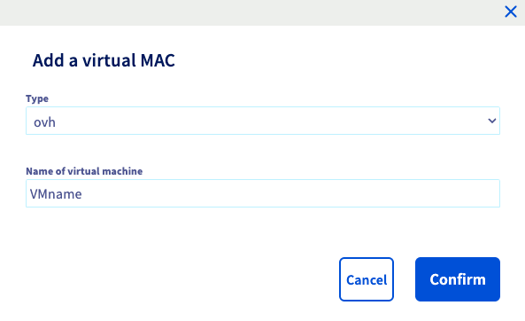

In the popup menu, change the "Type" to "ovh" and enter the name of your virtual machine.
Note: Please allow up to three minutes for the virtual MAC to populate in the OVHcloud Manager.

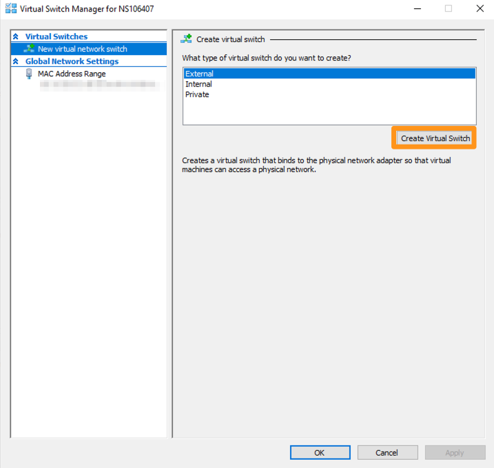

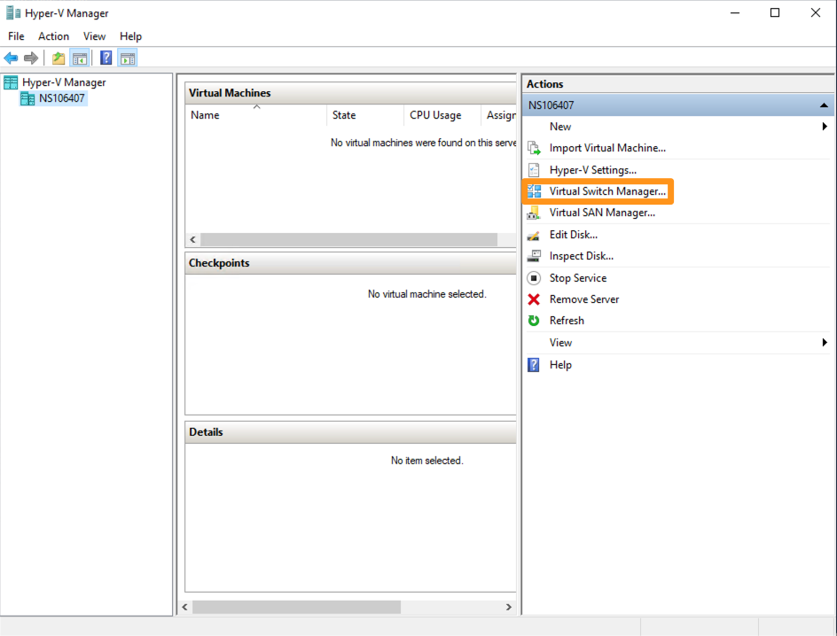

We will first create a virtual switch in Hyper-V Manager before we configure our VM. From the command line of your dedicated server, run ipconfig /all and note the name of the network adapter that contains the server’s main IP address.
In Hyper-V Manager, click the name of your server on the left-hand column, then click Virtual Switch Manager... in the right-hand column.
Select External in the Virtual Switch Manager and then click Create Virtual Switch.

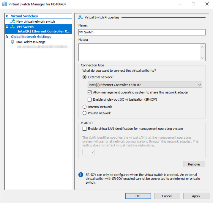

Select the external network that we found at the beginning of this section and click OK.
Your server will momentarily lose connection. Give it up to a minute to reconnect.

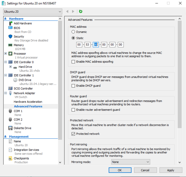

Next, we will be pairing the virtual MAC, which we generated in the first section, to the interface that Hyper-V has assigned to the VM. To complete this step, your VM must be powered off.
In Hyper-V Manager, right-click your VM and select the Settings... option from the drop-down menu.
On the left-hand column, click the + next to "Network Adapter" and click Advanced Features. Select Static for the MAC address and enter your virtual MAC here. Click OK to save the settings.
You are now ready to configure the network interface on your VM. In the next step, we will be configuring network settings within the OS of our VM. These steps can be different depending on the OS you are using. Click the correct link below to take you to instructions for your OS of choice:

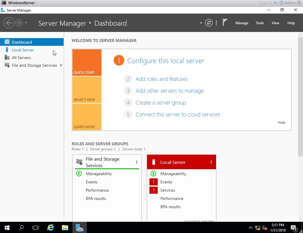

In this step, we will be configuring our interface settings. To do this, navigate to the Server Manager. From the left-hand column, click the Local Server option.
By default, the "Ethernet0" option will read, IPv4 address assigned by DHCP, IPv6 enabled. This is exactly what we want to change, so click on this text.

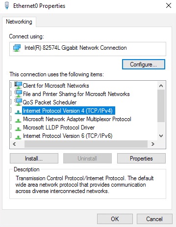

Next, right-click on Ethernet0 and select the Properties option from the drop-down menu. From the ensuing menu, double-click the Internet Protocol Version 4 (TCP/IPv4) option.

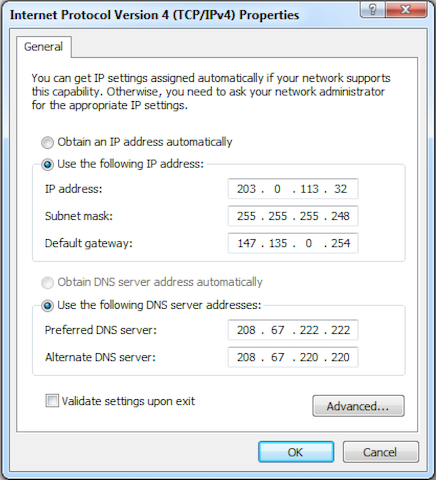

This will allow you to configure your interface to use the IP address, gateway, and DNS name servers of your choice. Configure it as follows:
In this file, replace the following pieces of information from the picture as instructed:
- 1. Next to "IP address", replace "203.0.113.32" with the additional IP to which you have added the vMAC in the OVHcloud Manager.
- 2. Next to "Subnet mask", replace "255.255.255.248" with the correct netmask depending on the size of the block of IPs you have purchased. For instance, if you are using a /28 block, put "240" in the last octet.
- 3. Next to "Default gateway", replace the "147.135.0.254" with the IPv4 Gateway of your server, found in the OVHcloud Control Panel. (See more here.)
- 4. The DNS nameservers listed are from OpenDNS. Feel free to use other name servers here, if you choose.
Click OK after making these changes. To test that the VM is fully connected to the Internet, ping example.com. If you get a response, you are good to go. If you do not, restart your VM and attempt the ping again.
