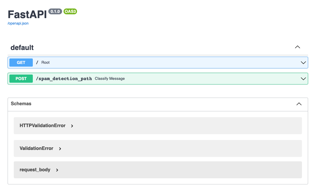

By clicking on the link of your AI Deploy app, you will arrive at the following page.
How to interact with your API?
You can add /docs
at the end of the URL of your app.
In our example, the URL is as follows: https://faf8ea3b-7095-4352-8e22-28f1f4107c77.app.us-east-va.ai.cloud.ovh.us/docs
It provides a complete dashboard for interacting with the API!

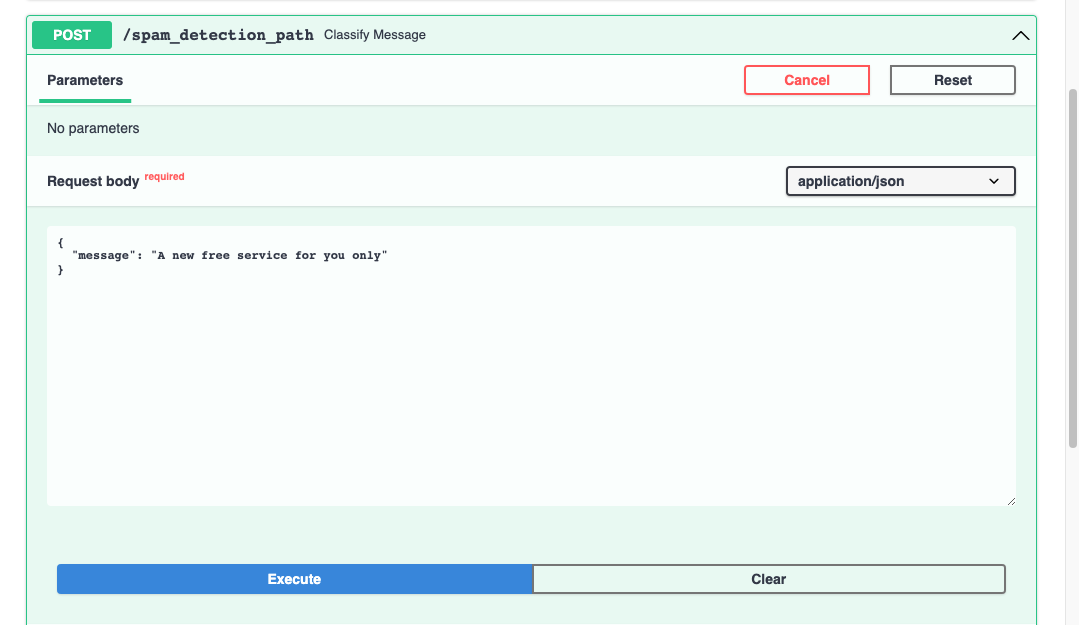

To be able to send a message for classification, select /spam_detection_path
in the green box. Click on Try it out
and type the message of your choice in the dedicated zone.

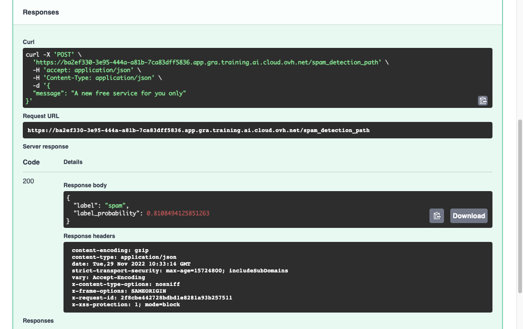

To get the result of the prediction, click on the Execute
button.
Congratulations! You have obtained the result of the prediction with the label and the confidence score.
