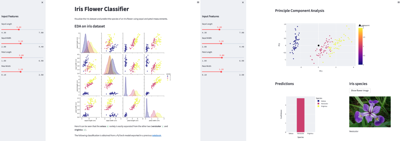

Load the IRIS dataset for EDA.
Display EDA figure based on source dataset.
Create a sidebar with sliders.
Run a PCA.
Create a function that filters out negative values from the dataframe. Only positive values in the dataframe are kept. If a value is negative, it is set to zero.
Define a Python function to display the image according to Iris species.
All the functions defined above are called in the main
Python file app.py
to build the Streamlit app. You can find this part of the code as well as the different functions defined previously on the GitHub repository.
