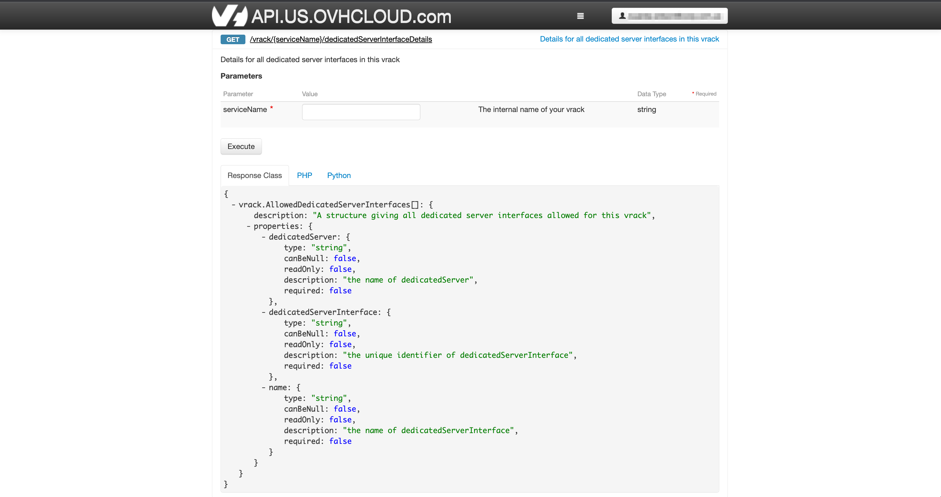

To verify that the server was added to vRack, select the GET /vrack/{serviceName}/dedicatedServerInterfaceDetails option, enter the vRack ID, and click the Execute button.
