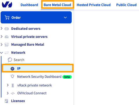

From the OVHcloud Control Panel, select Bare Metal Cloud
in the top navigation bar. In the left-hand menu, under Network, click IP

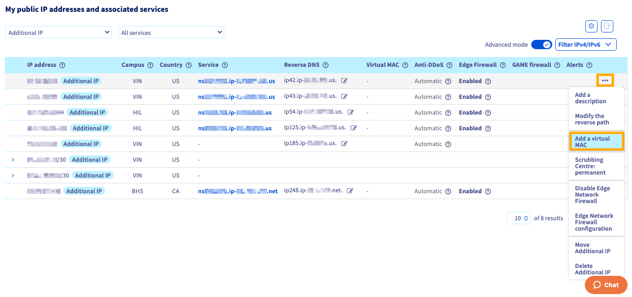

Choose the Additional IP you wish to configure to your VM and click the more options ...
button to the right of it. Then, select the Add a virtual MAC
option from the drop-down menu.

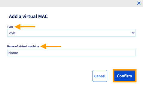

In the pop-up menu, set the Type to ovh
and enter the name of your virtual machine.
Lastly, click Confirm
to initiate the creation of the vMAC address.

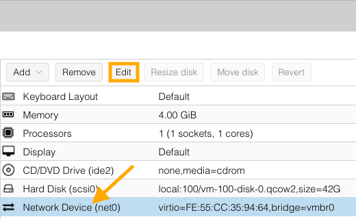

In Proxmox, navigate to the Hardware
section of the VM that you would like to connect to the Internet.
From here, click the Network Device
option and click the Edit

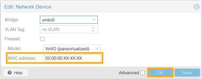

button.
In the MAC address: field, enter the vMAC address that was created in the previous section and click OK
Start your VM as you are now ready to configure the network interface.

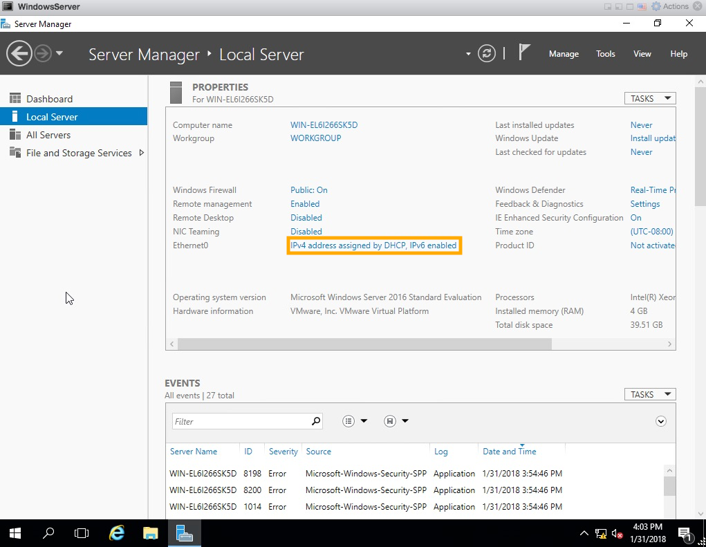

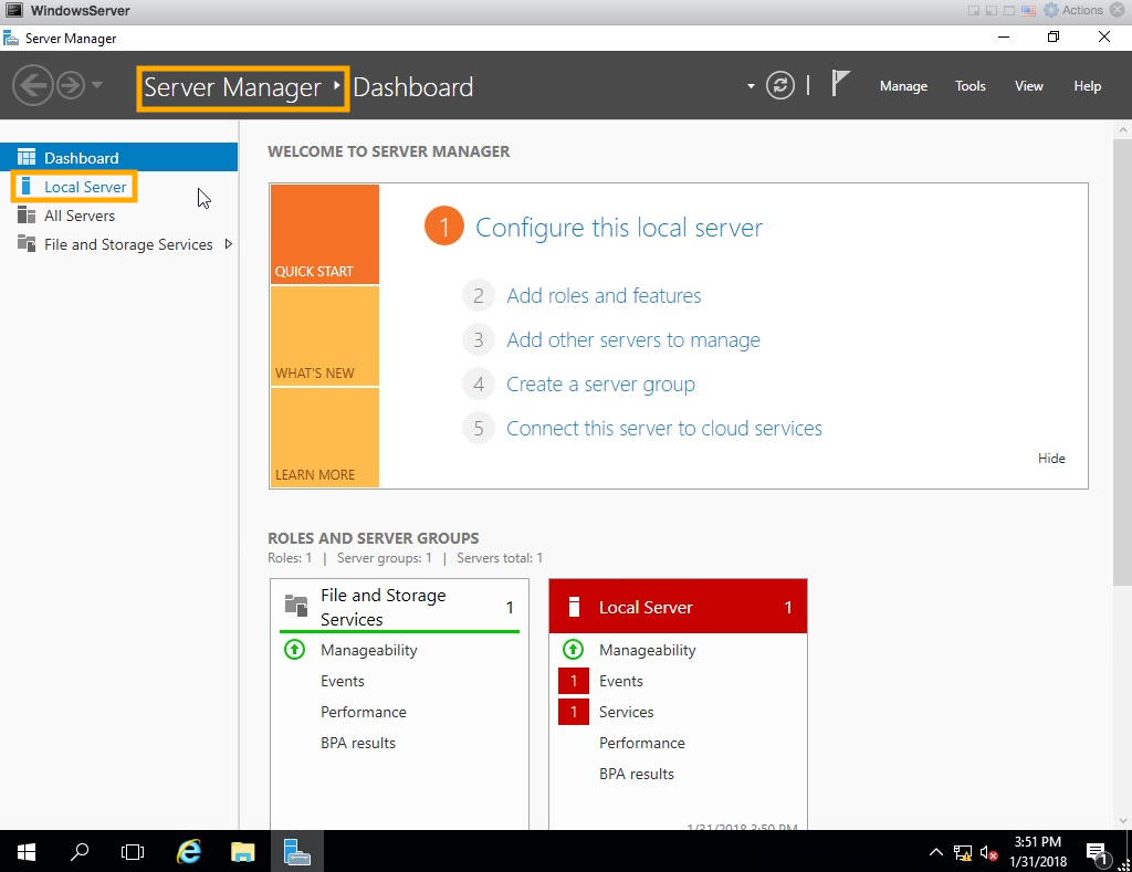

In this step, we will be configuring our interface settings. To do this, navigate to the Server Manager
. From the left-hand column, click the Local
Server
option.
We want to change the default Ethernet0 option. To do so, click IPv4 address assigned by DHCP, IPv6 enabled

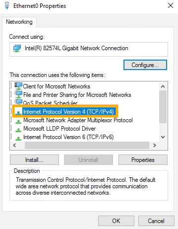

Next, right-click on Ethernet0 and select the Properties option from the drop-down menu. From the ensuing menu, double-click the Internet
Protocol Version 4 (TCP/IPv4)
option.

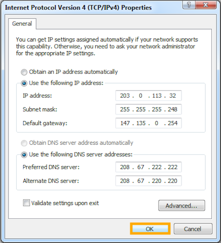

This will allow you to configure your interface to use the IP address, gateway, and DNS name servers of your choice. Configure it as follows:
- Next to IP address, replace "203.0.113.32" with the additional IP to which you have added the vMAC in the OVHcloud Control Panel.
- Next to Subnet mask, replace "255.255.255.248" with the correct netmask depending on the size of the block of IPs you have purchased. For instance, if you are using a /28 block, put "240" in the last octet.
- Next to Default gateway, replace the "203.0.113.254" with the IPv4 Gateway of your server, found in the OVHcloud Control Panel. (See more here.)
- The DNS nameservers listed are from OpenDNS. Feel free to use other name servers here, if you choose.
Click OK
after making these changes.
To test that the VM is fully connected to the Internet, ping example.com. If you get a response, you are good to go. If you do not, restart your VM and attempt the ping again.
