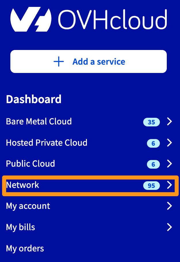

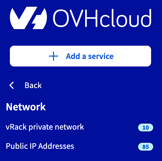

Navigation path:
Bare Metal Cloud>Network>IP

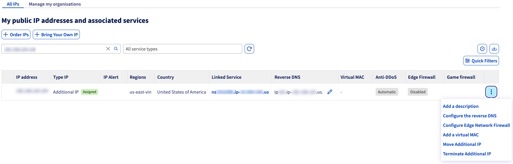

Adding a virtual MAC to an Additional IP

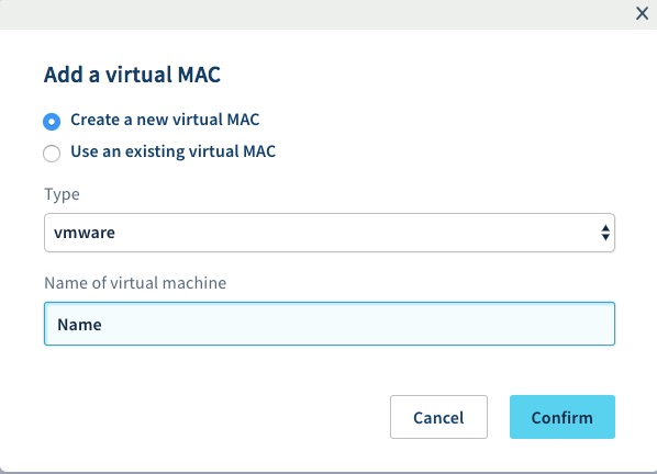

Find the Additional IP you wish to configure for your VM, click the more options ... button next to it, and choose the Add a virtual MAC option from the drop-down menu.
In the pop-up menu, change the Type to vmware and enter the name of your virtual machine.
NOTE: Please allow up to three minutes for the vMAC to populate in the OVHcloud Control Panel.

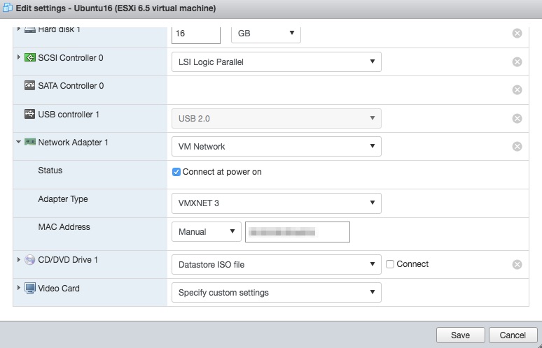

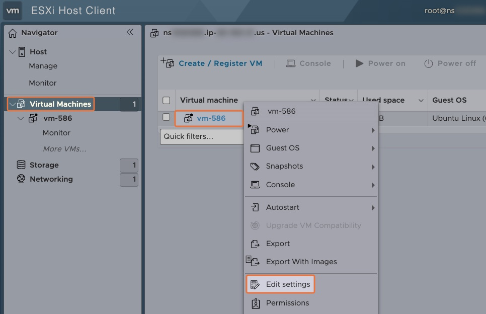

In the ESXi Host Client, locate your VM in the Virtual Machines menu, select it, and ⏻ Power off.

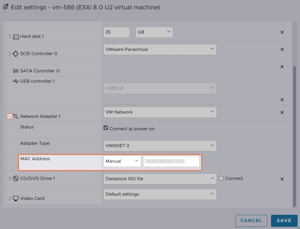

Right-click the VM and select the Edit settings option from the drop-down menu.
In the VM's settings, expand the Network Adapter 1 drop-down.
Change the MAC Address to Manual and enter the vMAC created in the previous step.
You can now ▶ Power on your VM!

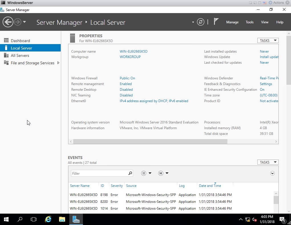

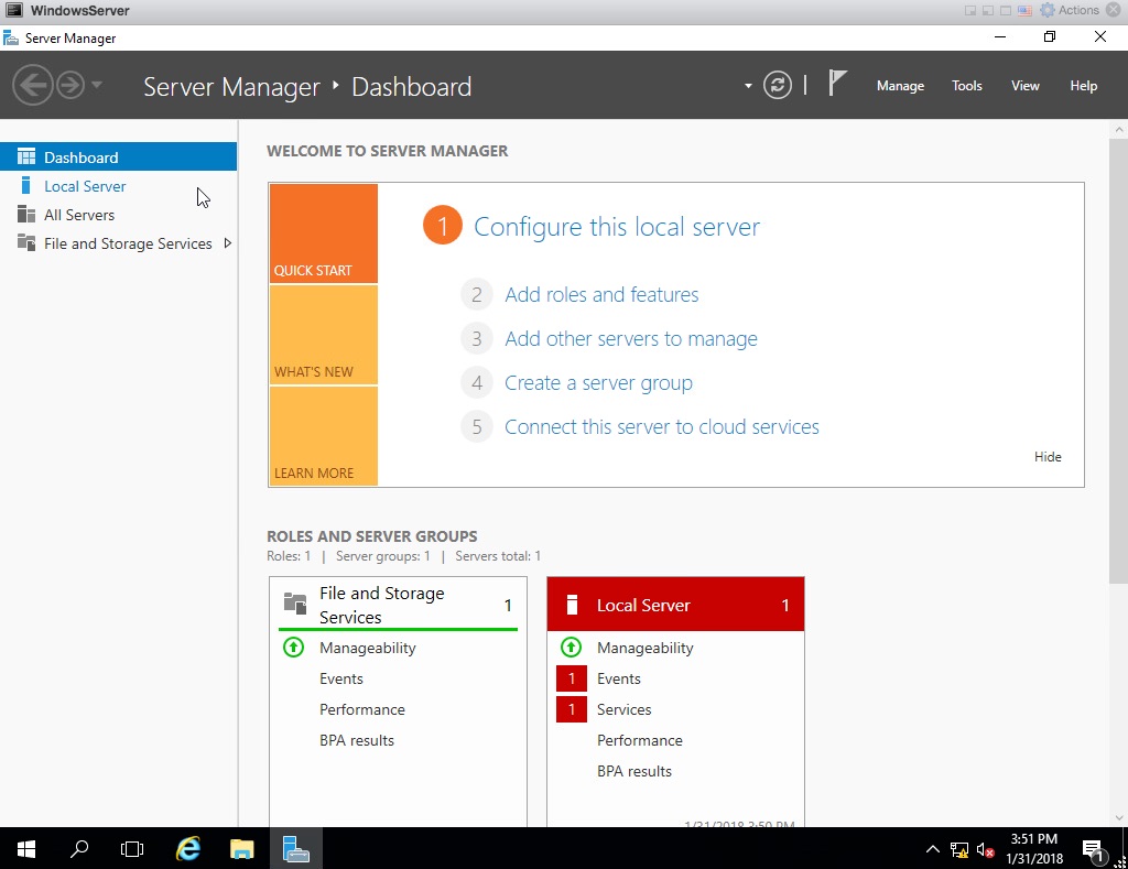

In this step, we will be configuring our interface settings. To do this, navigate to the Server Manager. From the left-hand column, click the Local Server option.
By default, the Ethernet0 field will read: IPv4 address assigned by DHCP, IPv6 enabled. This is exactly what we want to change, so click on this text.

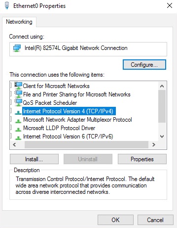

Next, right-click on Ethernet0 and select the Properties option from the drop-down menu. From the ensuing menu, double-click the Internet Protocol Version 4 (TCP/IPv4) option.

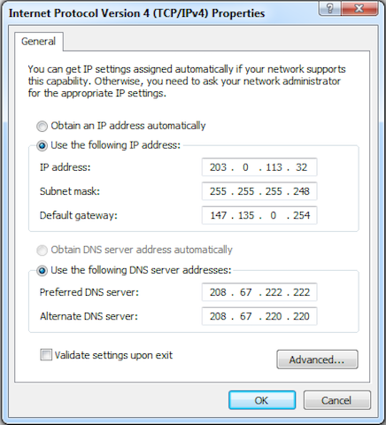

This will allow you to configure your interface to use the IP address, gateway, and DNS name servers of your choice. Configure it as follows:
Enter the following information in the dialog box, as shown in the picture:
IP address: Replace
203.0.113.32with the Additional IP from the first step of this guide. -
Subnet mask: Replace
255.255.255.248with the correct netmask depending on the size of the block of IPs you have purchased. For example, if you are using a /28 block, put "240" in the last octet. -
Default gateway: Replace
147.135.0.254with the first three octets of your Dedicated Server's IP address with a final octet of "254". - DNS server addresses: The DNS nameservers listed are from OpenDNS; feel free to use other name servers here, if you choose.
Click OK after making these changes.
