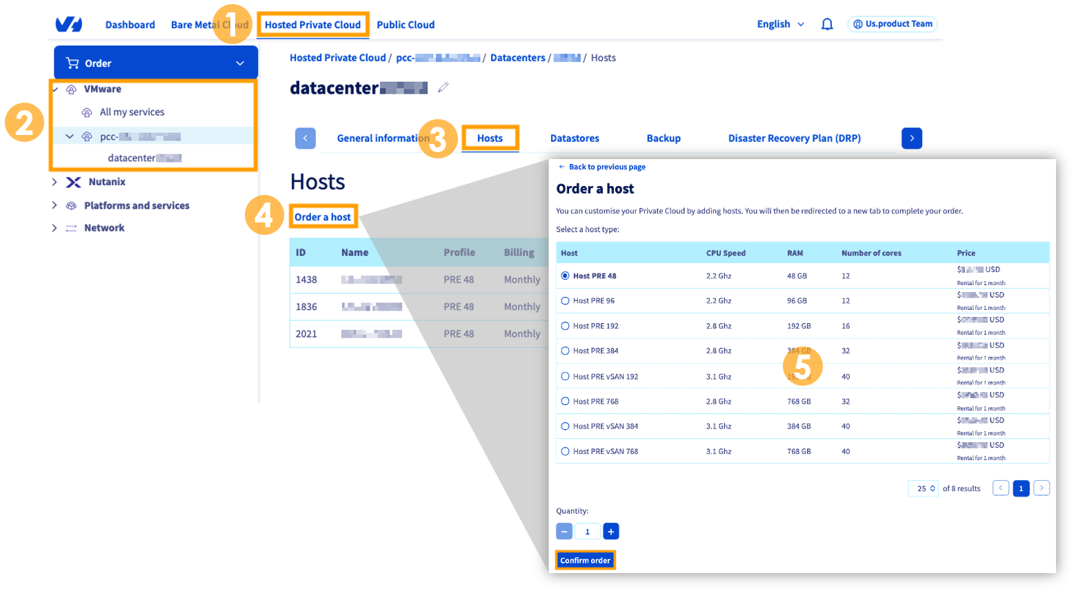

Adding a Host
To add a host in the OVHcloud Control Panel:
- Select
Hosted Private Cloud
from the top navigation bar. - In the left-hand menu, select
VMware
, your PCC, and then the datacenter to which you want to add a host. - On the next screen, choose the
Hosts
tab. - Click the
Order a host
button. - Select your host and quantity, and click
Confirm order
Hosts
tab. Click the more options ...
button next to the host and select Switch to monthly subscription

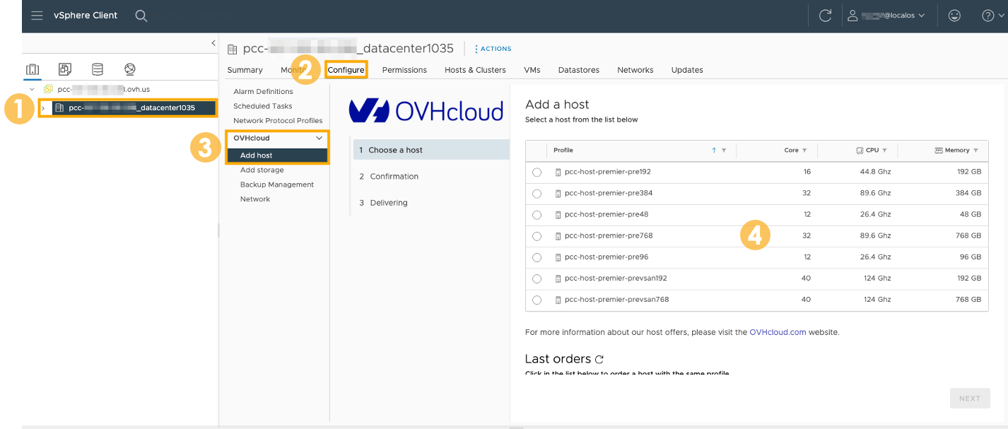

To start, log in to your vSphere Web Client. From the left-hand menu:
- Click the arrow next to your PCC name and then select the datacenter on which you wish to add a host.
- Click the
Configure
tab. - Click
Add host
under the OVHcloud heading. - Choose the host you wish to add and then click
Next
. On the following page, confirm the details are correct and pressNext
again.
If you already have a host with the specifications that you desire, you can quickly order more of that host. To do so, on the Navigator panel, right-click
the host
with the configurations you wish to add, select the OVHcloud
, and click More of this Host...
This will bring up an order funnel. Confirm the host and it will be delivered.

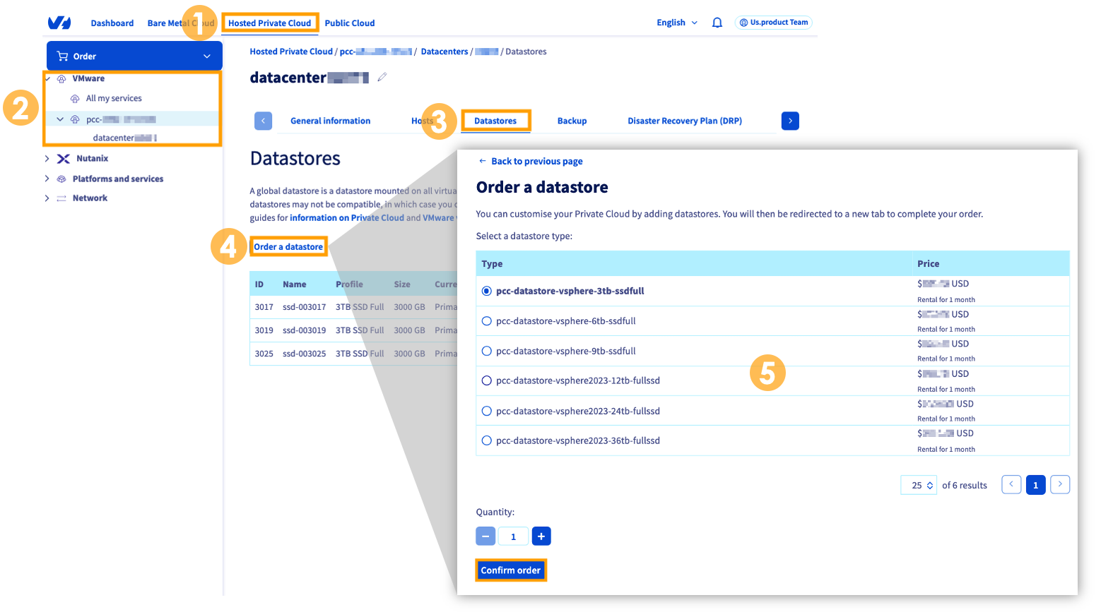

To add a datastore in the OVHcloud Control Panel:
- Select
VMware
Datastores
tab. - Click the
Order a datastore
button. - Select your type and quantity, and click
Confirm order

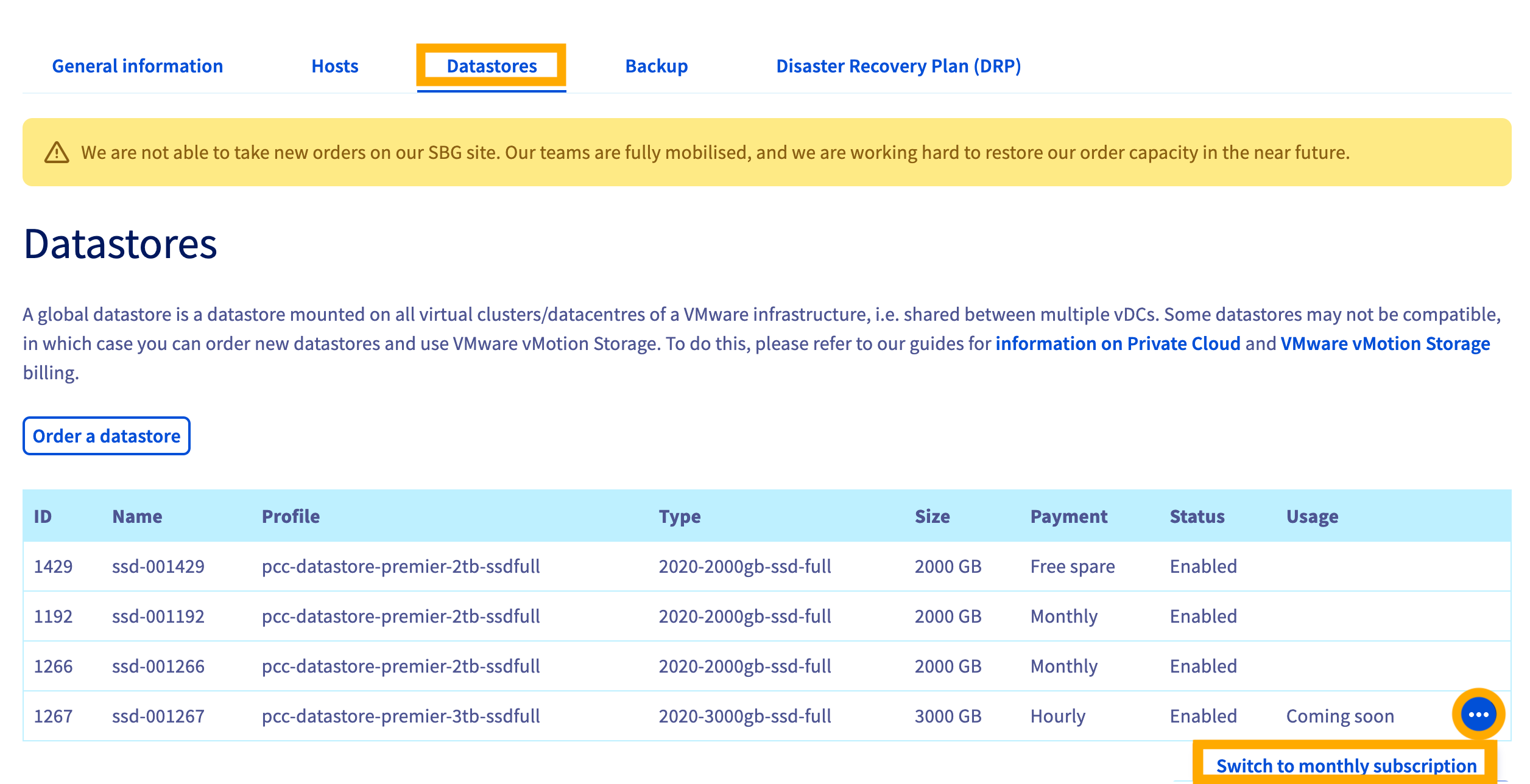

Datastores

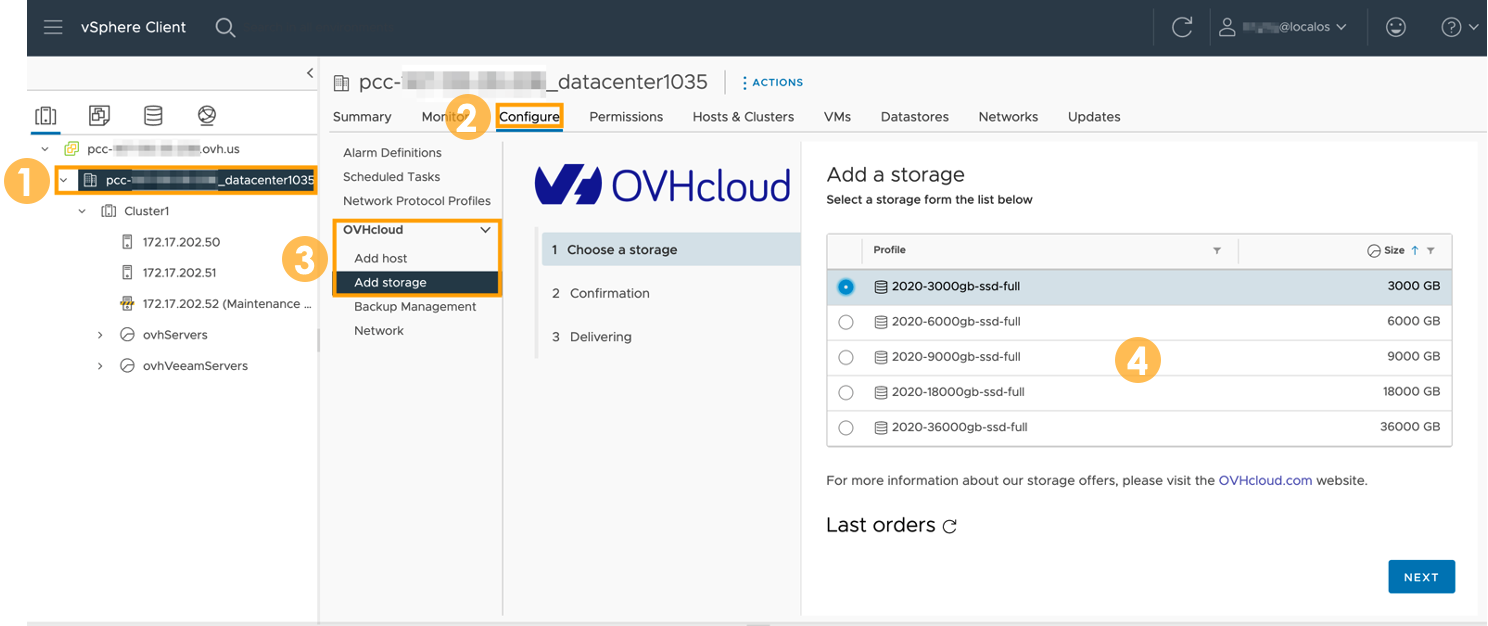

- Click the arrow next to your PCC name and then select the datacenter on which you wish to add a datastore.
- Click the
Configure
tab. - Click
Add storage
under the OVHcloud heading. - Choose the datastore you wish to add and then click
Next
again.

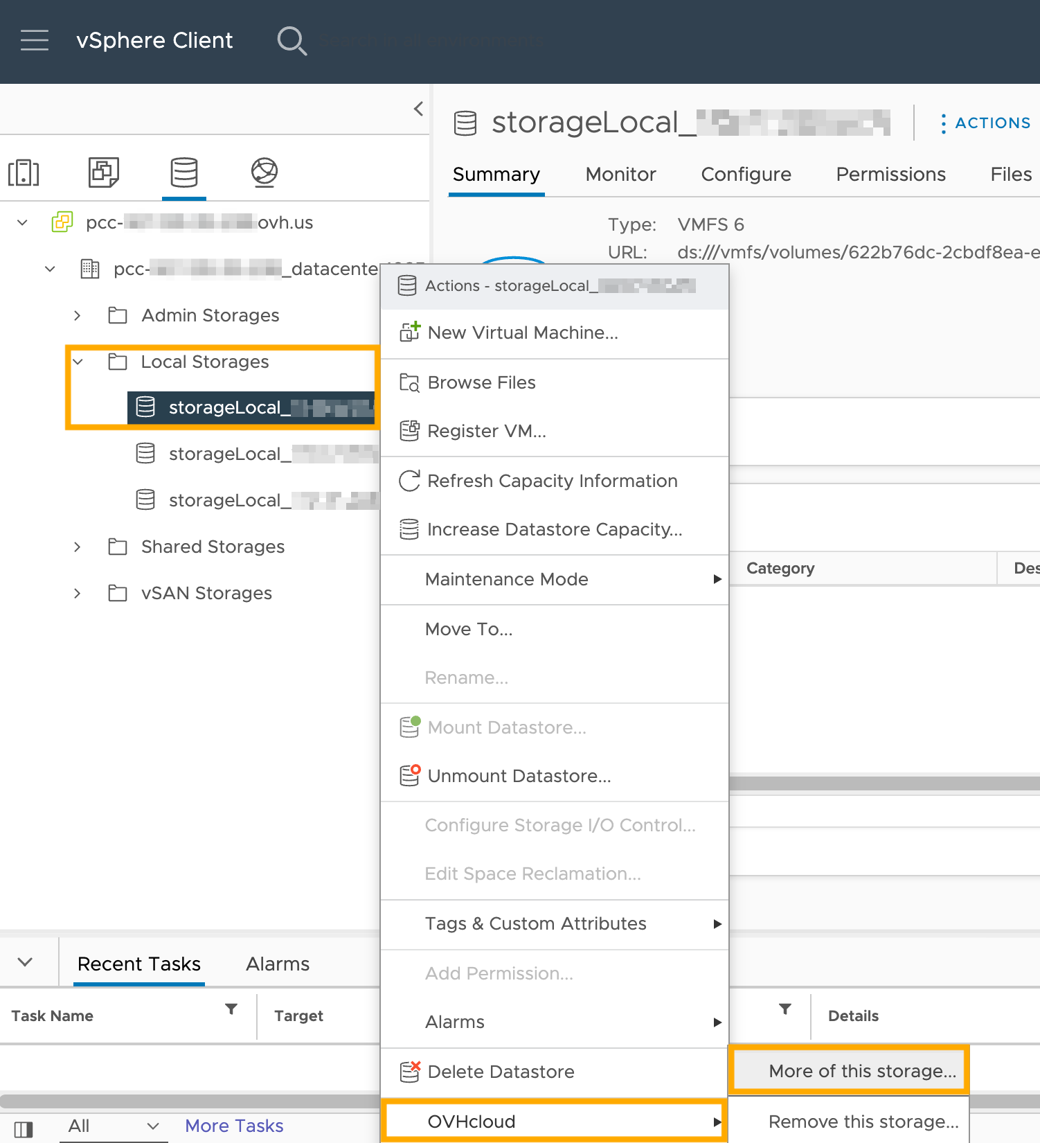

If you already have a datastore with the storage specifications that you desire, you can quickly order more of that datastore. To do so, select the storage icon on the left-hand sidebar, right-click the datastore
you wish to add more of, select OVHcloud
, and click More of this storage...
This will bring up an order funnel. Confirm the datastore and it will be delivered.

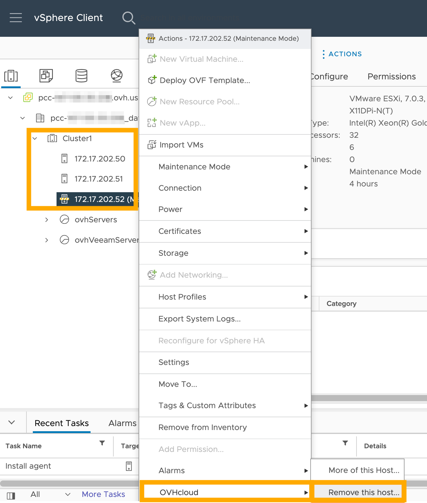

Removing a Host

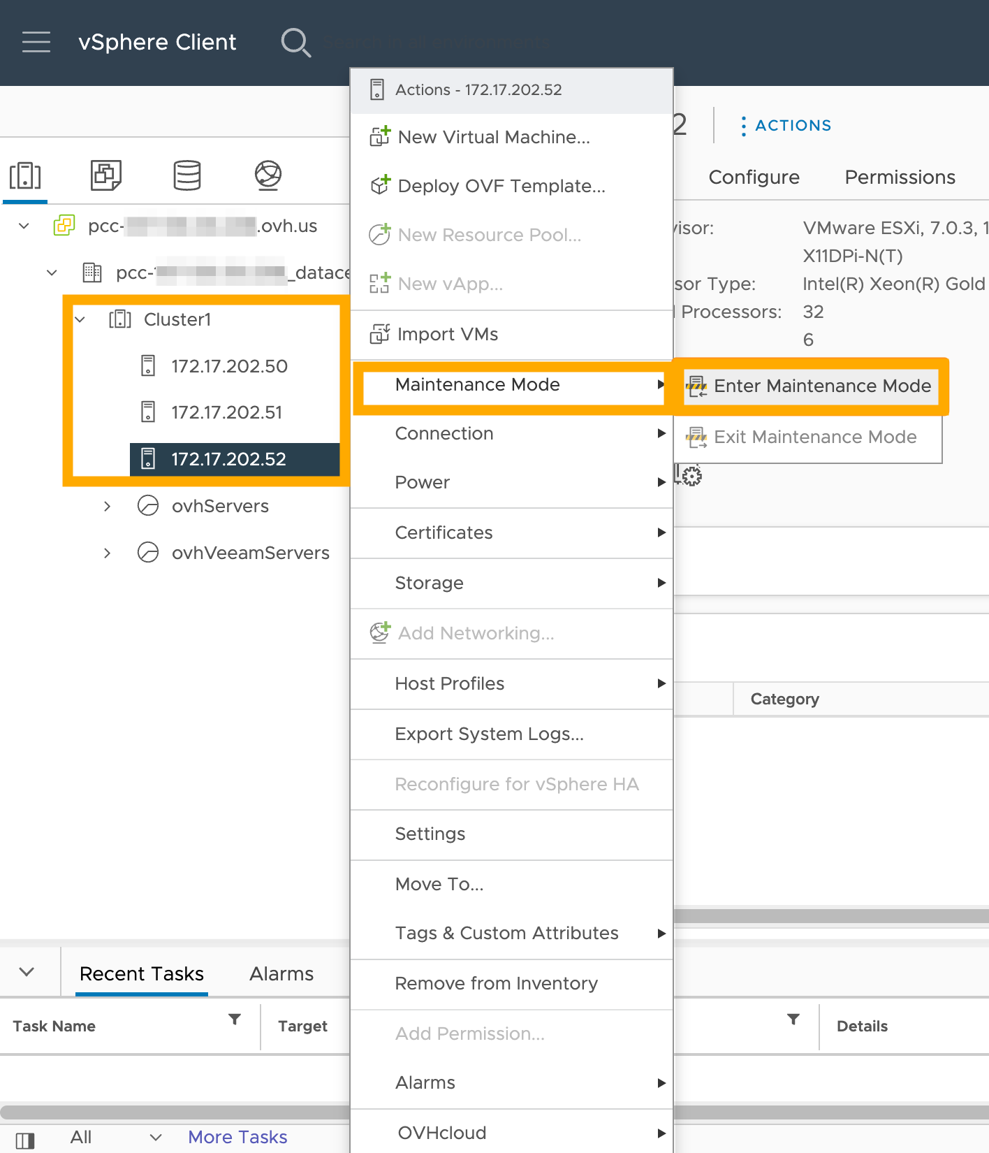

On the Host and Clusters screen, right-click the host
you would like to remove. Choose Maintenance Mode
and select Enter
Maintenance Mode

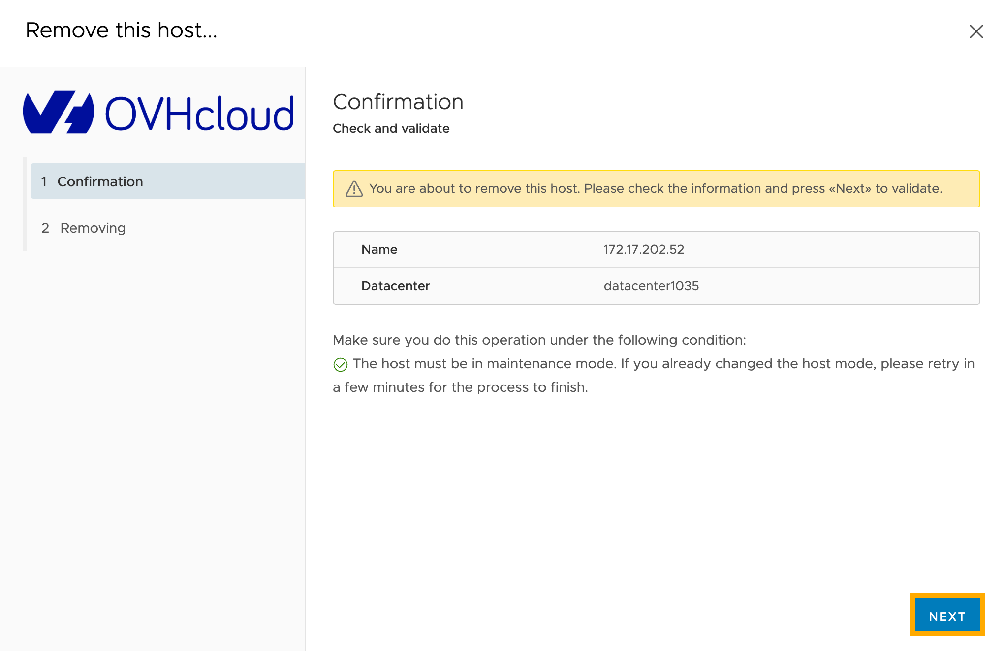

Once in maintenance mode, right-click the host
again, choose OVHcloud
, and select Remove this host...
Once the task is completed, you will see a confirmation page. Confirm that this is indeed the host you wish to remove and click NEXT
to remove it.

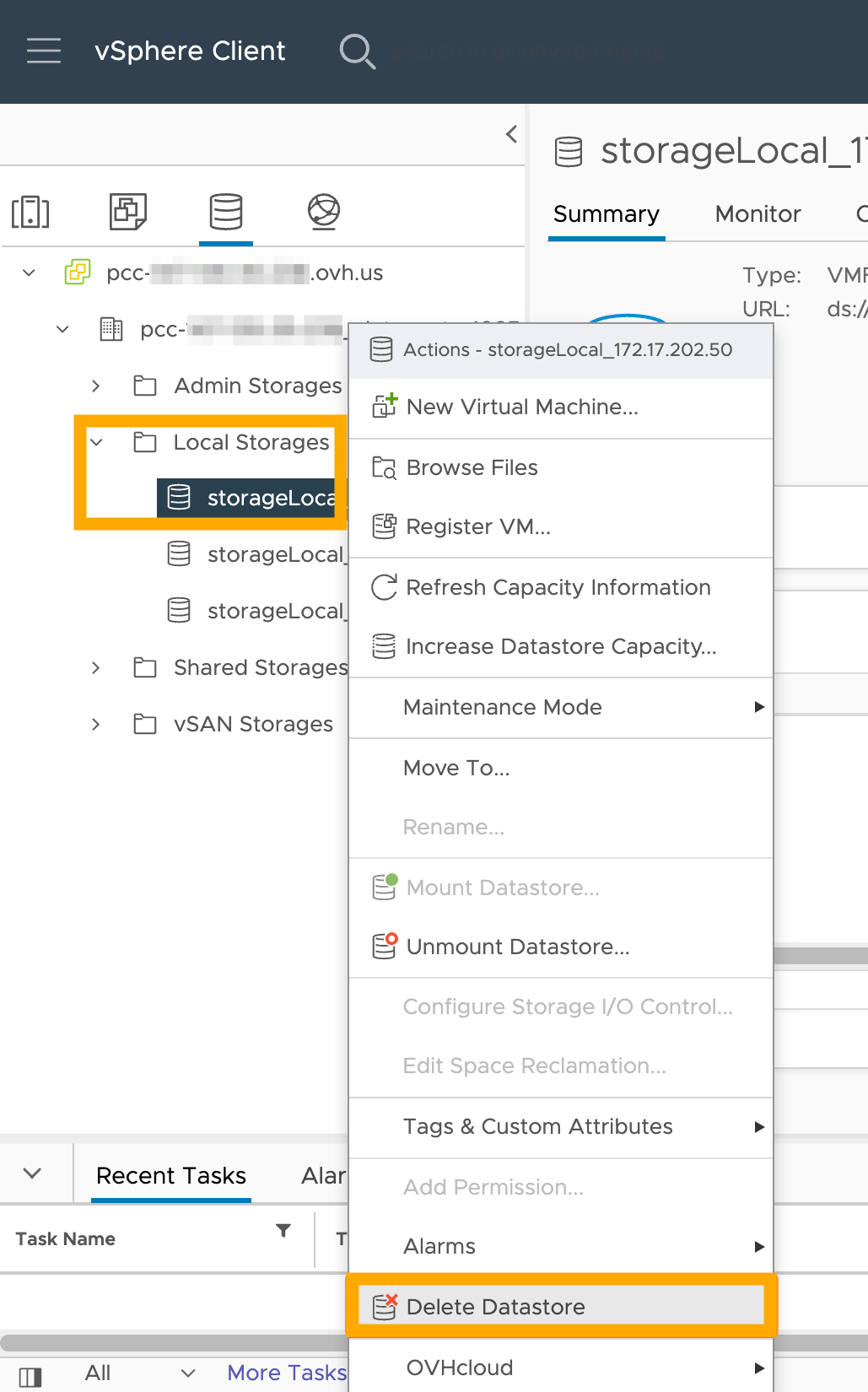

Removing a Datastore
Unmount Datastore...
when attempting to remove storage. The datastore will no longer be accessible in your HPC environment but will still appear in your OVHcloud Control Panel and will still be billed.To remove a datastore, navigate to the Datastores
tab. Next, right-click
the datastore
you would like to remove and click Delete Datastore
On the pop-up window, confirm that the datastore has no VMs attached to it and select the NEXT
button. Your datastore will be removed in a few moments.
