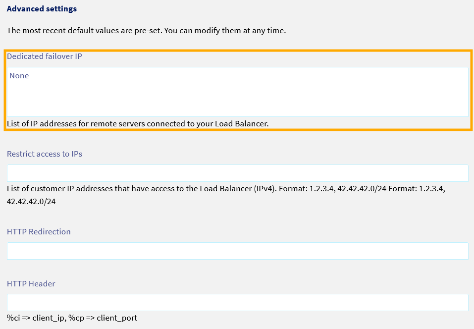

You can define dedicated Additional IPs via the OVHcloud Control Panel by going to the Bare Metal Cloud
section, then Load Balancer
Once you have selected the Load Balancer you want to modify, create a new front-end, or edit an existing one.
In Advanced settings
, you can select the Additional IPs you would like to add to your front-end.
Once the front-end has been configured, click Add
or Modify
, depending on whether you are configuring a new or existing front-end.
Please remember to deploy the configuration. There are two ways of doing this:
via the
Status
section of the OVHcloud Control Panel, by clicking on your Load Balancer’s more options...
button, then selectingApply configuration
via the reminder box in the OVHcloud Control Panel, notifying you that the configuration has not been applied, by clicking
Apply configuration
