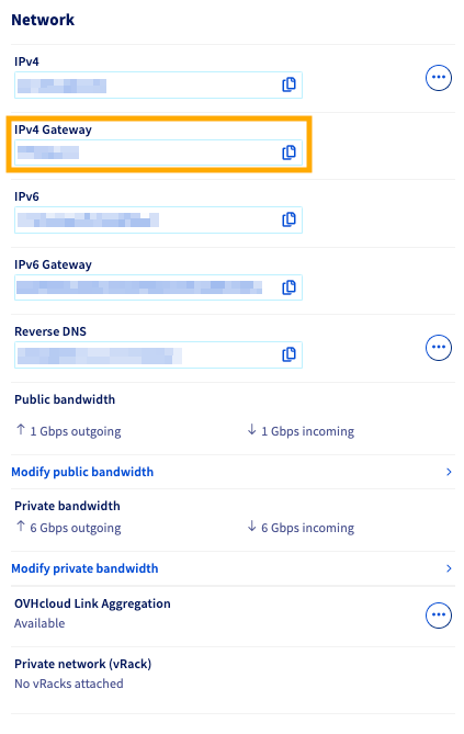

To configure your virtual machines for internet access, you will need to know the gateway of your host machine (i.e., your dedicated server). You can retrieve the gateway via the OVHcloud Control Panel or the OVHcloud API.
Via the OVHcloud Control Panel
Log in to the OVHcloud Control Panel, go to the Bare Metal Cloud section, and select your server in the Dedicated Servers section.
The IPv4 gateway assigned to your server will appear in the Network section of the General Information tab. Once you have copied it, continue with applying the configuration.

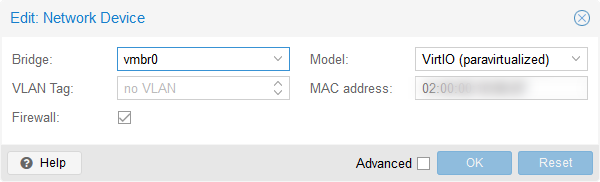

Proxmox

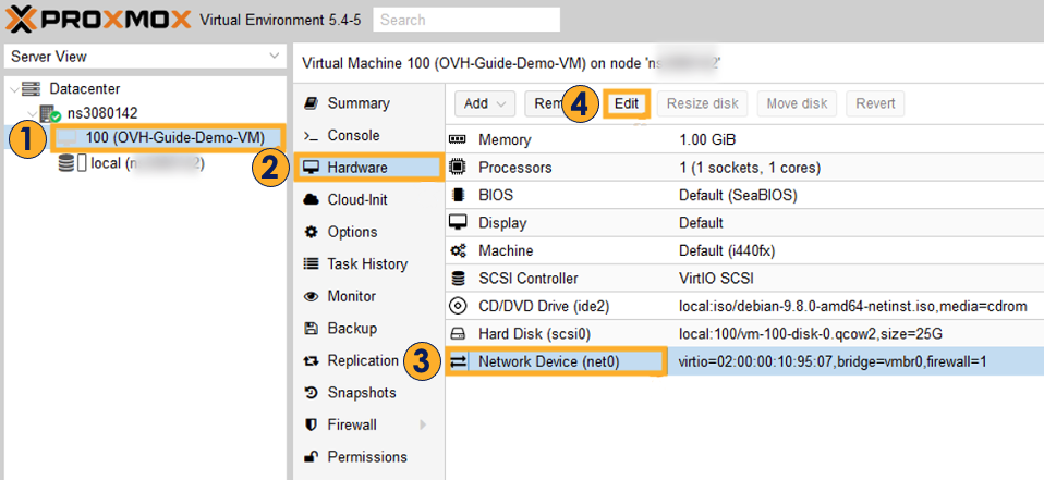

After creating the VM and while it is still powered off, right-click the VM and click Edit settings.
- Select the VM.
- Open the
Hardwaresection. - Select
Network Device. - Click the
Editbutton.
Then, add the vMAC address created previously.
Now, you can start the VM and proceed with the configuration steps, depending on the operating system installed.

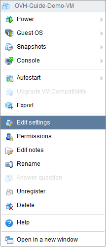

VMware ESXi

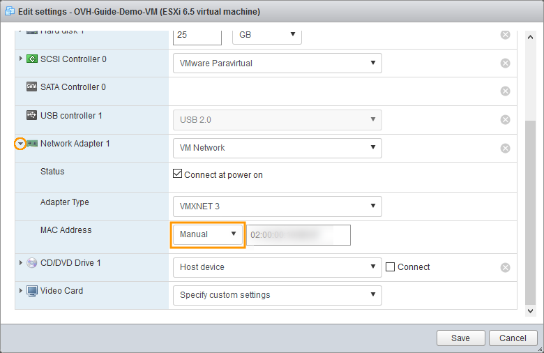

Fold out Network Adapter 1, change the value in the MAC Address drop-down menu to Manual, and enter the MAC address created previously.

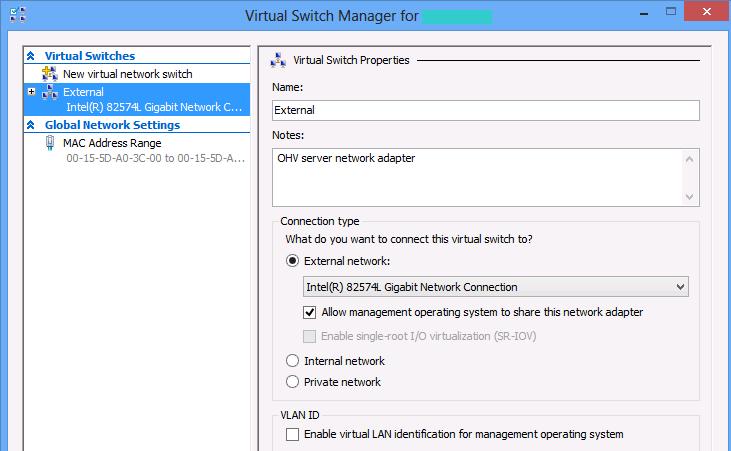

Before configuring your virtual machine, you need to create a virtual switch.
From the command line of your dedicated server, run the following command and note the name of the network adapter that contains the server's main IP address.
In the Hyper-V Manager, create a new virtual switch and set the connection type to External.
Select the adapter with the server’s IP, then tick the option Allow management operating system to share this network adapter.

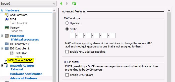

Next, select the VM to which you want to add the Additional IP. Use the Hyper-V Manager to change the settings of the VM and shut it down.
Expand the network adapter in the left-hand menu and click on Advanced Features. Change the MAC address to Static, and enter the virtual MAC address for the Additional IP. Once you have entered these settings, press OK to apply the changes.

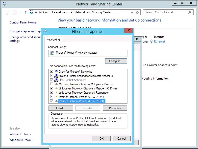

Next, start the VM and log in as an administrator, then go to the Control Panel's Network and Sharing Center. Click on Ethernet to open the settings and click on the Properties button to view the Ethernet Properties.

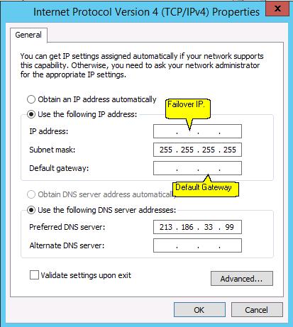

Select Internet Protocol Version 4 (TCP/IPv4), and then click on the Properties button.
In the IPv4 Properties window, select Use the following IP address. Enter the Additional IP into the IP address field, and enter 255.255.255.255 into the subnet mask.
Fill in your server’s gateway IP address in the appropriate field below and enter 213.186.33.99 into the Preferred DNS Server field.
Finally, click OK, and ignore the warning message about the gateway IP and the assigned IP not being in the same subnet.
